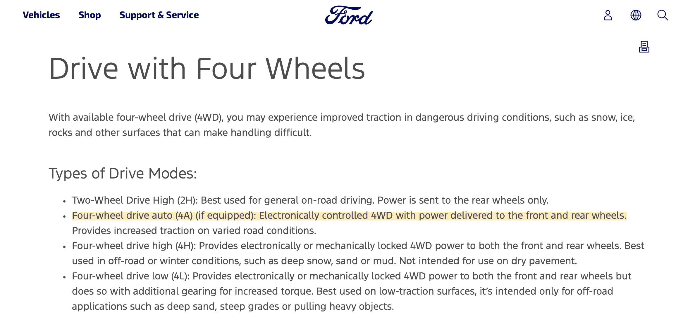

so 4H is ok on pavement as long as there is snow cover? sorry newbie here... i've always had awd no thinking required.
This is somewhat of a hot topic around here and you'll get a lot of opinions.
I'd use the exact same document that @omi205 posts and say that it does point out 4H is ok as long as you aren't on dry pavement.

4H and 4L should only be used when needed. They are not normal driving "all time on" modes as they are locked. 4A is not locked and can be a "all time on" mode when conditions call for it.
The big considerations with 4H/L is that they are locked and there are speed restrictions you should not exceed. These two are truly intended for off road use. You do not want to have these on while driving around town or even where there is rain and good grip. I would even say snow with pavement (where the tires can get through) is also not a good use for these. Your tires should be slipping when you use 4H/L. That is the main point.
4A is different in the sense that there is no locking mechanism. Meaning the tires on each end can rotate at different speeds. In addition the same speed restrictions do not apply. You can put the Bronco in 4A and drive it like normal. Heavey rain. Light snow. Would be fine. All conditions where you have perfect traction is 2H (Always).
