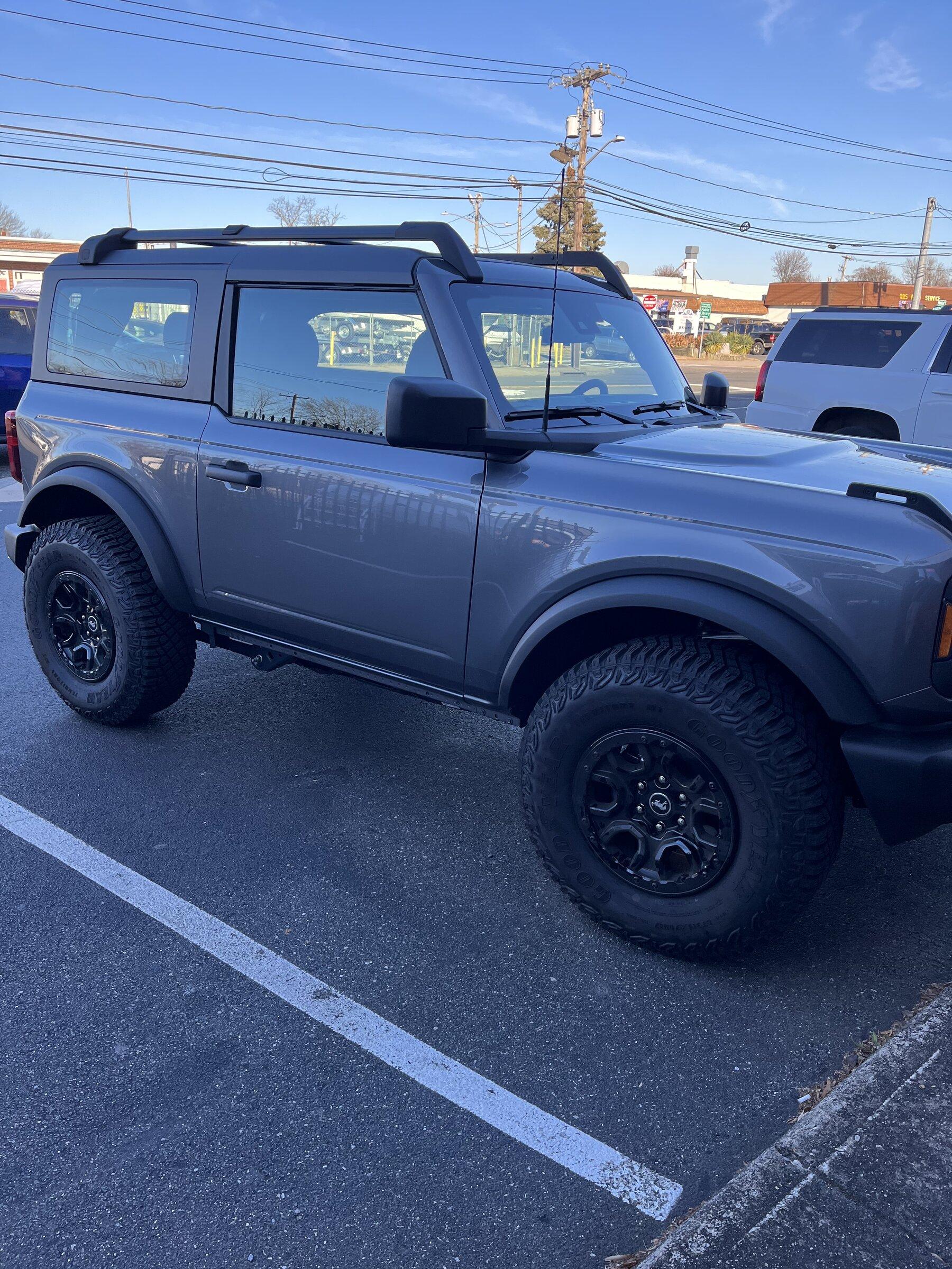

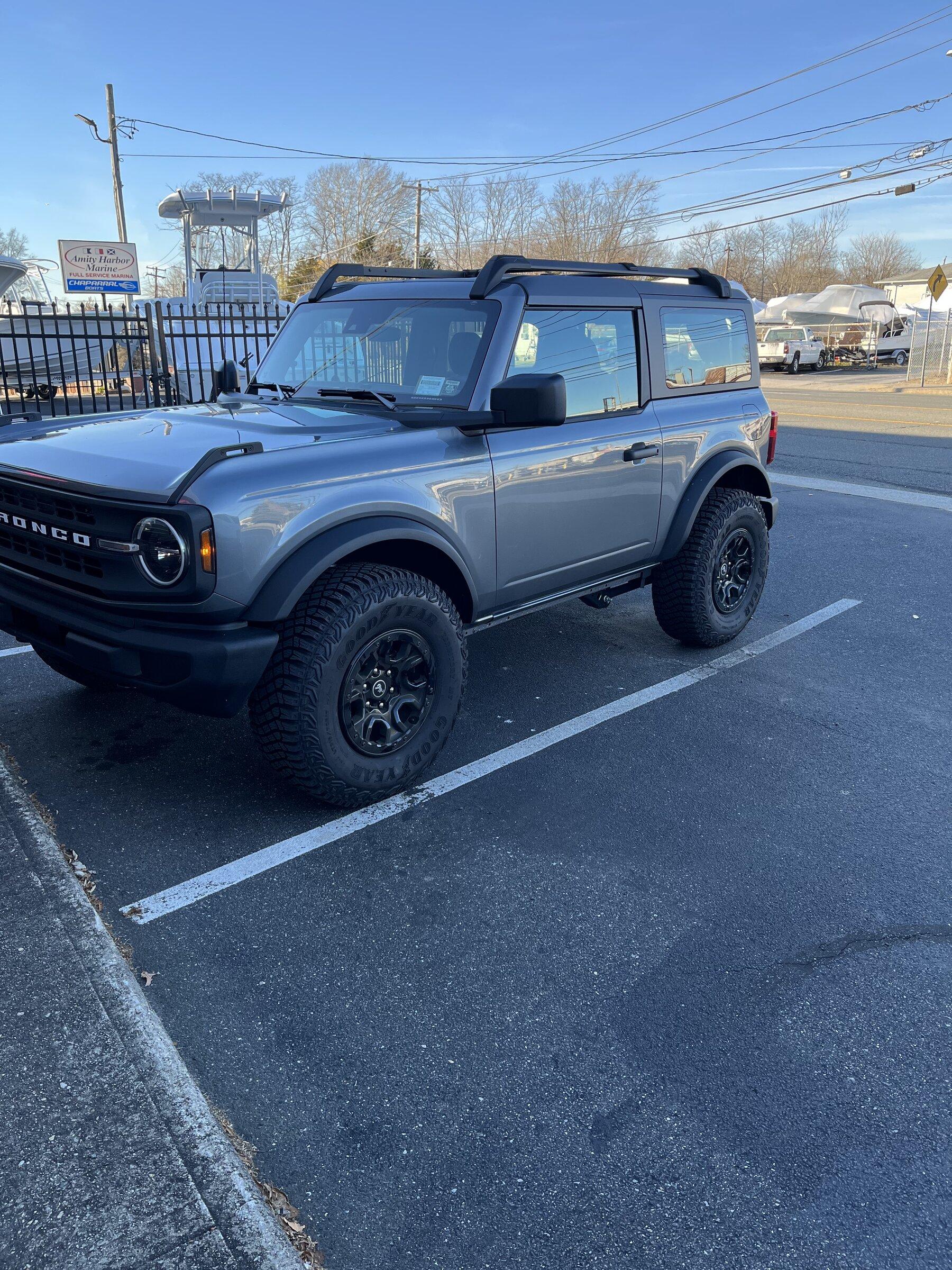

Got it done today! It was cake!! Decided not to go with the wheel spacers though the poke was a bit too much for what I wanted. Crash bars removed zero rub lock to lock. Drove it 50 miles home with 0 issues.
They look great! And that’s really encouraging!315/70/17 right? Did you lift it at all?

Nope no lift, no rub, drove backroads home yesterday ~50mile trek and no issues with rubbing or anything.
2.3L / 3.73 rear end 10spd auto.

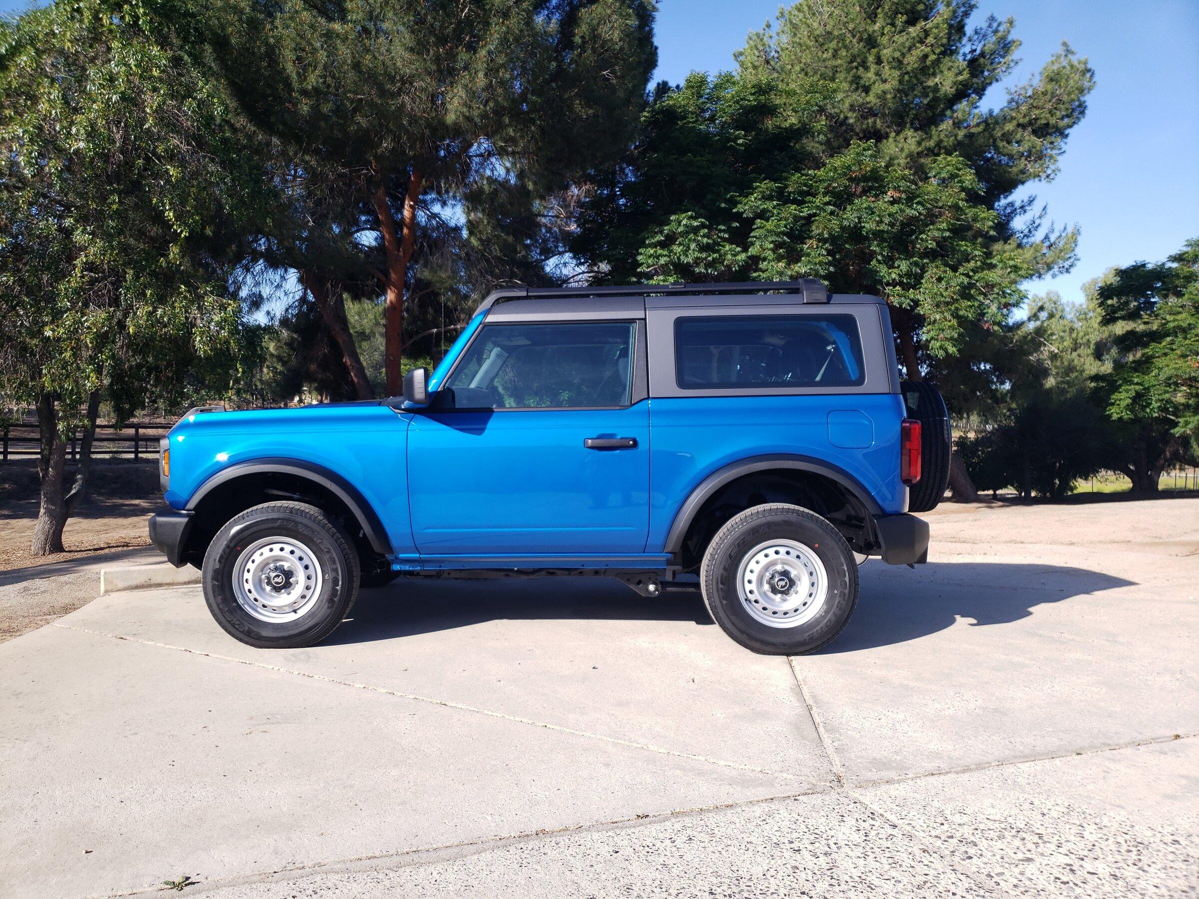

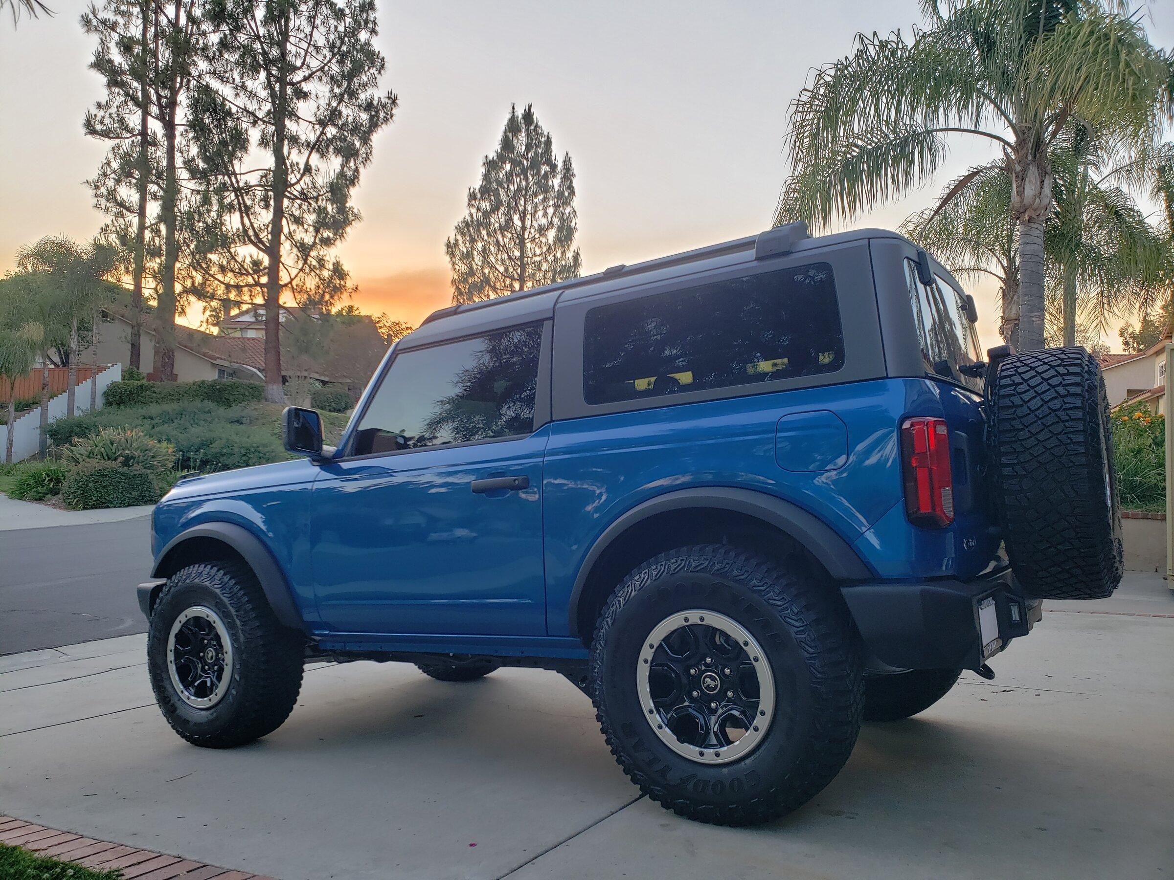

Just Got my Base Bronco and took off the steelies and found some 35" wheels locally. As @Demosouthpaw said...no rub or anything w/o a lift. I did remove the crash bars up front.

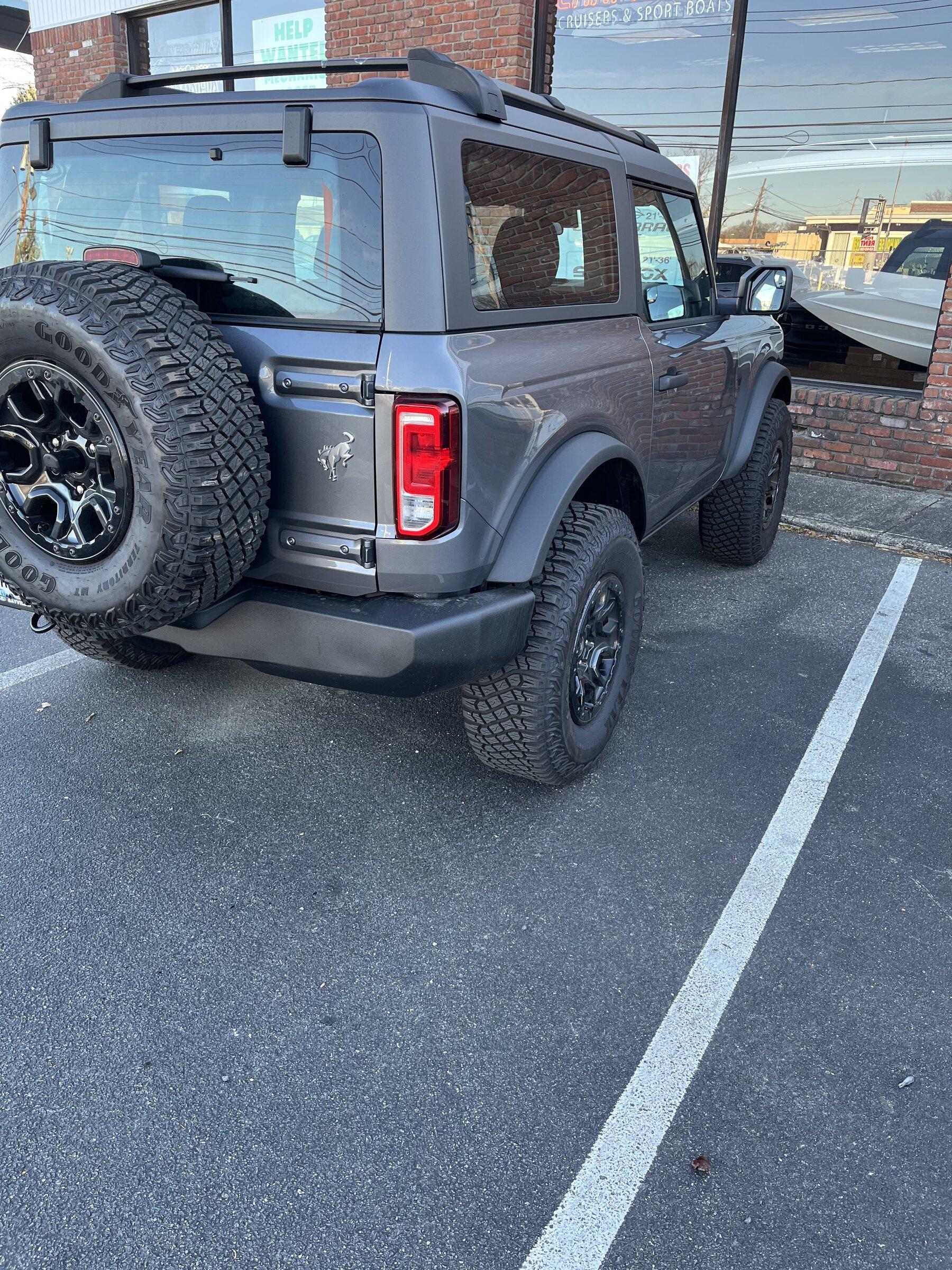

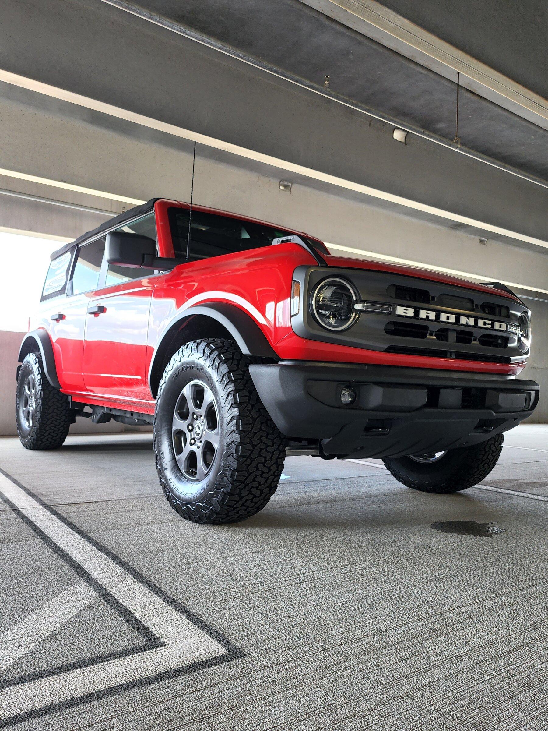

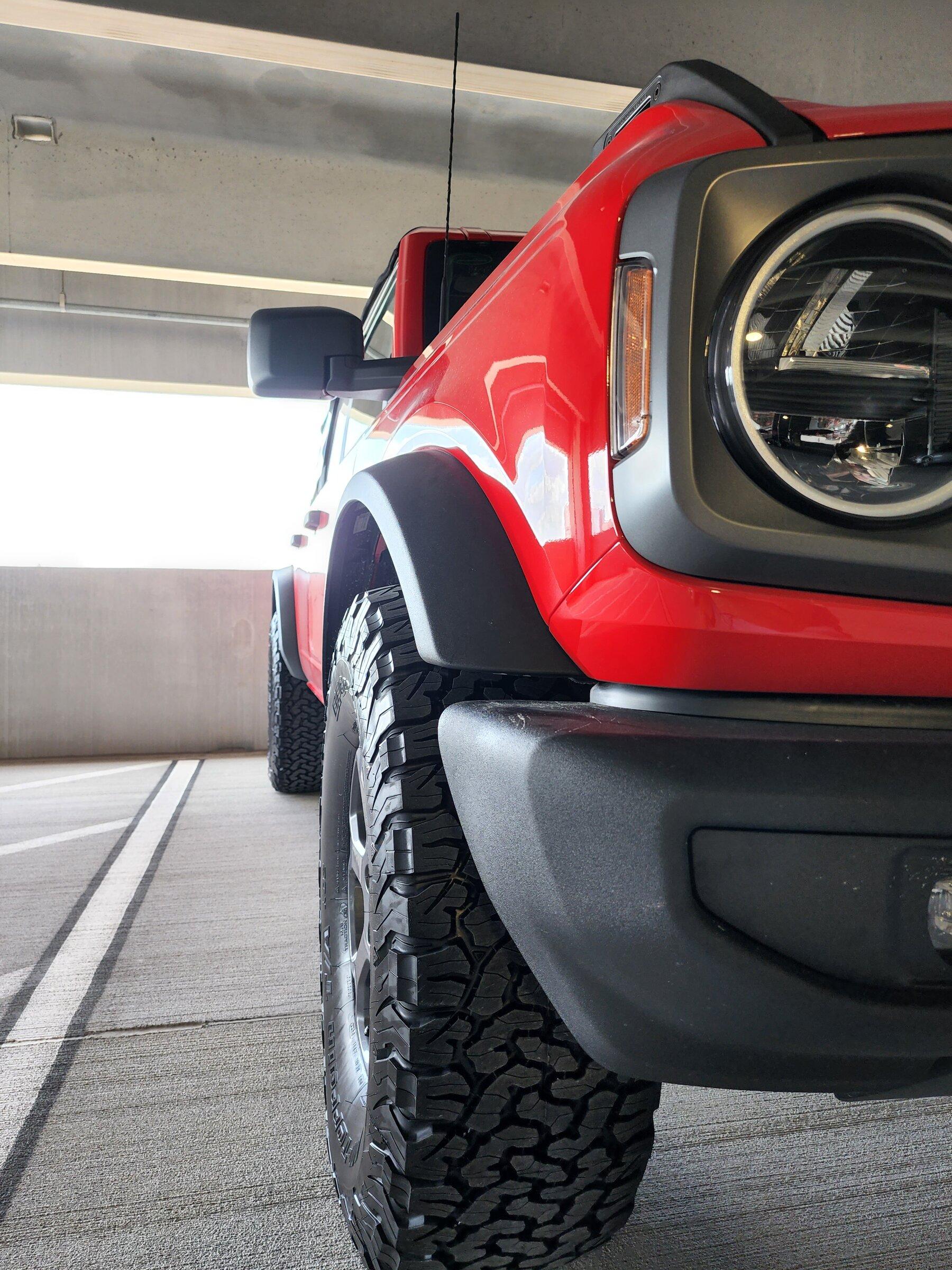

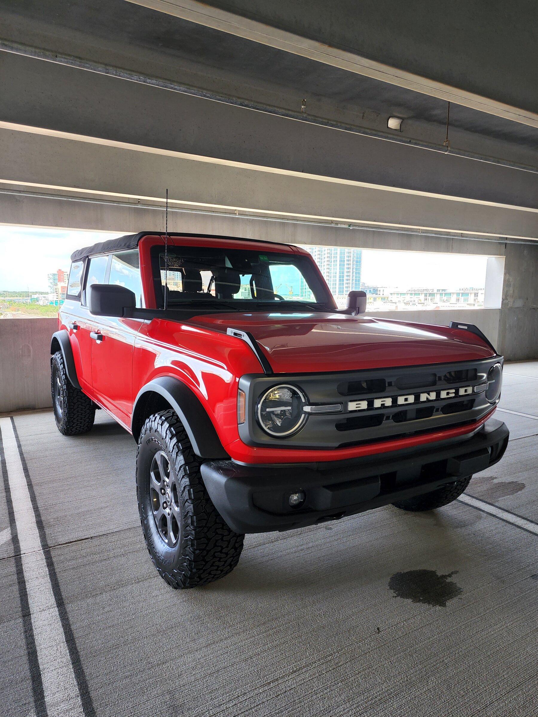

Here is my base with wildtrack sas takeoffs no lift and only removed the crash bars. Also 2.3 with auto. Runs perfect no issues. Speedo is off but I don’t care
the carbonized gray and black wheels look soo good! I have a 4Door WT in the same color and my son has the 2 door blue. All you need is some tint. Looking good!
