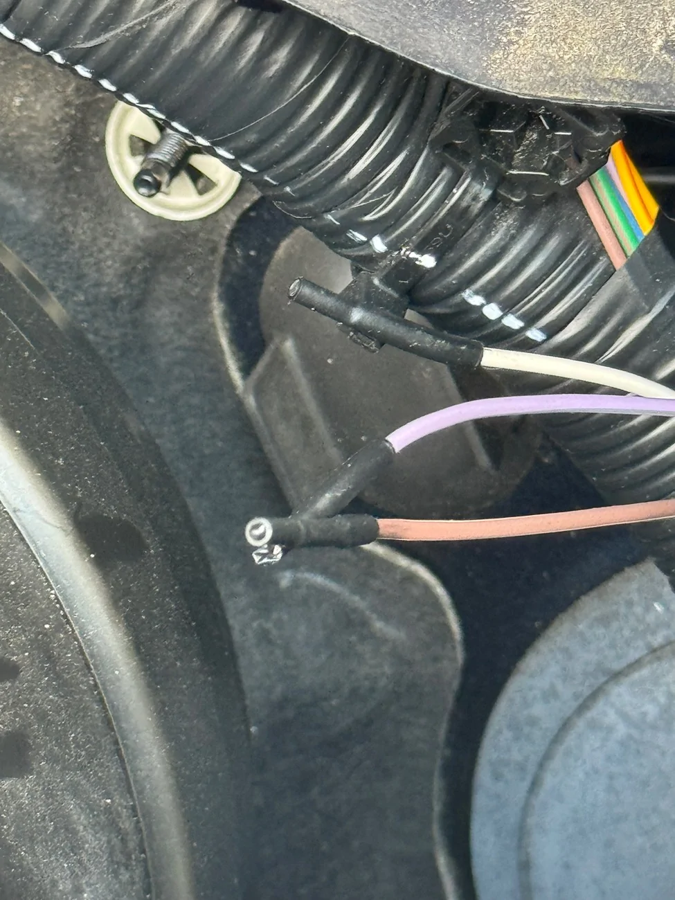

I have an Outer Banks without the Aux Seitches. There is a white, brown, and purple wire under the hood in front of the driver’s compartment. Does anyone know what these are for? Thanks

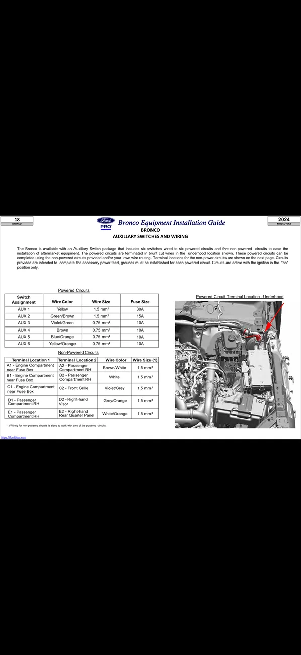

It’s for the auxiliary switches. They’re on all the harnesses regardless of options.

Is it possible to add the bank of switches and assuming that it’s just a plug and wire harness will they work?
helifino16
Ron
Aug 12, 2021
2,955
5,103
Mount Sinai, NY (Long Island)
You'll need a new Fuse Box as well.
