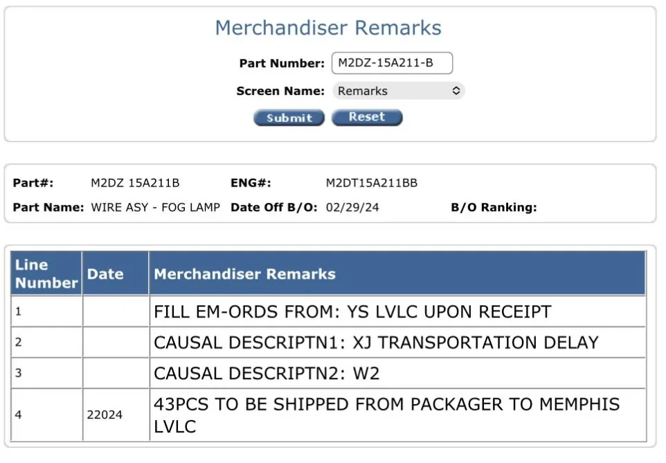

It’s on backorder.
43 pieces shipped the other day to Memphis PDC, so it shouldn’t take very long to get one.

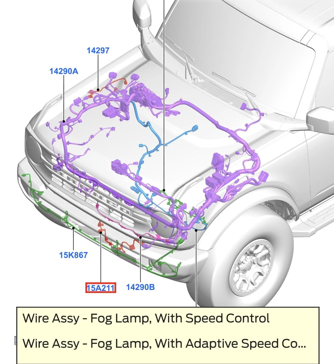

The fog lamp wiring assembly is the right part for the Adaptive cruise harness?
Ducati1098
10,062
23,449
Midwest
Thanks for that information and the reply.
I think the description is just inaccurate. The red harness in this picture is for the adaptive cruise control module, which is the part number I posted.

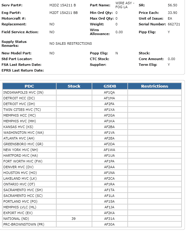

Almost a month later and they are still telling me its backordered. I'm beginning to lose my mind.
Ducati1098
10,062
23,449
Midwest
There are 39 currently available at the national PDC, so I'm not sure why they're telling you that. Unless they're talking about a completely different harness?
