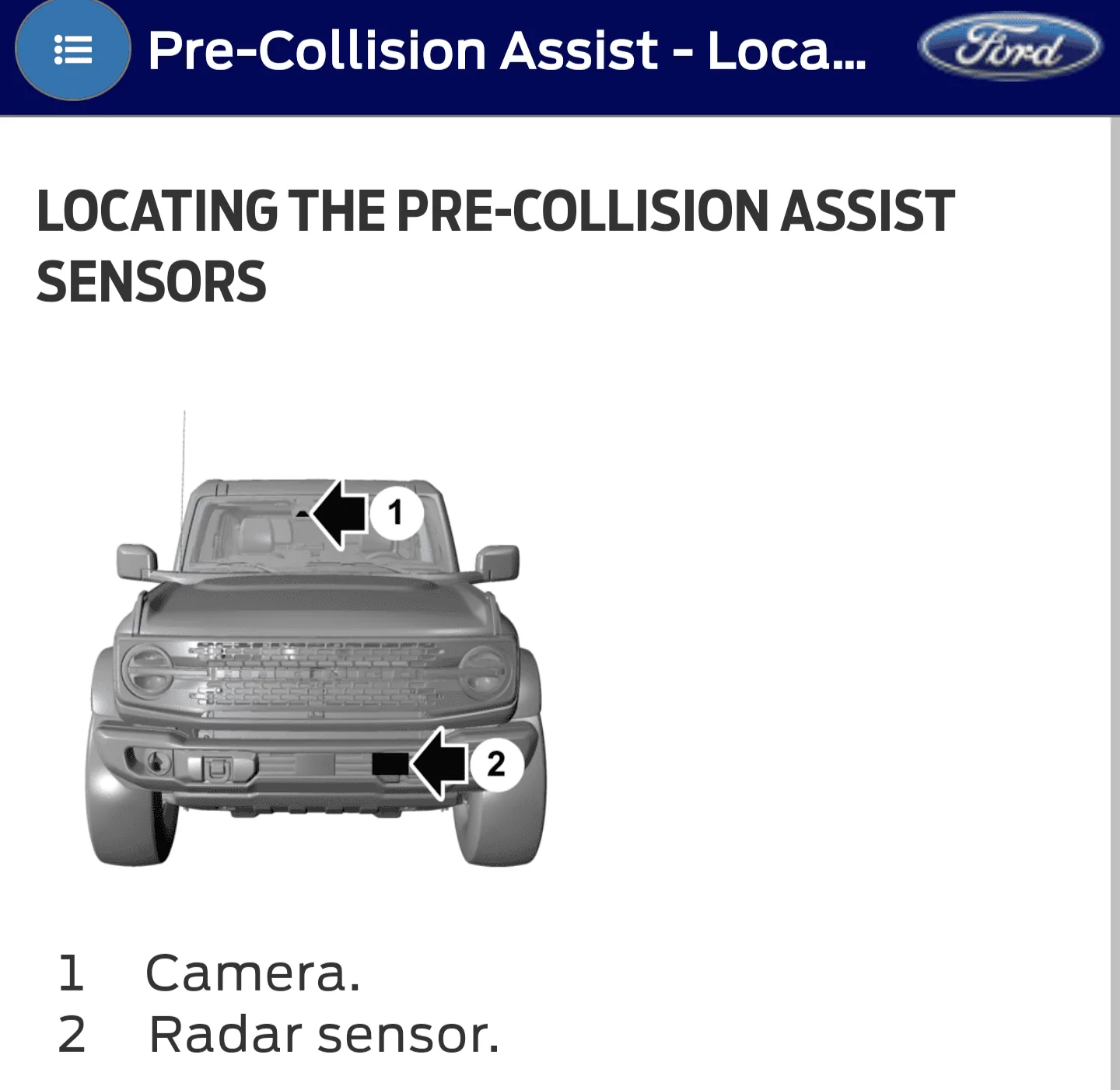

Have you checked the radar sensor below the grill? Believe it's driver's side bumper on the Outer Banks. Could be a big bug splattered on there. In addition to bugs, fog has also given me issues.
Ford Bronco Pre-Collison Assist not available under specific circumstances PXL_20221007_173926482

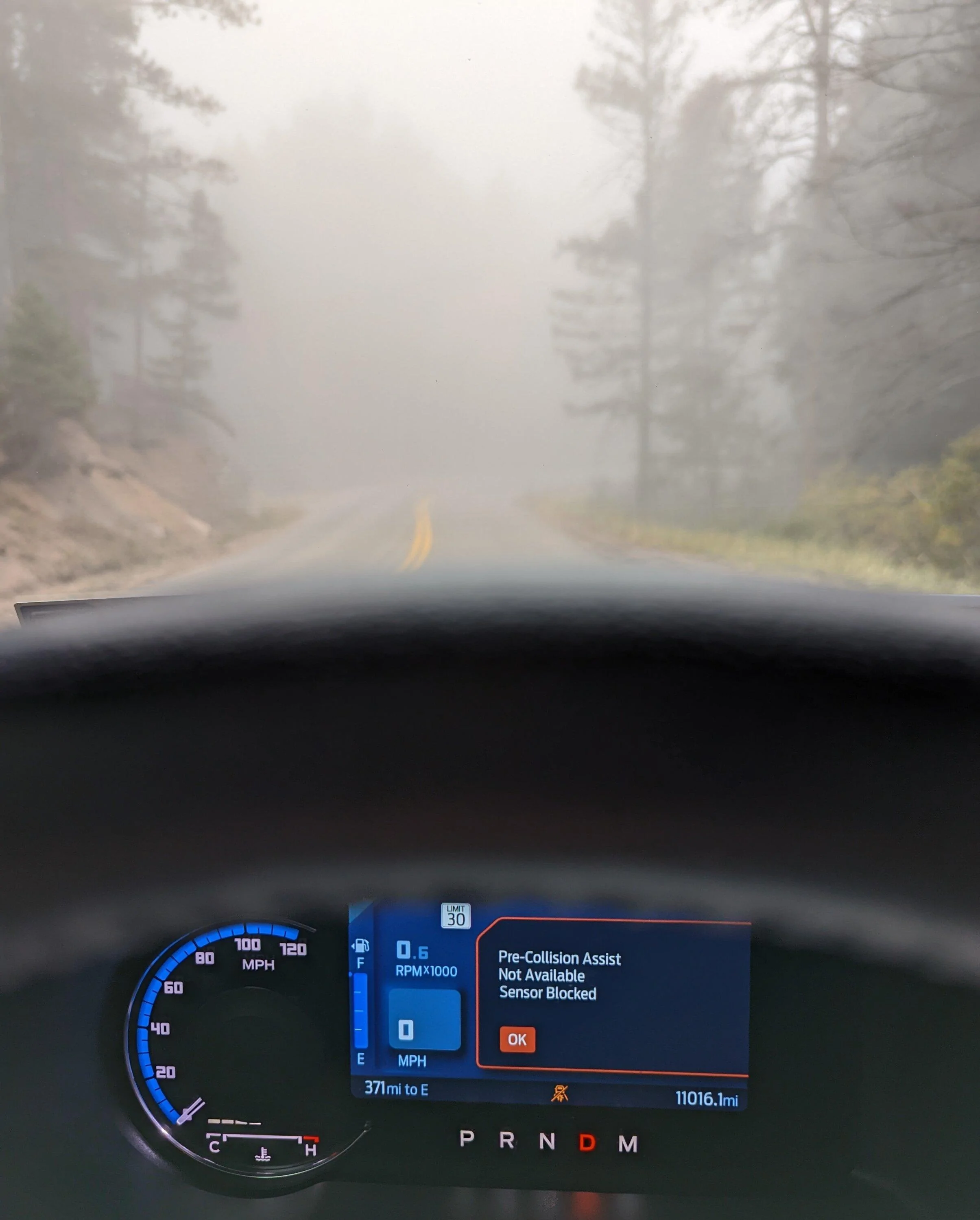

Clean your windshield.
Also, I've had the error a couple times driving straight into the sun and once in heavy fog at night.
