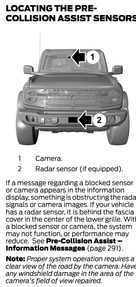

your base uses the windshield mounted camera since there's empty space in the square radar unit (unless you have ACC)

Your base does not have a radar. AEB uses the camera up in the rear view mirror. The tech works, but not in every possible situation.

In the case of the Bronco, ACC cars have radar, cars without have a camera in the rear view mirror housing (I have a low package badlands, I've received a message about the camera being obscured by snow/ice in the winter)
I have the most basic Base Bronco. It has the square black plastic case (item 2 in the diagram). Does that mean on my Bronco, it's just an empty plastic case with no radar?
