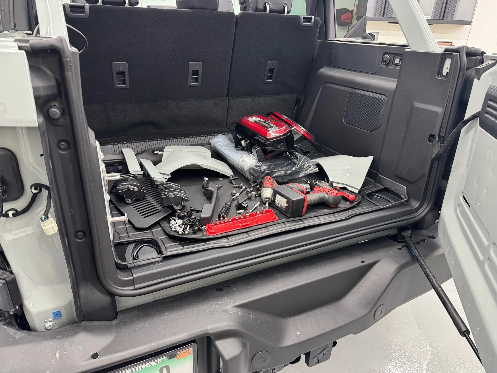

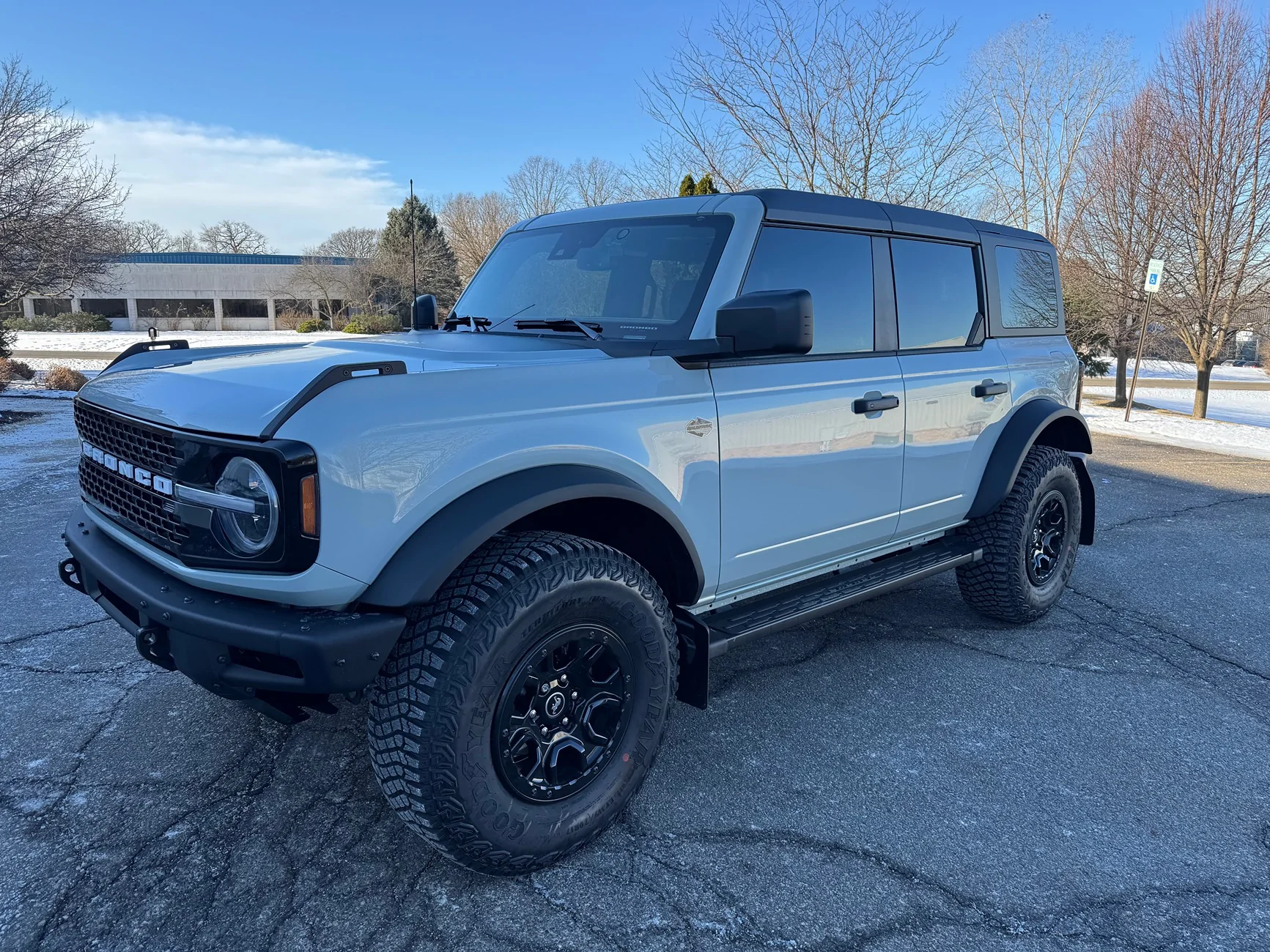

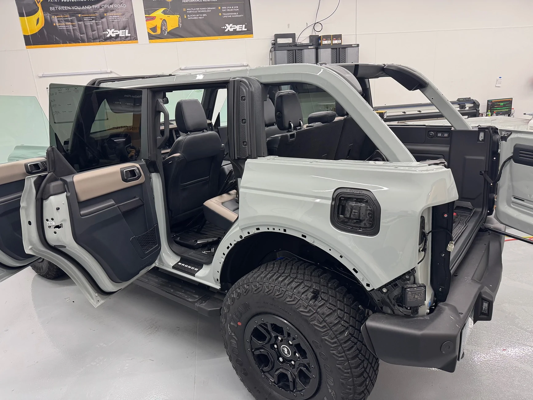

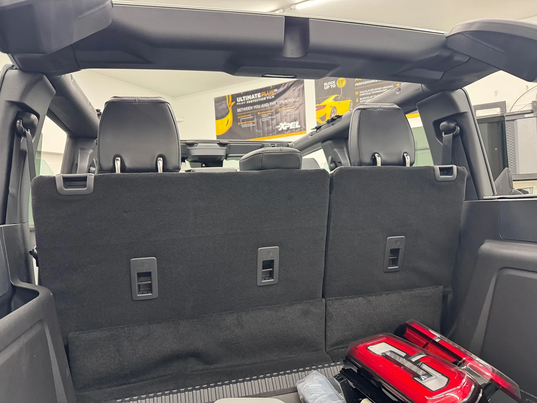

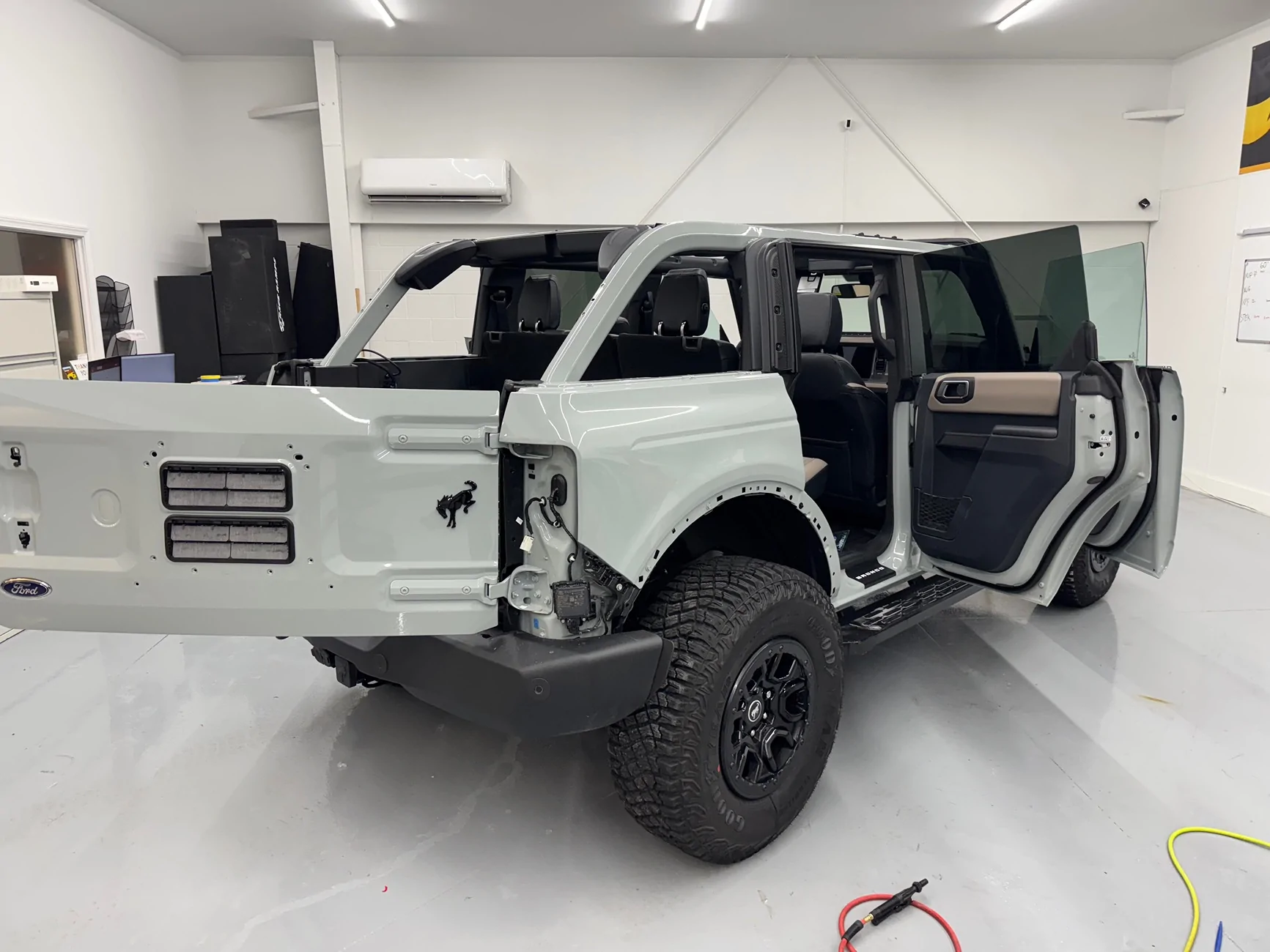

I had all the painted surfaces in my ‘24 WildTrak a year ago. Went with STEK DYNOshield.
You get what you pay for with the installation. Cheaper installations will cut the film around trim pieces, door handles and grille. The problem with that is that over time those edges will collect dirt and be even more visible and could begin peeling.
The company I work for in my retirement job removes the roof, grill, tail lights and door handles so that the edges are underneath and not visible, along with wrapping the edges around the door edges and under the hood and tailgate.
I’ll post picture of my WildTrak taken during the install.
I took my truck on some trails in Northern Michigan last summer and had limbs brushing up against it. I also during the winter have used the foam brush at those do-it-yourself cars washes, something I would never do with my other two unwrapped sports cars.
Paint looks like the. Day it left the dealership. No scratches or stone chips. Even had the windshield film applied.
I don’t know about the other films, but STEK’s has ceramic impregnated into the film which helps it repel dirt.
Comes with a 10-year warranty.
I would do it again in a heartbeat.

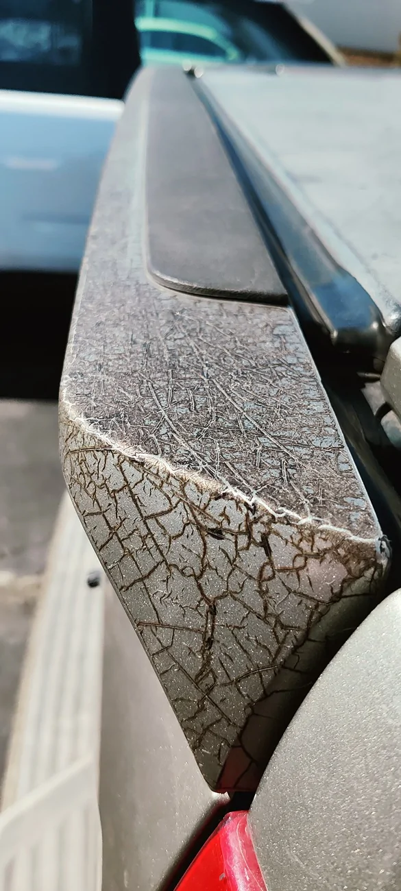

Just remember, it doesn't last forever. My 03 Caddy EXT had 3M PPF done when it was new and now the film has browned & completely cracked. It will be a nightmare getting it off without ruining the paint below. My only hope is that the latest xpel film is better than the stuff used back then, and I did do ceramic on top of the PPF for my Bronco & GX.
