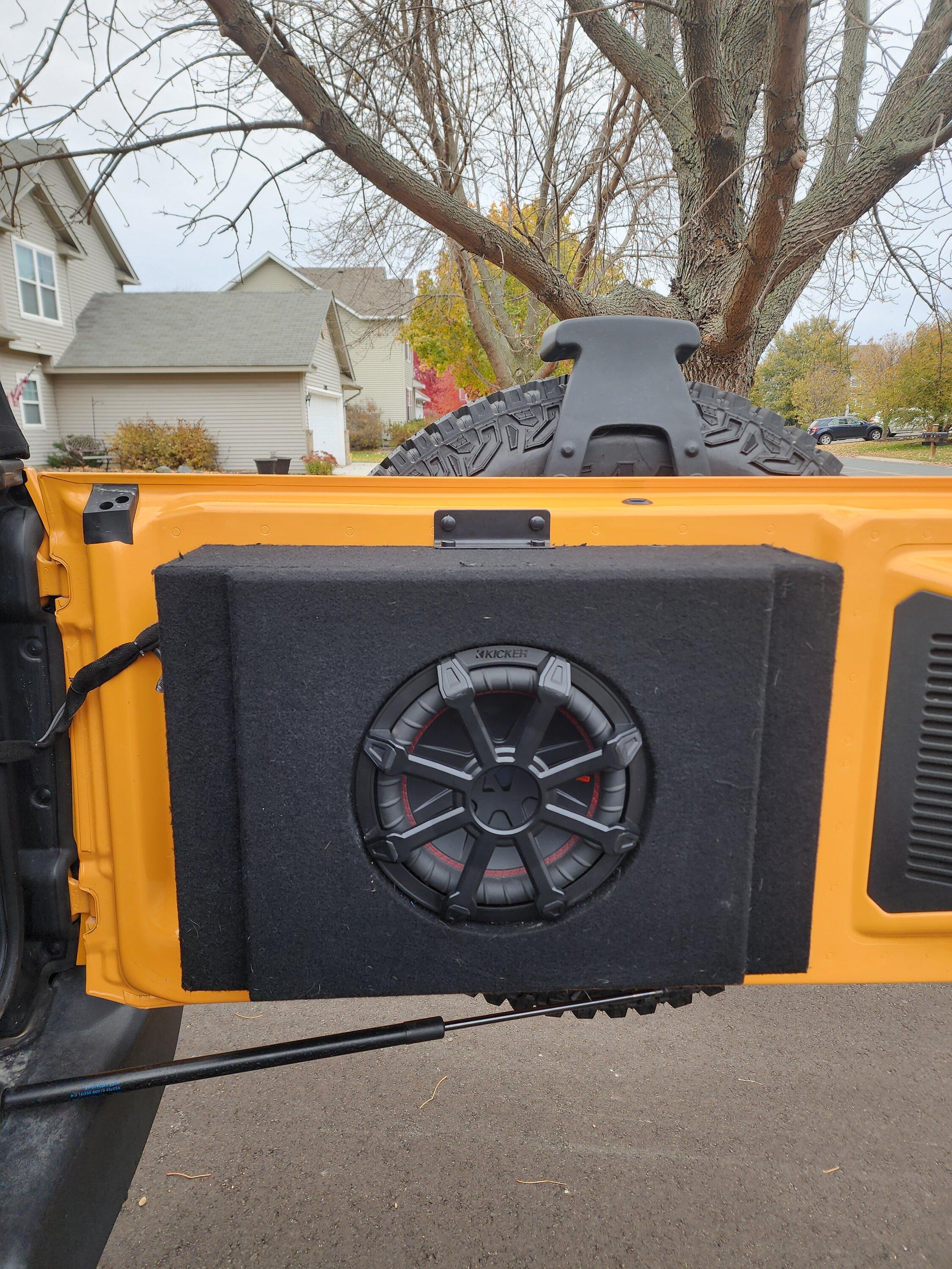

Ford Bronco Possible to remove the rear tailgate door completely? E305D6B1-F3BA-4BEC-B1F1-5BBF6DA8113C
But I would lose my sub 😧
Lifeliberty
Moonbeam👀
Aug 12, 2020
2,910
5,513
Columbus, OH
Is not hard at all. I had it off when installing my tailgate reinforcement... by mistake.
It's really only attached by the 4 hinge bolts, wiring harness, and the tailgate strut. Without the rear tire on it's like 30 lb
You will lose the reverse camera, spare tire, and third brake light.
I don't know if running without the wiring hooked up will throw codes.
Alignment would be my concern with reattach

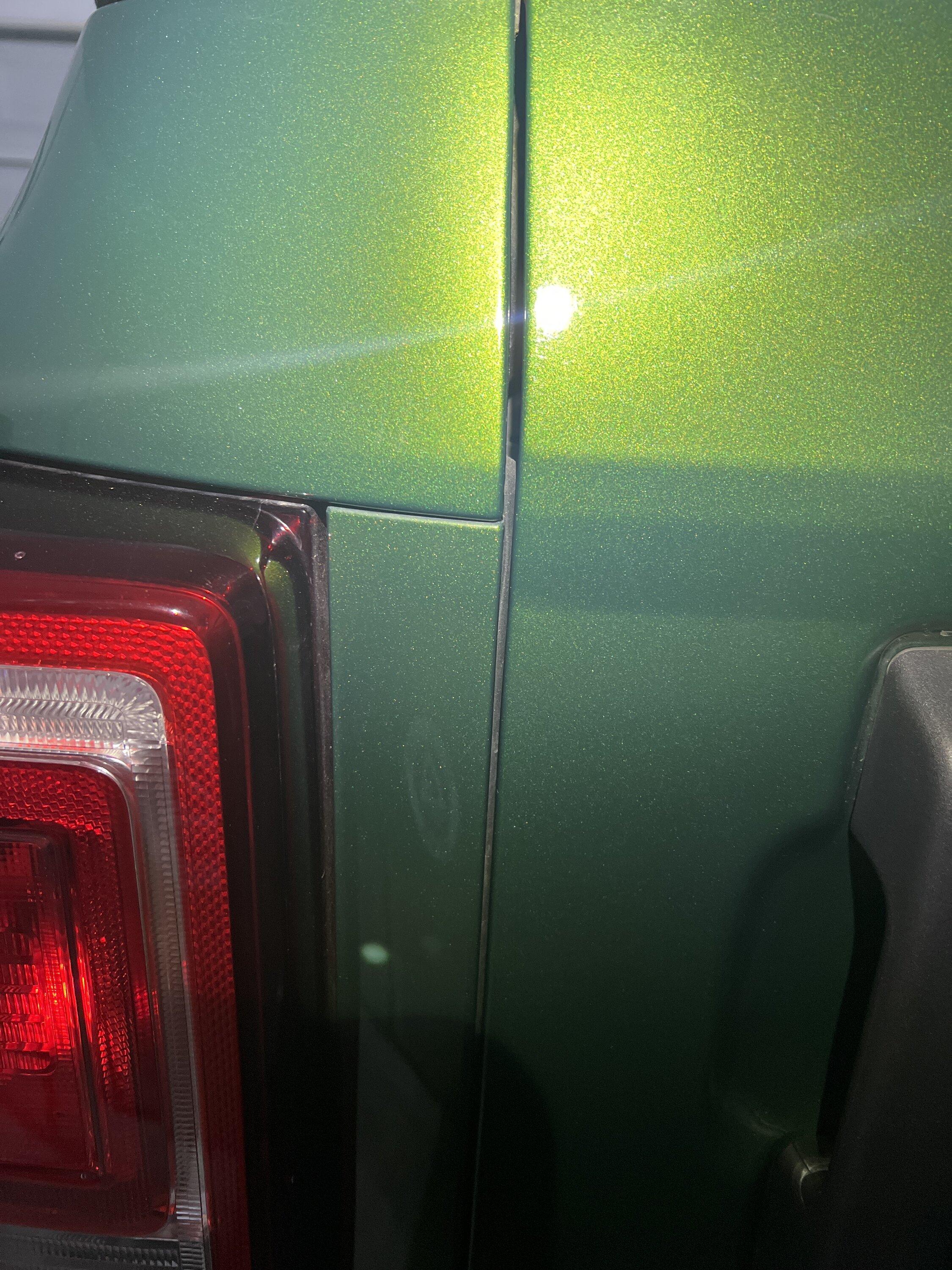

Does anyone know if it's possible to remove the rear tailgate door completely? I know that its possible but how hard is it? the hinges look a bit complicated, would anyone care to share how its done? thanks
I took my tailgate off putting it back on was easy. The only thing is my gate is up by half an inch or so I’m just wondering if I can put the tire back on . I have the RC tailgate reinforcement it doesn’t make noise so I’m assuming it’s ok to put the tire back on
