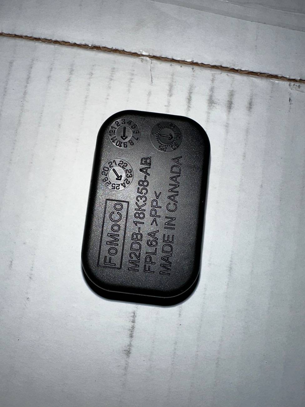

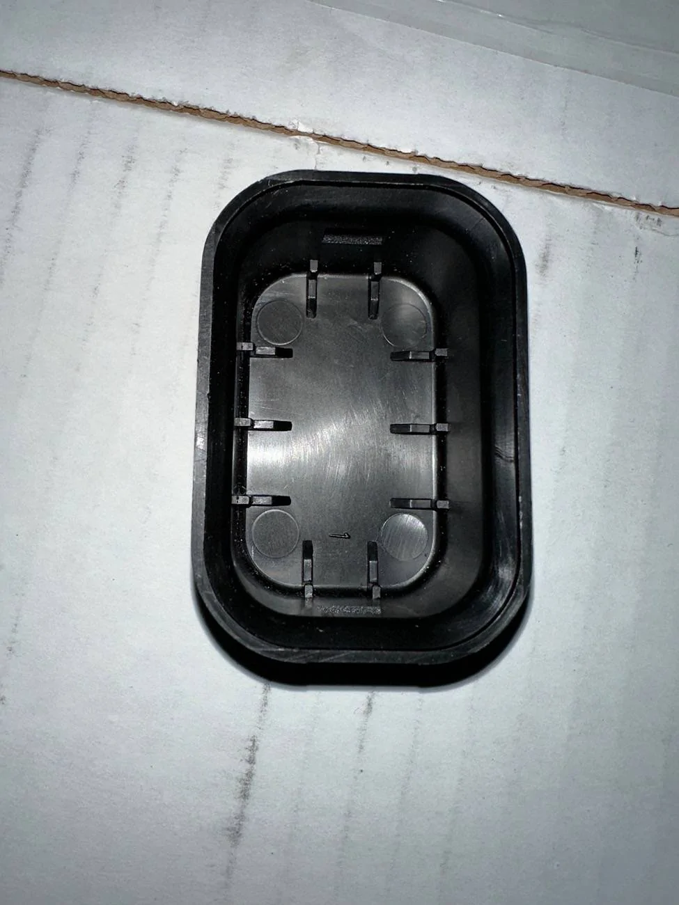

Hello all. I’m fairly new to this forum. Love the content it has and the experiences shared amongst the Bronco brethren. Today I was installing OEM weather mats on my 2024 2 door big bend. Usually I have the rear seats down but what I noticed an odd shape black cover that was behind the drivers seat on the floor. It has a part number and though I searched it all it comes back is the name connector or Restrictor in other links.
Anyone know where this goes?
Part FoMoCo M2DB-18K358-AB FPL6A >Pp<

Looks to me like it would be up behind the radio, under the dash, to me, and it looks like a cap to restrict air flow, like if you had a 2door.

I do have a 2 door. Can’t seem to find where it came off. My seats were folded down at the time then I purchased the OEM all weather mats. When I lifted the back seats to install them, I found it on the rear passenger floor behind the drivers seat.

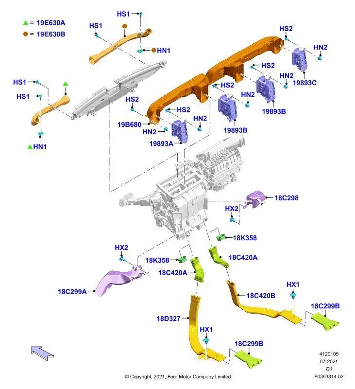

Up under the dash on the HVAC housing.
