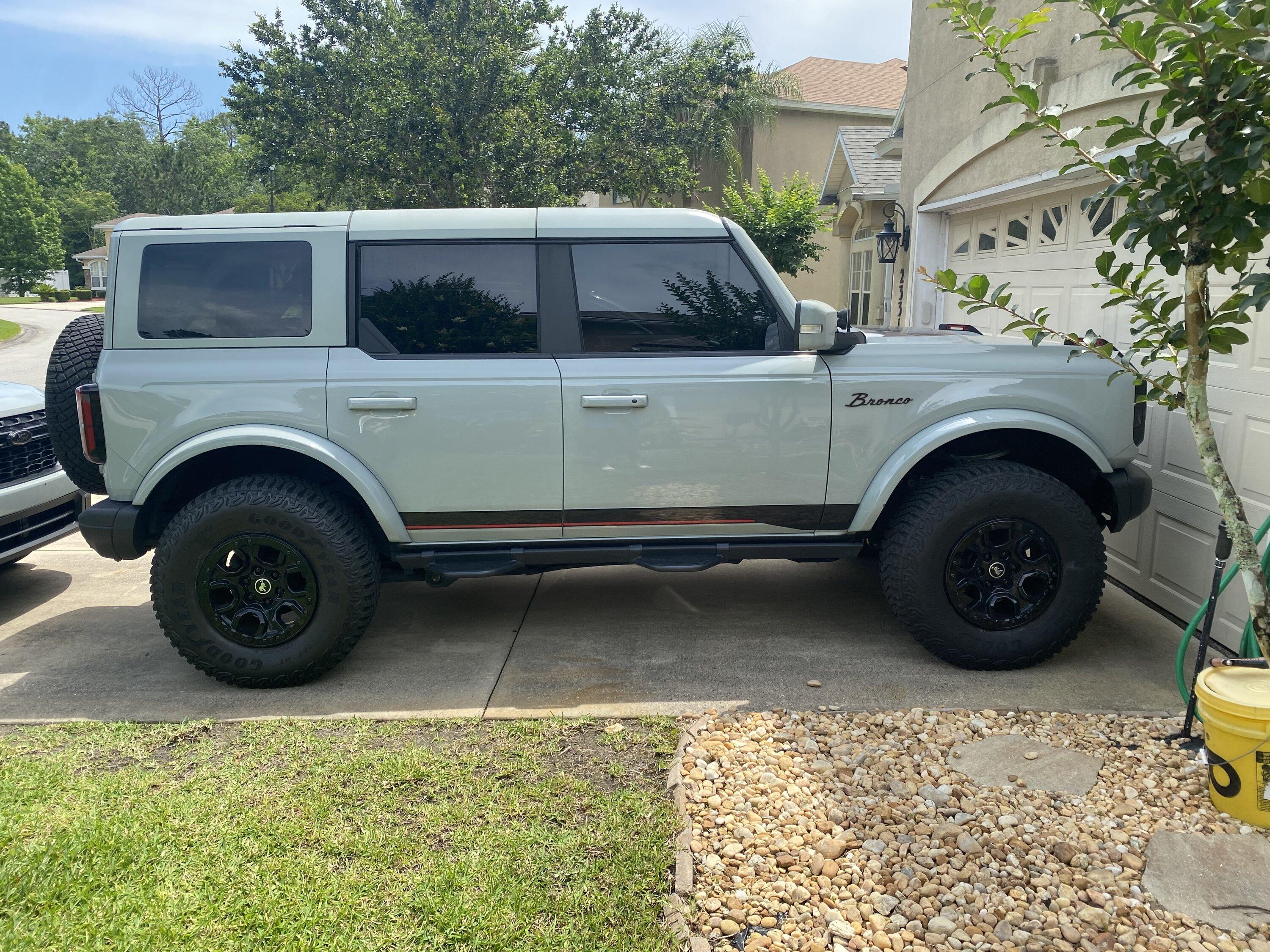

I had a shop do it. He’s done a few of them now and they are better than mine. It takes him about 3 days.

2023 Outerbanks Bronco
Did you apply at home or have a shop. I have the setup to do at home but I’m willing to pay to not have the hassle or headaches associated with.
Advanced Cerakote @Advanced Cerakote have done tops/grills. They do quality work. Not that it pertains to your needs for an Oxford White top, but they won't do large surfaces with the metallic paints. I inquired about velocity blue and Adam politely declined as the closest match isn't a direct match to VB and the large surface of the MIC top would make the mismatch obvious.
