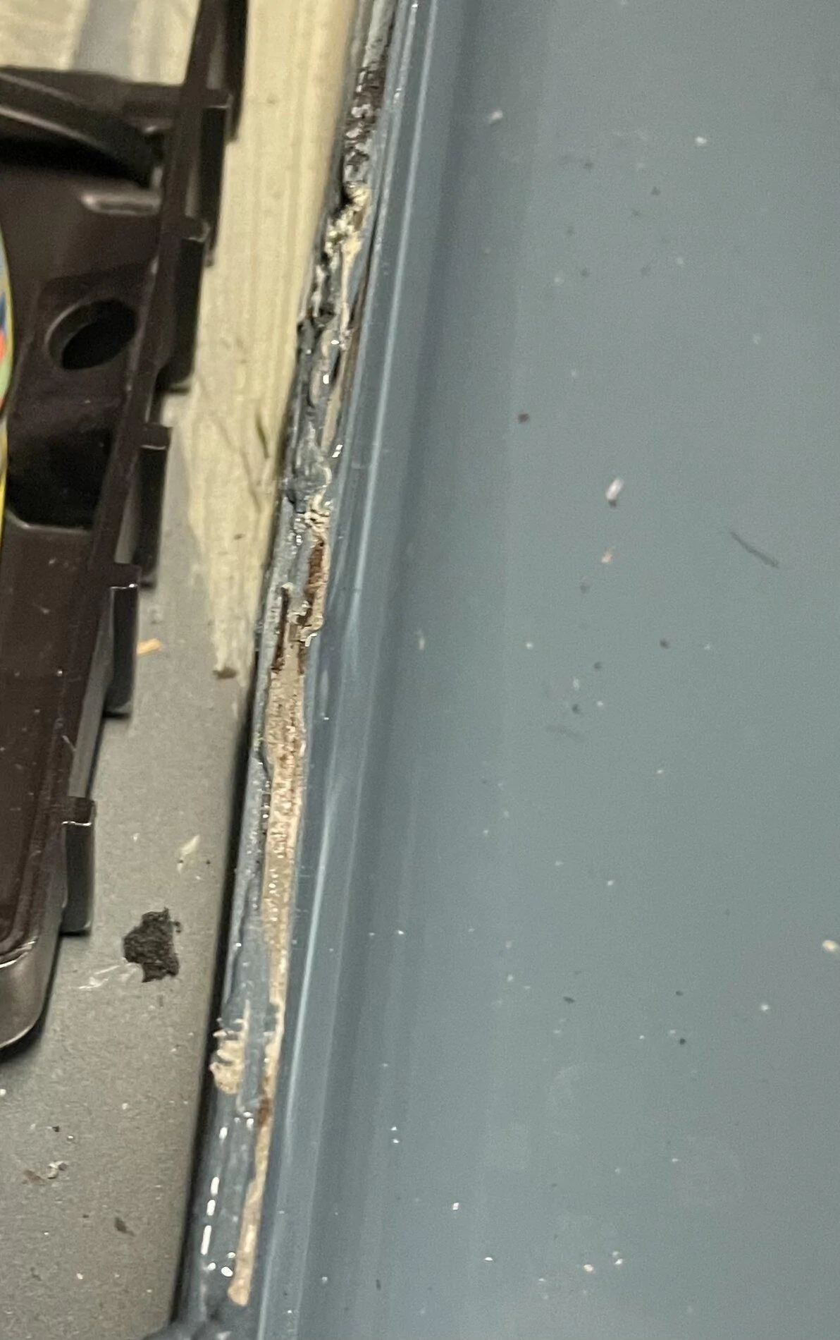

Pictures? As someone who spent the last 21 years of my career with 3M calling on the collision market /body shops, all these paint and seam sealer issues will mean I’ll be able to use up some of my samples fixing what Ford didn’t get right at the factory, lol.
My experience with seam sealer is its tough as nails. REALLY tough. This stuff you could crumble off with a soft bristle tooth brush. What is odd is there is this odd brown mud like substance in-between.
I took the liberty to crumble a bunch of it off because it was just so fun.
There are a bunch of different types of seam sealers and I sold about 20 different ones to the body shops before I retired from 3M. The picture obviously shows a defective one but it should be straightforward to repair. It sucks that Ford is having so many paint/body issues to go along with all the delays.
Yeah. Oh well. Ill probably just gob some sealer on it from the paint and body store and spray it with some rattle can Area51. Or on second though. I will probably do nothing to it.

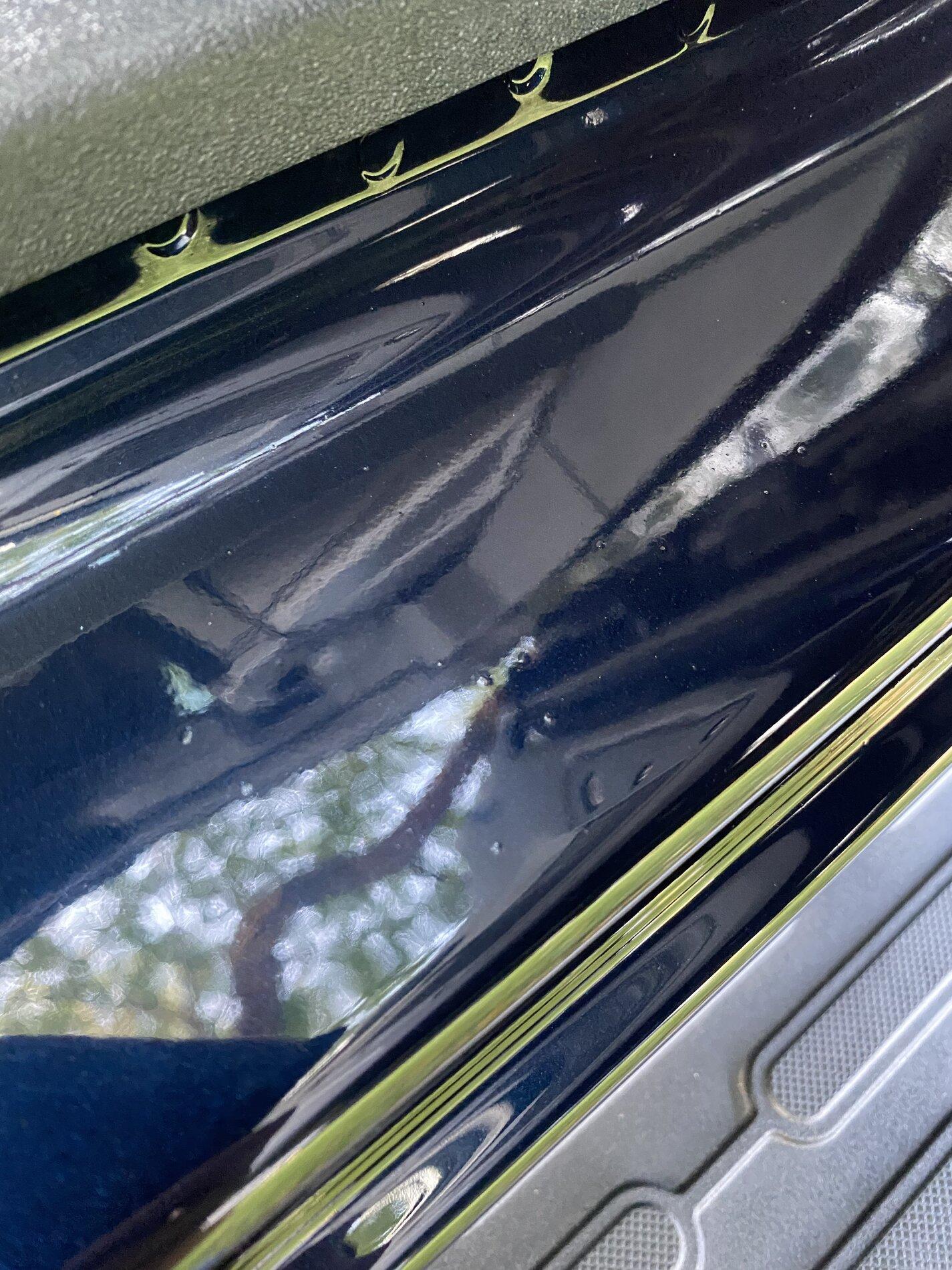

Was just wondering if anyone has experienced or noticed any quality concerns yet with the paint. Was giving the car a thorough clean today for the first time and noticed what looks like a bunch of tiny bubbles through the clear coat on my door sills, especially on the passenger front.
Anyone have any suggestions? Thanks 👍
almost look like "fisheyes" which is defiantly a poor paint job...dealership should address it and take care of it....

@broadicustomworks might be able to help out here.
Thanks!
Definitely trash in the paint, high probability also that that looks to be a rework area, sprayed after the fact by hand. The paint has a higher level of dye-back look vs. the rest of the finish on these I've seen, which points to a quick respray, forced to dry fast with an accelerator mixed in.
Those look to be decent-sized chunks under the base and clear, potentially all the way down.
One thing that can be done is to nib them off, but if they go as deep as I think they do, you will expose primer and/or metal.
Definitely get the dealer to rework it.
Check their blend lines also when you get it back, make sure it isn't rough to the touch and "burned in" effectively.
Those areas are probably classified as a "B" surface, meaning the amount of gloss, coverage, and trash/defects allowed are higher, but even at that, that is too much trash for even a "B" grade. If it were under the rocker panel or beneath the sight line of a bumper it would be more understandable. To be a highly-visible surface, it shouldn't have near that.
Regardless of the how and why, it's definitely something that shouldn't be there and unacceptable as a customer of a brand new vehicle.
