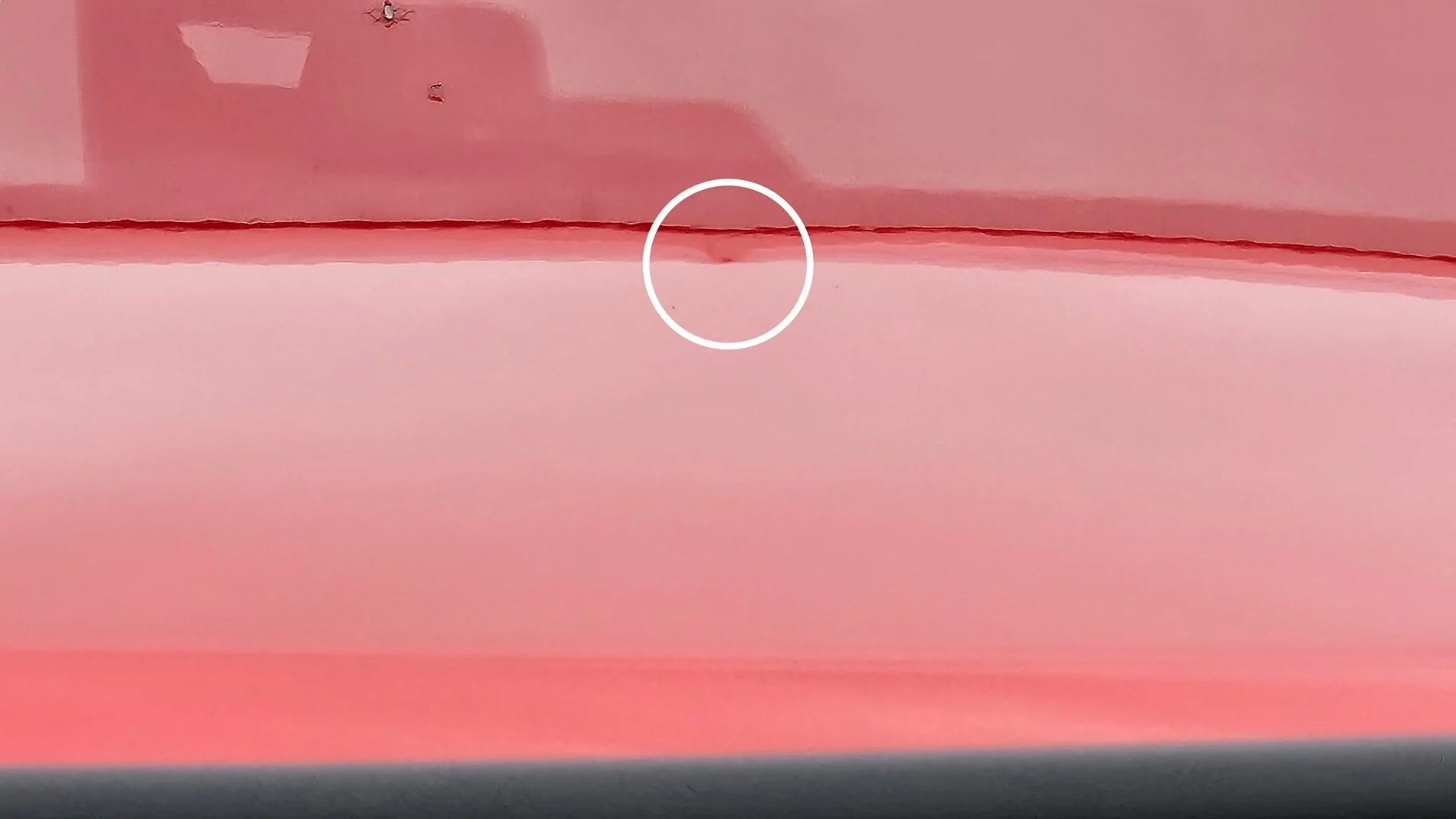

I had the paint blemish on the hood. It looked like something pushed up on it from underneath but it was concealed under by one of the ribs. I went into the dealer and told him that I would put up with it for some accessories that I wanted. He agreed and I got 500 bucks worth of swag for nothing.

I am over prep and application of paint in an auto factory. All of those pictures are most likely PVC for corrosion resistance that was not removed at PVC and was missed in prep. I'd love to see you guys come and miss zero doing the same pattern 300 to 400 times a shift. That being said, PVC should not be left on any car.
I would never have a car repainted that couldn't go in an oven unless it was to corrosion proof a car. Factory spot repairs heat the metal to bake the paint. The car goes through an oven that is north of 400* in spots (heating zones then cooling zones). Sorry for all who have less than perfect paint jobs. I'd suggest in the future you look over the unit this well before you buy. Most dealers will give money off that they charge back to the factory for these types of issues.
