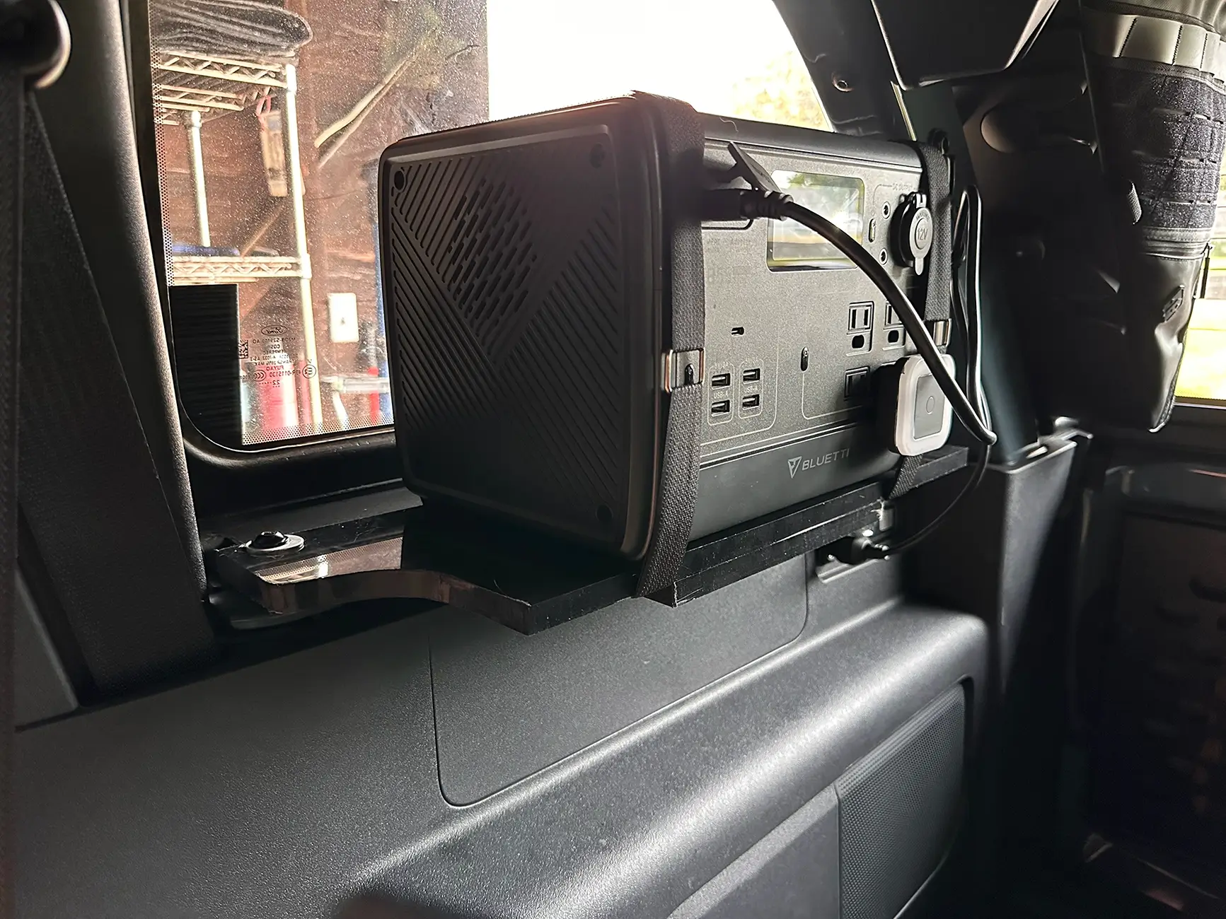

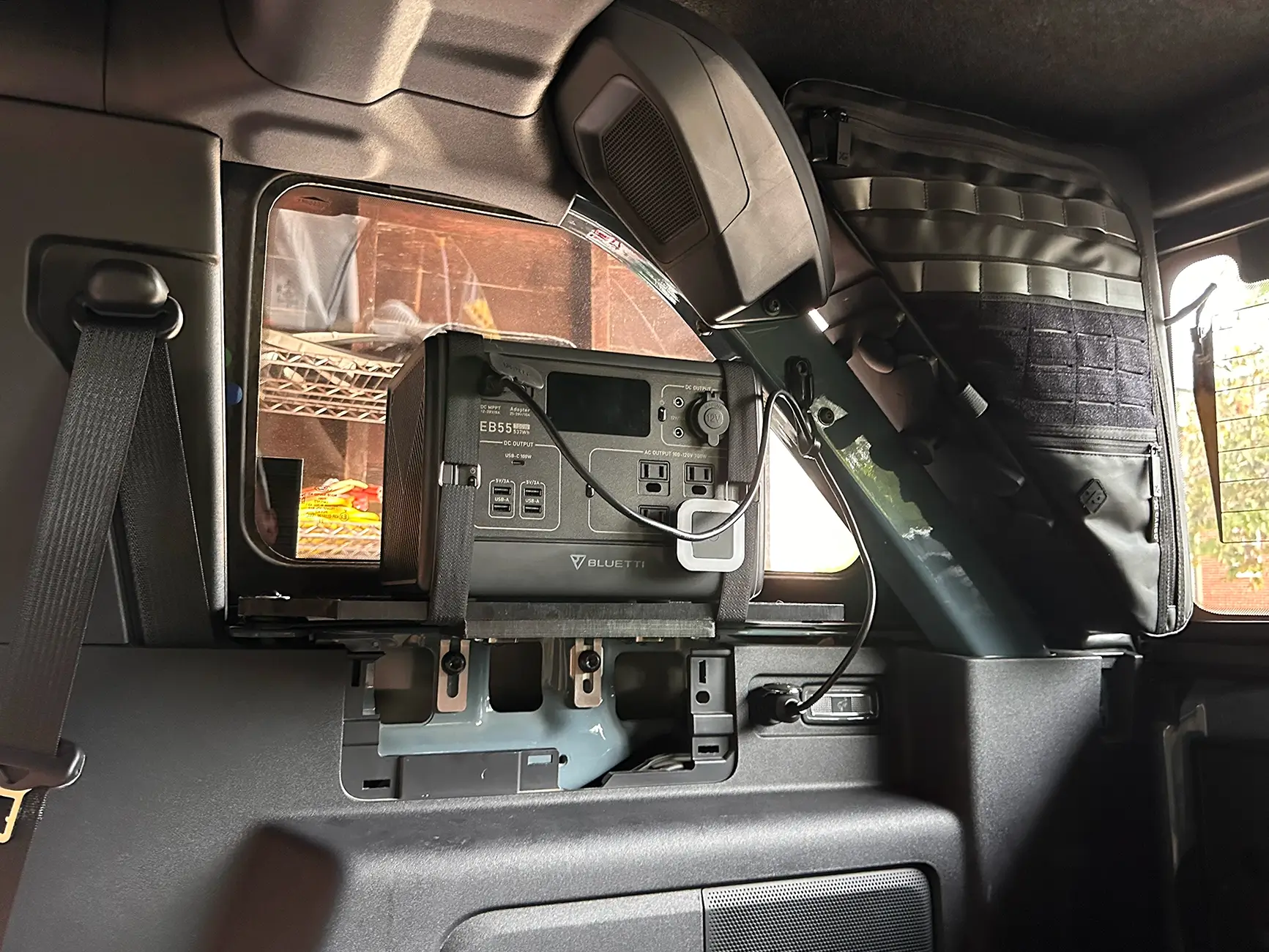

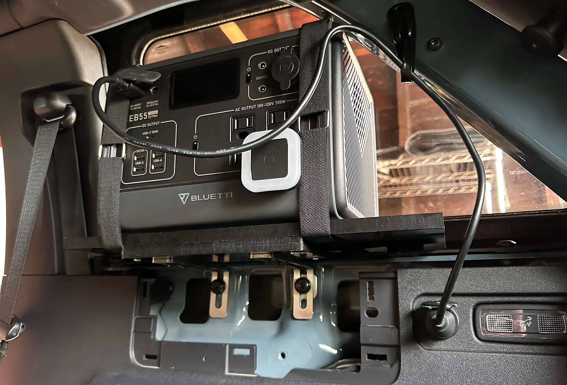

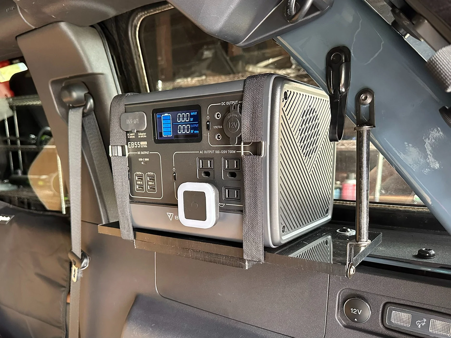

After 2 years of design and testing I believe I have perfected the design. Materials used include: 1/2 thick HDPE Plastic sheet, velcro straps, stainless stain slotted L brackets, M8x40 bolts, washers, 1/4 20 studs, two 3/8 thick spacers and adhesive rubber seals to keep it from scratching the plastic.
I plan to add my AC inverter under the shelf to make sure the power station stays charged. For now, I am trickle charging from the 12v. It's also tethered to the Bronco subframe incase of an accident.

That's a nice looking shelf. It doesn't vibrate around too much while in motion? I know those power stations can be heavy. It looks sturdy enough to support the weight for sure.
Have you had any issues trickle charging yours through the cargo power point? I know a lot of folks have come away with issues with the stock receptacle trying to charge power stations like this. Just something to be aware of.
I've been considering something similar after I picked up a similar Anker unit for cheap on Prime Day; I already upgraded my DC receptacle though but haven't done anything with mounting.

I have rubber washers to keep it from vibrating and the straps keep it firmly in place. It's very secure.
I had issues trickle charging with my first cable but updated to a better fitting 12v and have had no issues since.

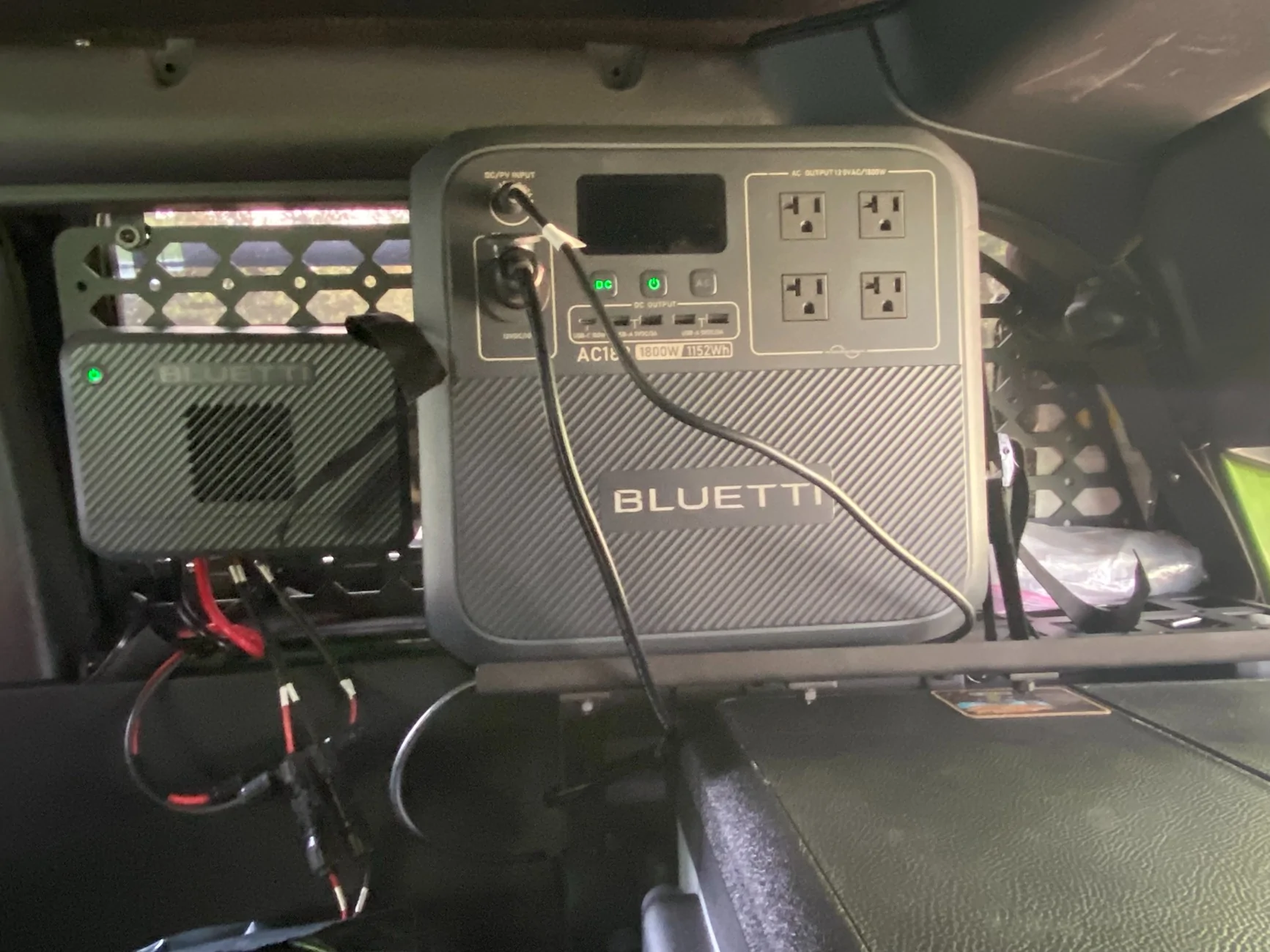

Nice. Rubber washer are a good idea, wish I'd have done the same. Here's mine but for the 2-door, AC180 (very heavy) and Charger 2. I chose not to use the rear 12v port, it overheats. I used Rough Country and Turn Offroad molle panels for support. Currently a week into a 2-week overlanding trip, washboard roads, and it's held up, so far.

Just keep an eye on that rear bronco cigarette socket, I've had mine fail with a battery similar to yours plugged in for awhile. It will fail!

Not to be a downer, but I don't see how the forces from an accident wouldn't dislodge that thing. For one, those velcro straps are only in one plane. It isn't holding in what I would argue is the much more important plane (fore and aft). two, those right angle brackets are a failure point. The one holding vertically is what, 16 gauge? Those need to be wayyyy beefier to survive an impact.
Not trying to be a jerk or anything but concerned for your or passenger safety in an accident. That thing would be a deadly projectile, and it sits at head height.
Your concerns are mine too. The slotted L brackets are 8 gauge 201 stainless steel. The velcro straps are heavy duty. It's amazing how strong they are. There's rubber foam between the battery and glass. I'm adding another velcro strap in the other plane.
This is much stronger than any molle system I could find and I feel better than leaving it lay on the floor. It's also nice having it tucked up out of the way but accessible.

Yeah I think with a strap in the other plane that would make me sleep better
