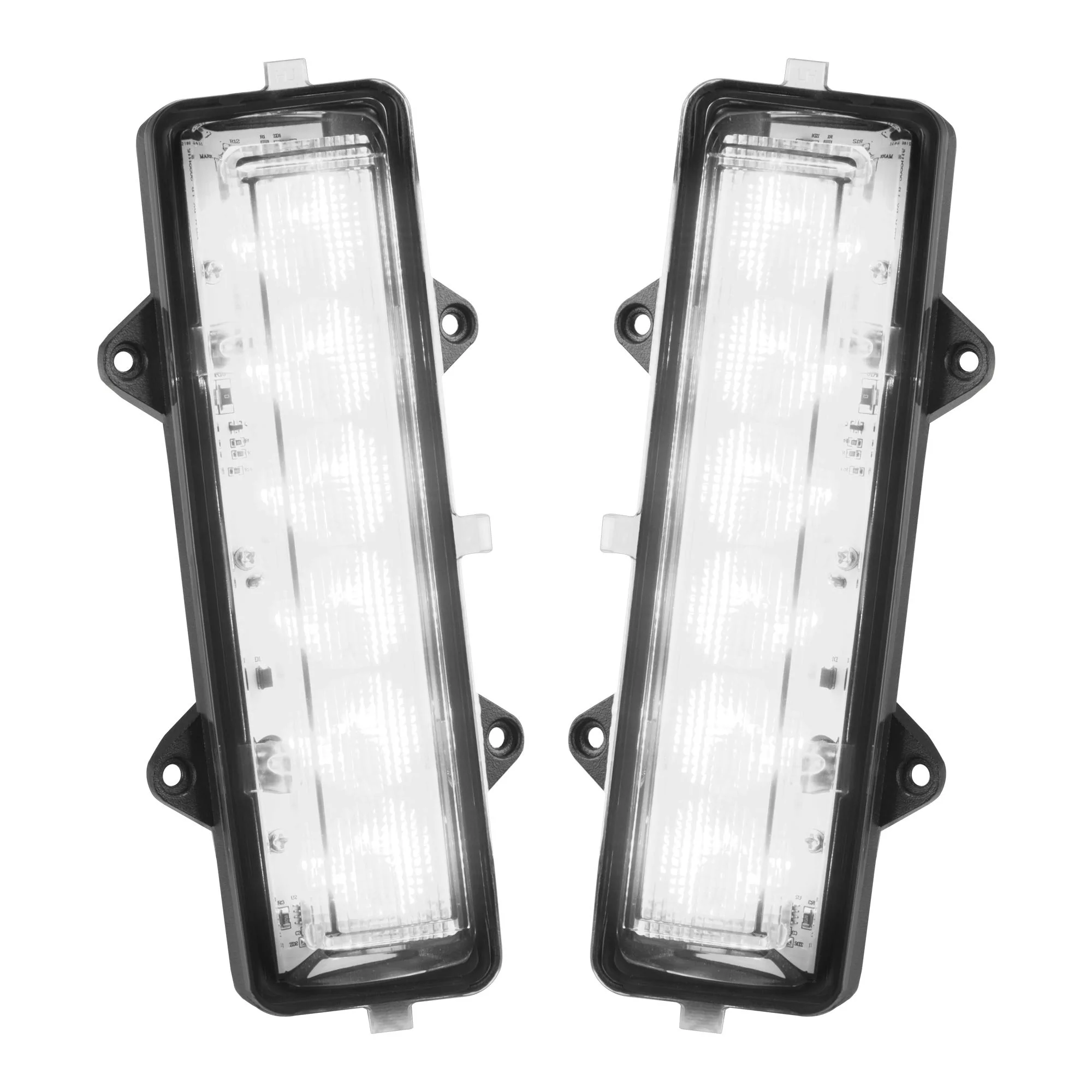

Want to add an Amber Turn Signal to your ORACLE Lighting Bronco Taillights? These new modules allow you to do just that.
Ford Bronco ORACLE LIGHTING: DUAL FUNCTION AMBER/WHITE REVERSE LED MODULES FOR FORD BRONCO FLUSH TAIL LIGHTS 52885009588_1c5fc93648_o

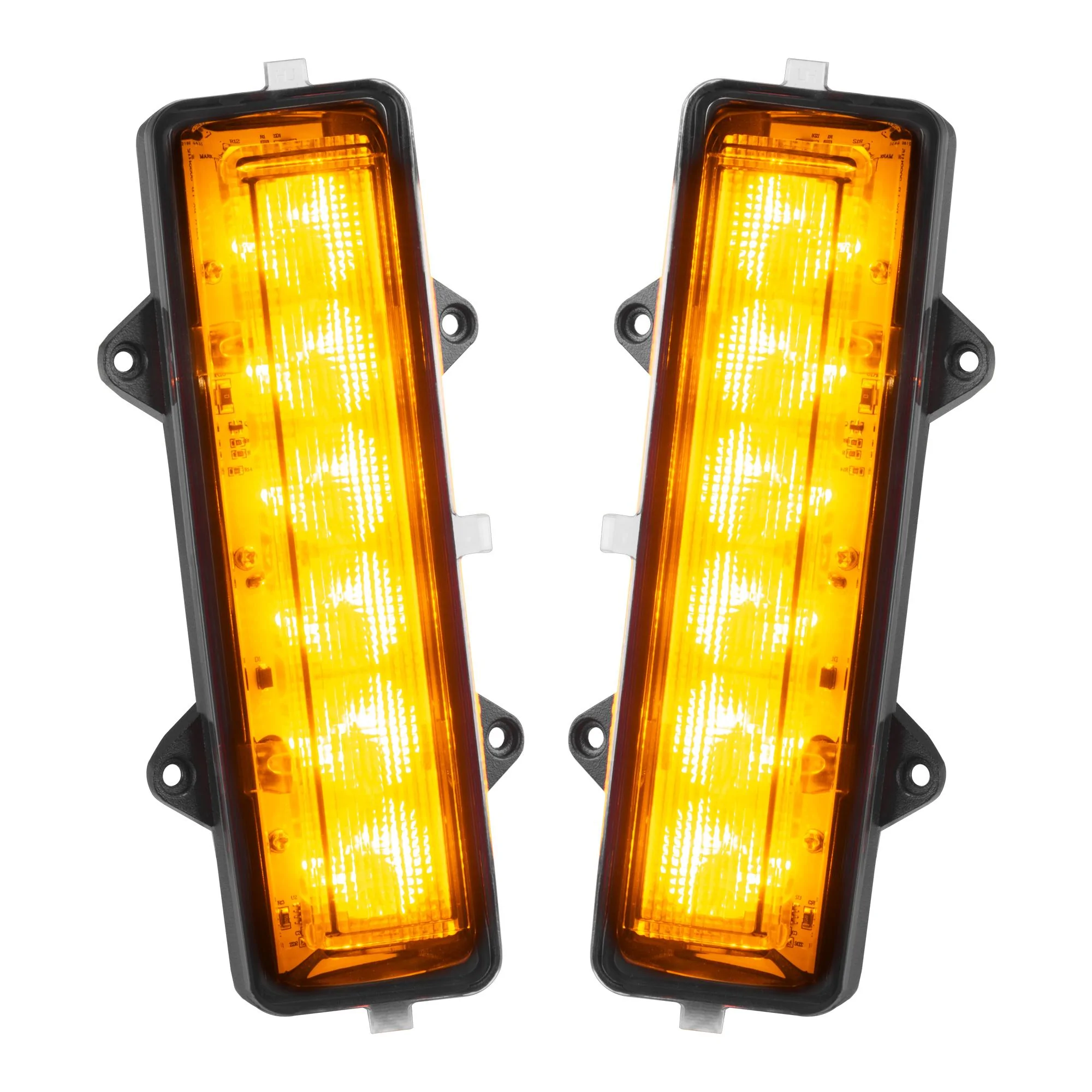

The reverse light still functions like before with the same brightness but now also has an Amber feature for a bright turn signal in replace of the Red Taillight section flashing.
Ford Bronco ORACLE LIGHTING: DUAL FUNCTION AMBER/WHITE REVERSE LED MODULES FOR FORD BRONCO FLUSH TAIL LIGHTS 52883987307_92ca921fd4_o

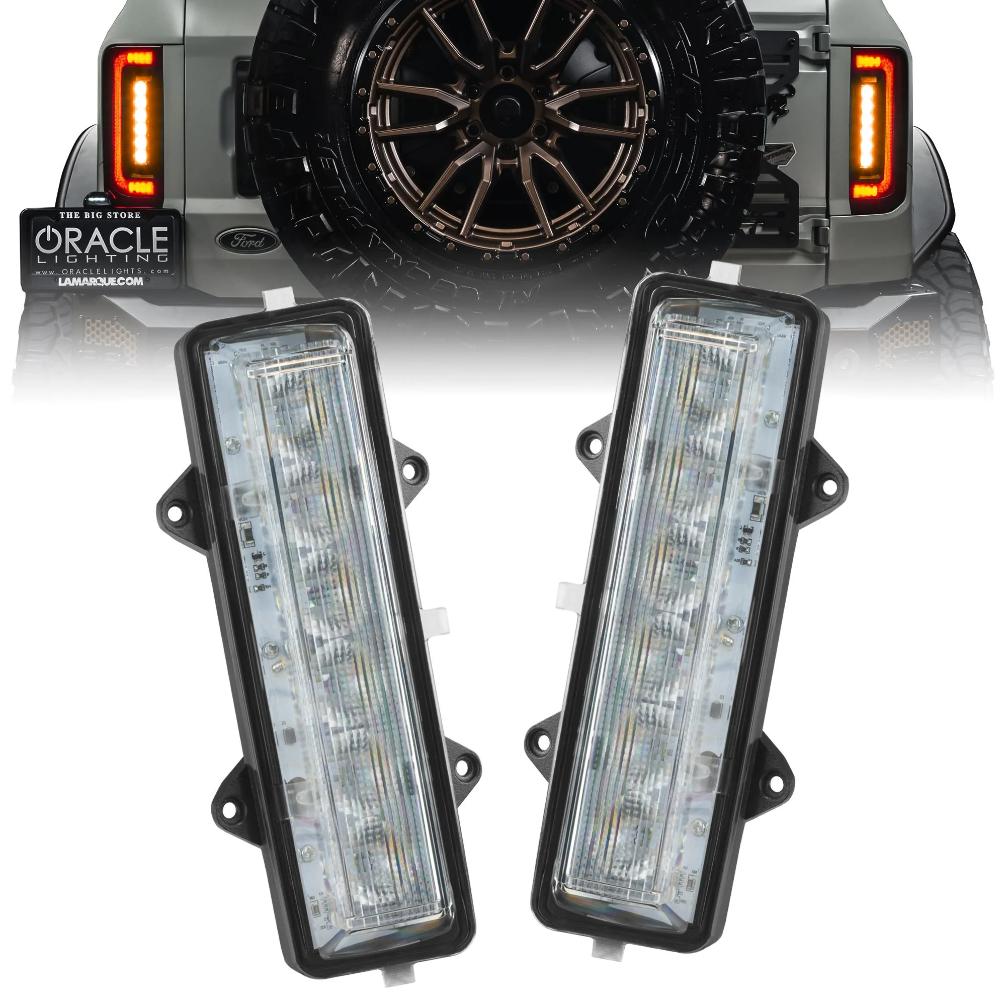

Installs by removing the original modules and installing the new modules with the existing hardware. Wiring connects to the existing connector and a pin is added to original plug.
