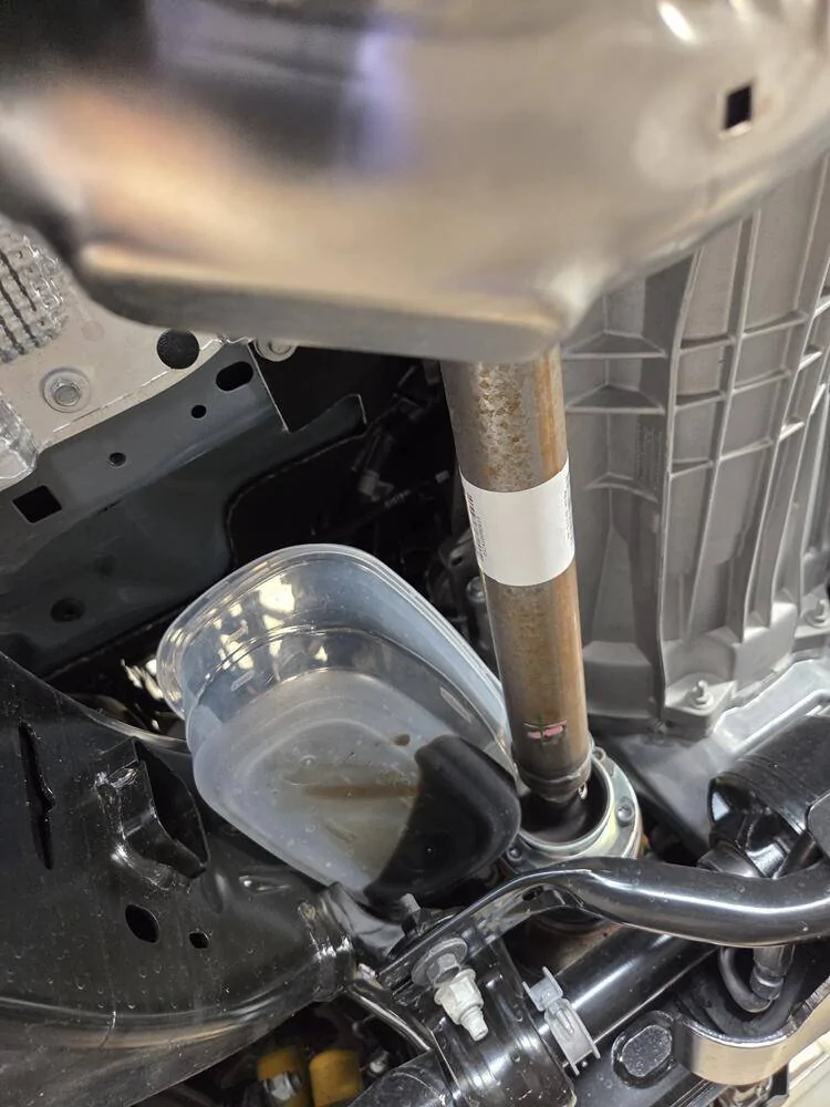

I did my first oil change today in my 2.3l. For the filter, I tried going through the wheel well as is suggested, but I found that annoying as hell (I have a bad back and squatting/kneeling to reach in there is not fun).
Instead, I went underneath. To not get a face or arm full of oil, I wedged a tupperware where it would catch all the oil from the filter drain channel. Then I just went over the top of the channel and drive shaft, and used a filter wrench with no extension to loosen. Worked great!
My OCD made me prime the filter with oil even though it's installed on it's side. I noted that the old filter still was about 1/2 full after taking it off, so I filled the new one 1/2 full. Seemed to mostly stay in when I put it on. I only had a small bit of oil to clean up out of the channel after it.
