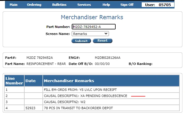

Just a word of caution based on some limited information I found in DOW (Ford's parts system). The two brackets behind the rear cargo area trim panels are on backorder but the note in the system, if accurate, says those part numbers are pending obsolesce. I do no see a updated or replacement number in the system as of now so take that for what it's worth. This could also be incorrect information on Ford's end but no way to tell at this point.
Evidence.

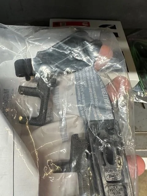

We have an inquiry in with Ford for the brackets since we ordered more about a year ago and they just finally came in with the new number and pricing. If price is correct, we're sending them back.

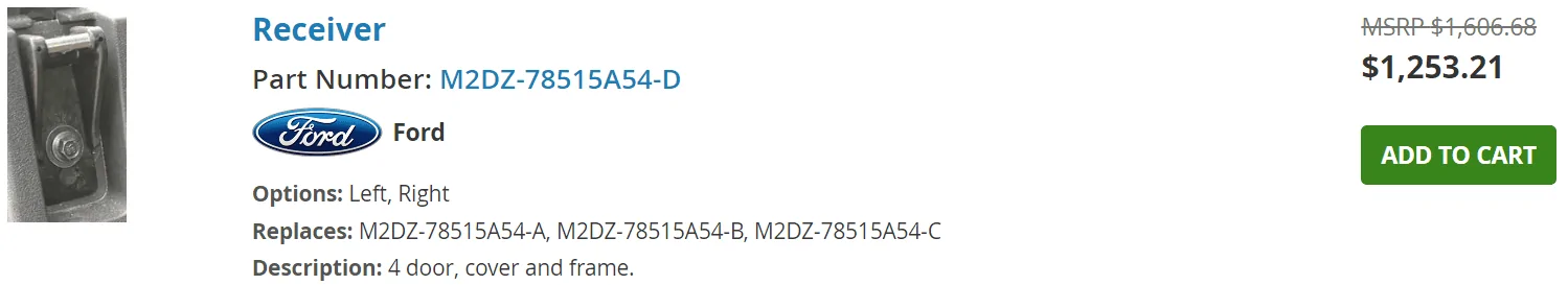

:oops::oops::oops:
Ford Bronco OEM top question 1712761357519-ca
I can see why M2M makes their version now - it's a steal

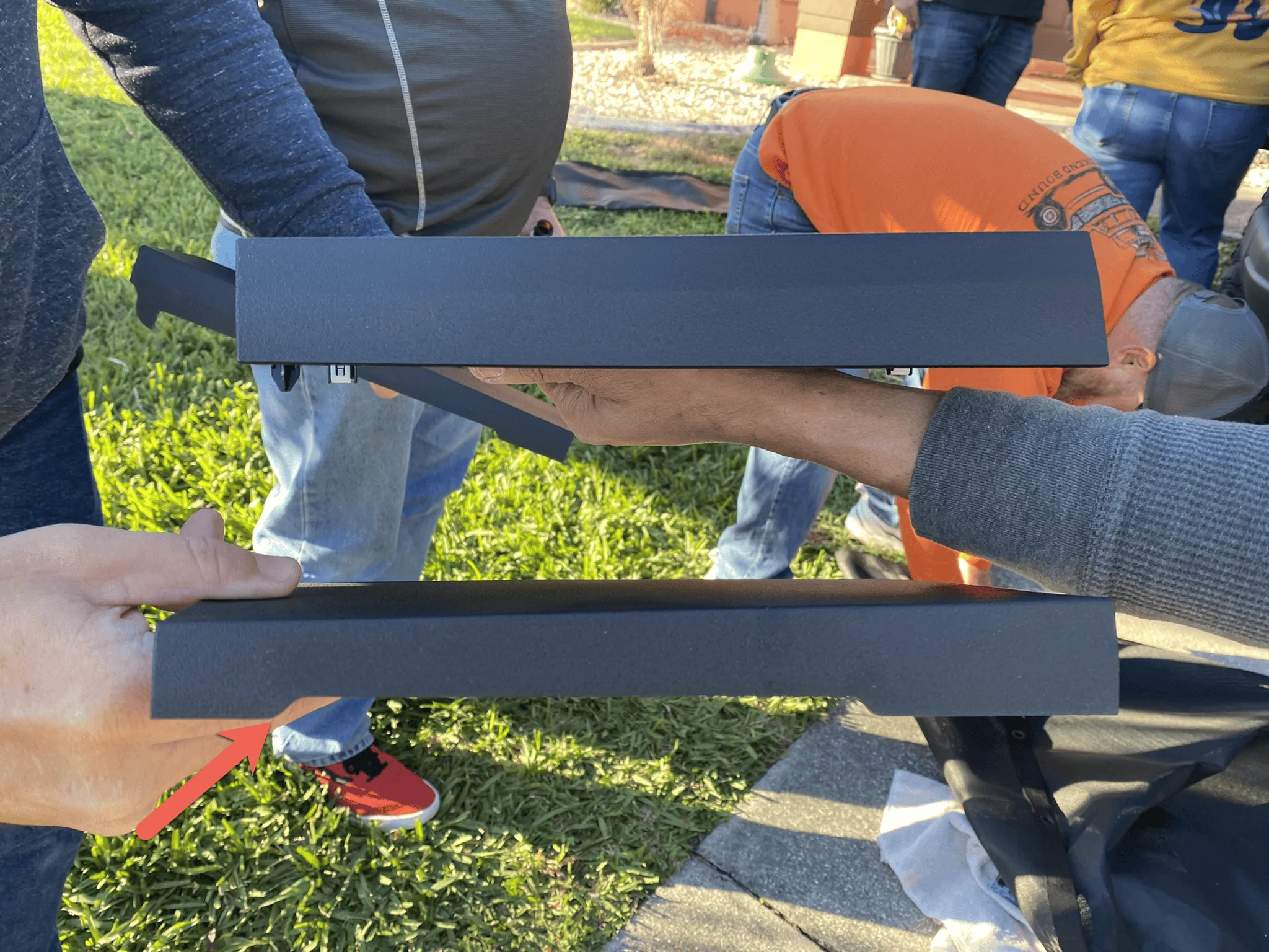

I don't blame you all at all. That is ridiculous. Do you know if this part is orderable? If not, I'll either have to go without a plastic cover when using the soft top or cut my piece:

Yeah ... I just about cried when I saw that. So thankful for @Mountains2Metal

Is that the $1,300.00 Ford one?
Yup. Just looked at the COPIS case my PM opened and they changed list to $670.47 so I sent them the same pic and said the decimal needs to move one more place to the left. I can see a list of $67.00 but what they "confirmed" to be the new correct amount is still not possible.
