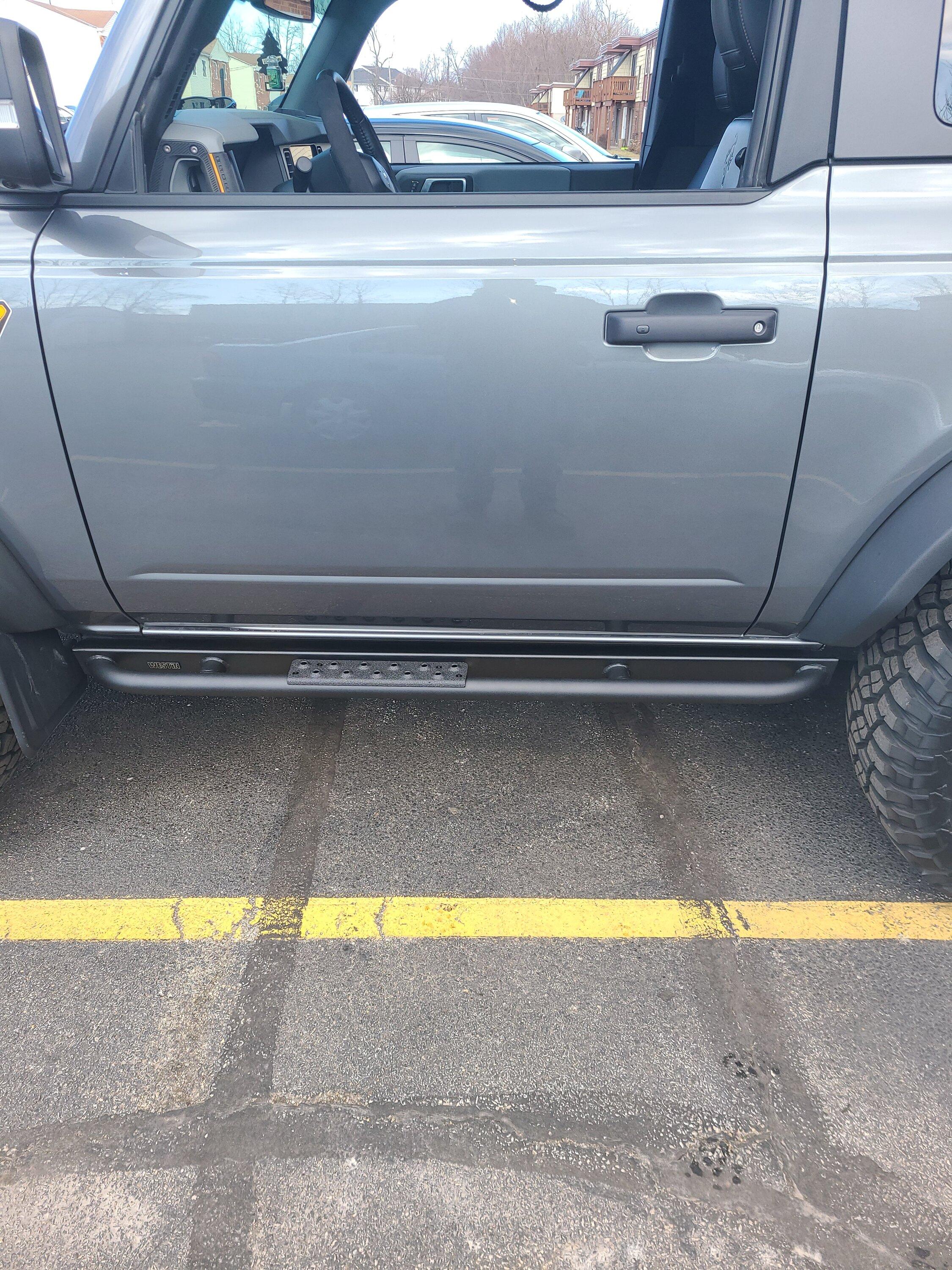

My BadSquatch oem sliders I removed and upgraded to the WESTIN XTS.. looks and fits like the oem sliders but with a nerf type step for me to get in it.
Sold the oem's for $200..the westins cost $980..
