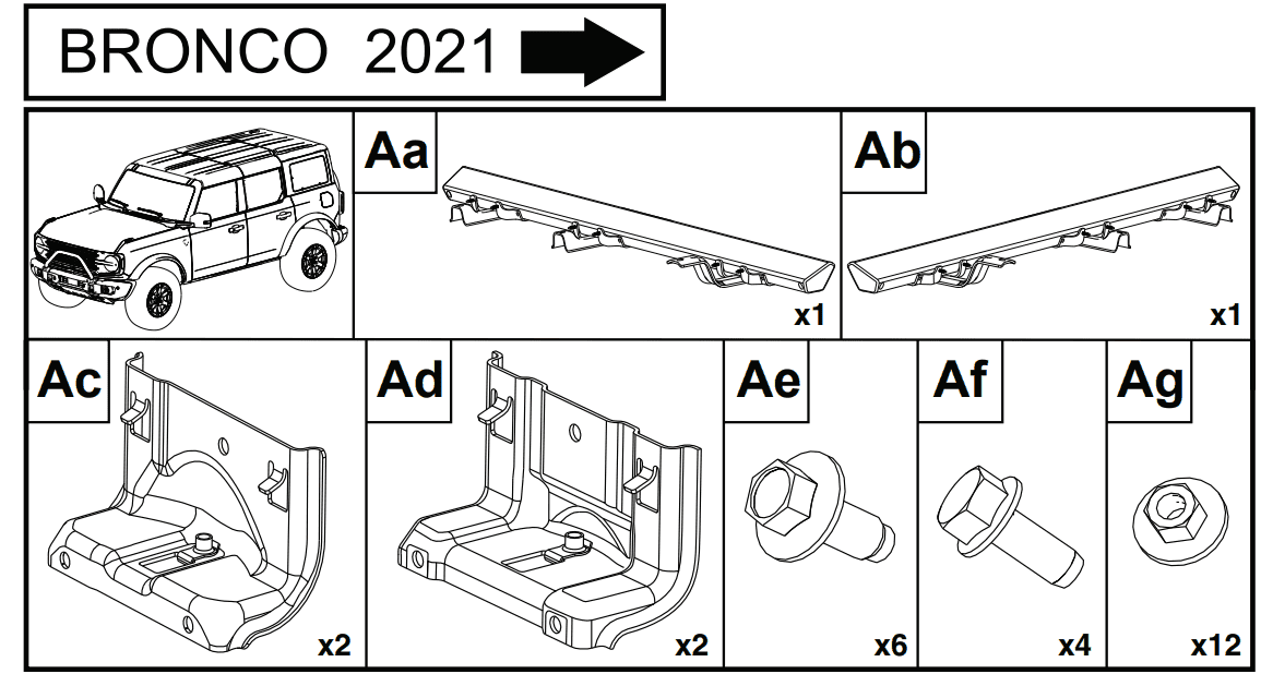

Just realized as I am installing it. I am missing all the bolts lol. Does anyone have the size and quantity for all the bolts for the rock rails? I am looking at the instructions but it doesnt say the size for Ae-Ag.

I took off my rails a couple days ago and have it laying around. This is what you need for 4dr.
12x M6-1.0 threaded nuts all the bracket studs
4x M8-1.25 20mm bolts for 2 rear brackets
2x M10-1.5 22mm bolts for front bracket
Thanks for this info! Helpful to determine what I was missing from a used set I purchased.
