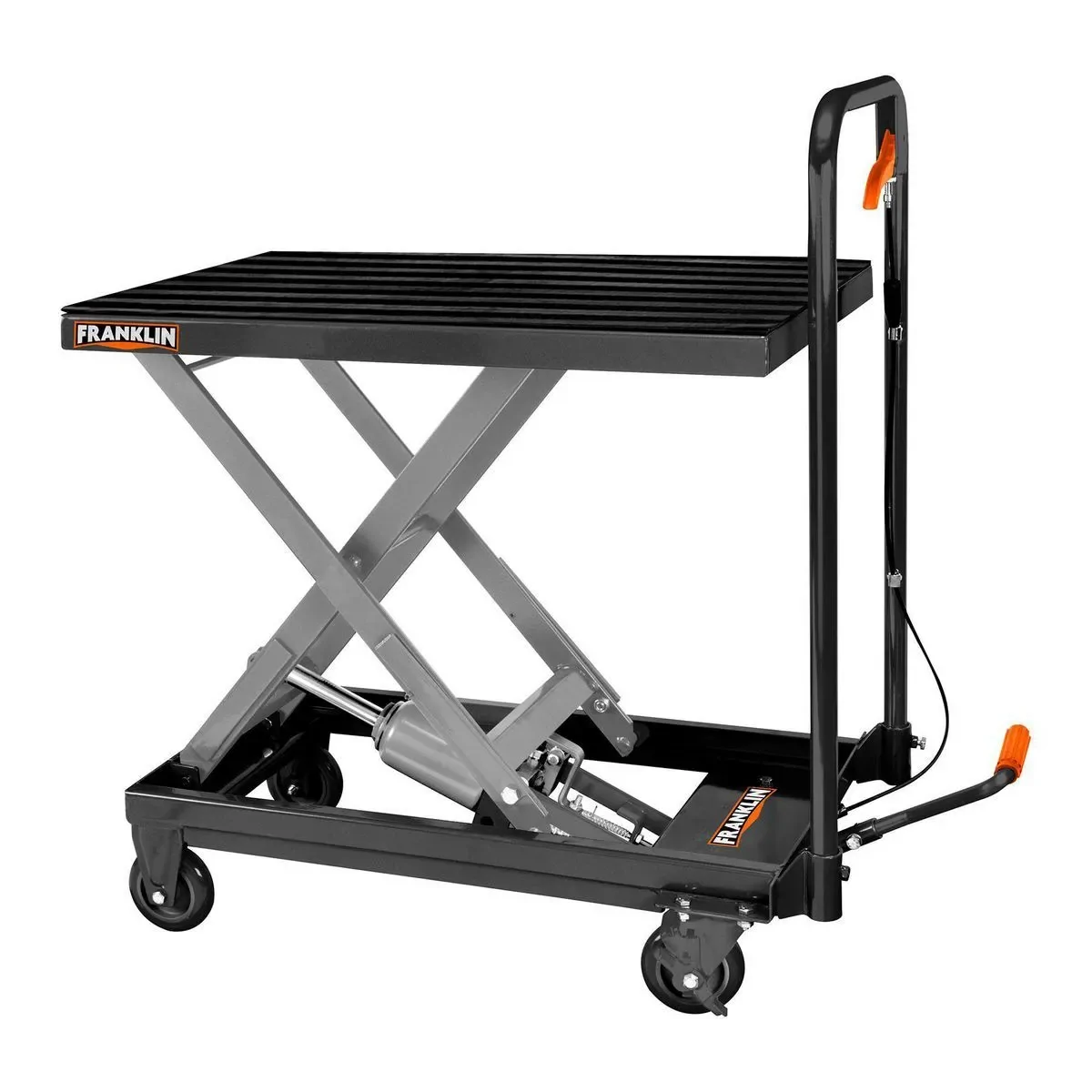

Also, a hydraulic table to keep the skid plate on helps a bunch. I have the one similar to the picture, I just unbolt the handle and lay it on the ground when I need to roll it under the vehicle.

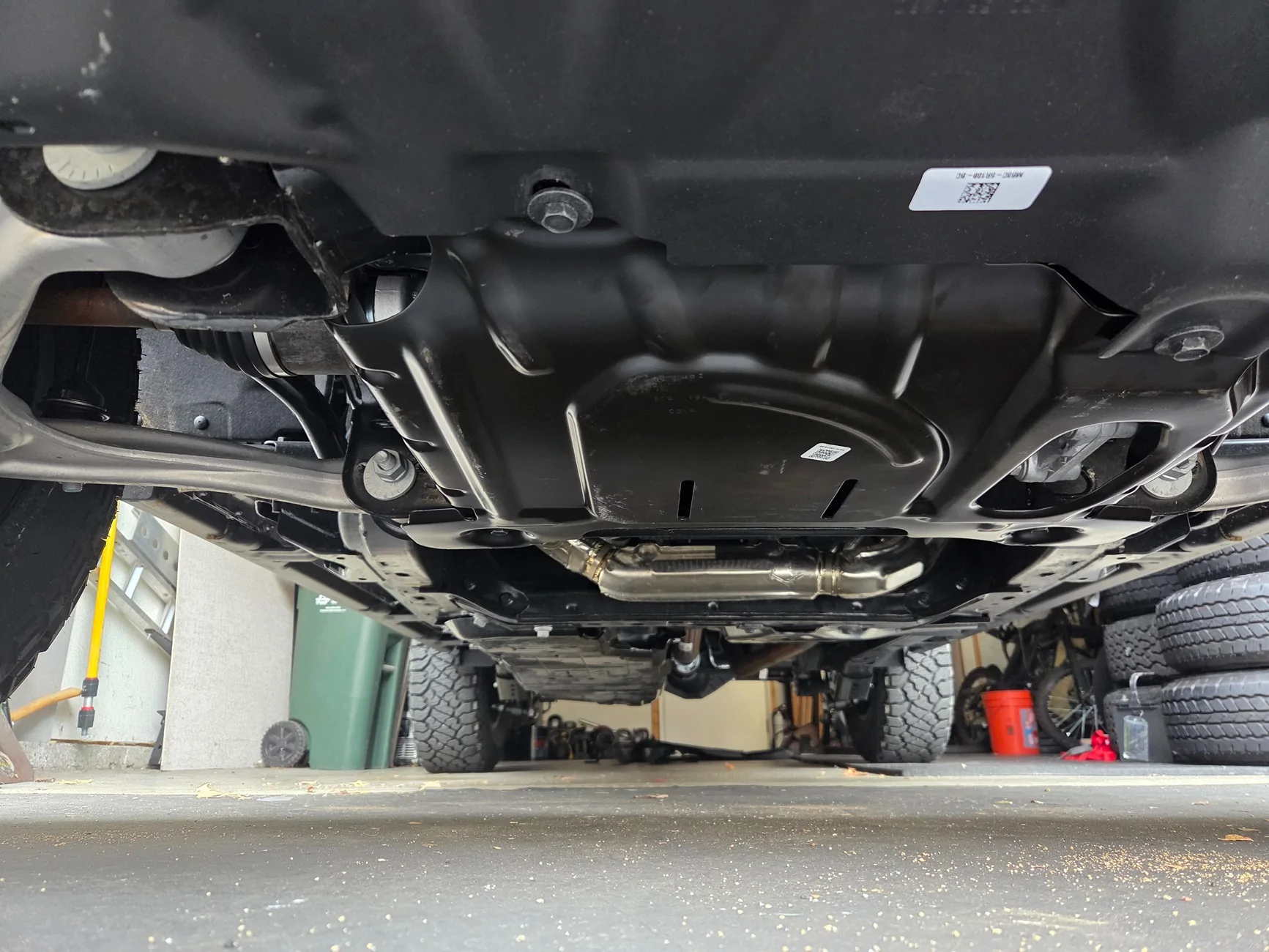

Just installed it using the jack method. I propped it up on 2 4x4s on each side then jacked it up in to place so I could get a couple of bolts started. The ratchet straps at either end were money.

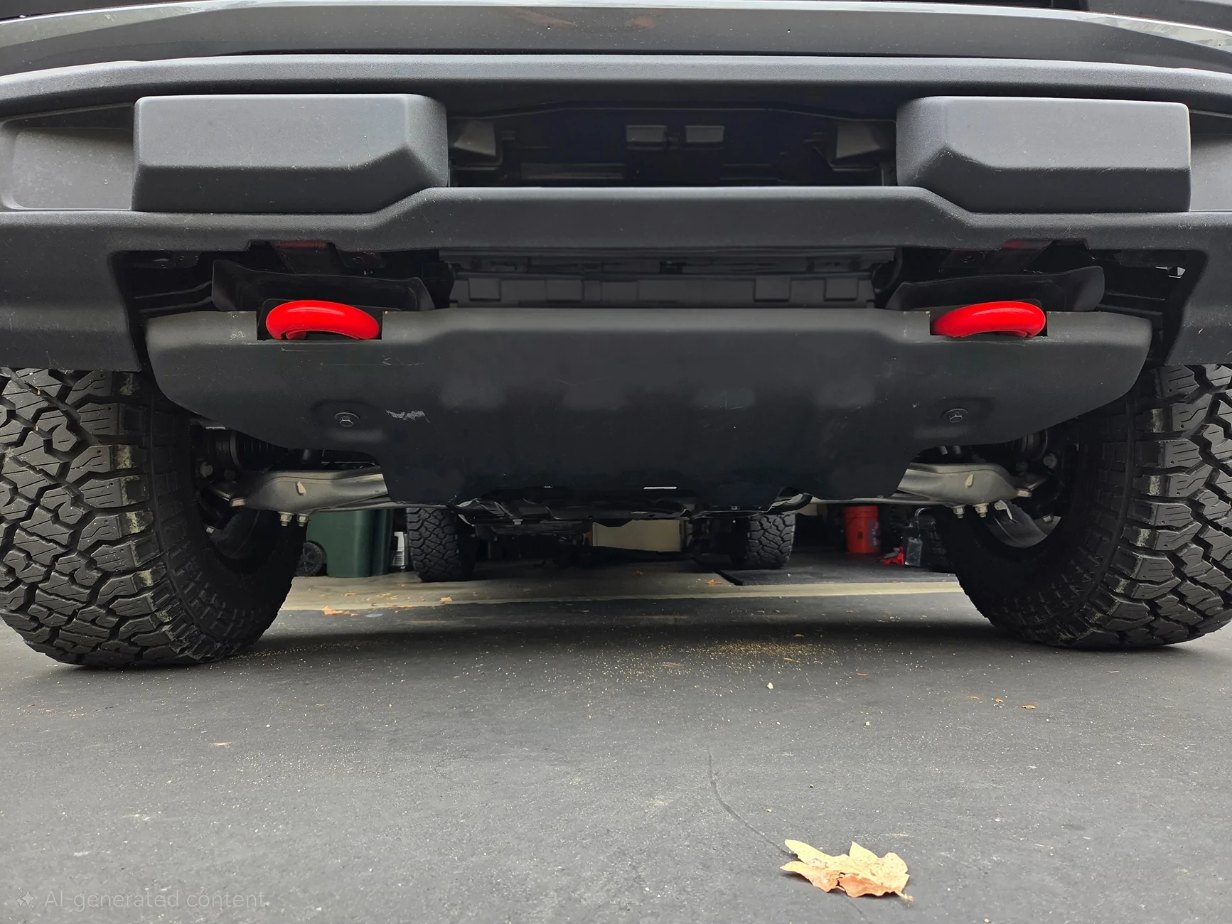

I also installed the transfer case, engine, and front bash plates. Because I only have the stock bumper I had to notch the front plate to get it to clear the recovery hooks. Someone on here did that and inspired me to go for it.

Awesome. Is there enough room to get a hard or soft shackle in those recovery hooks? I’d cut out a bit more so they’re usable when you need them!

There should be enough room. The picture is deceiving. I may at some point in the near future cut out some additional material just to be sure.

Cool. And grind it down smooth in case a soft shackle is used in the future.
