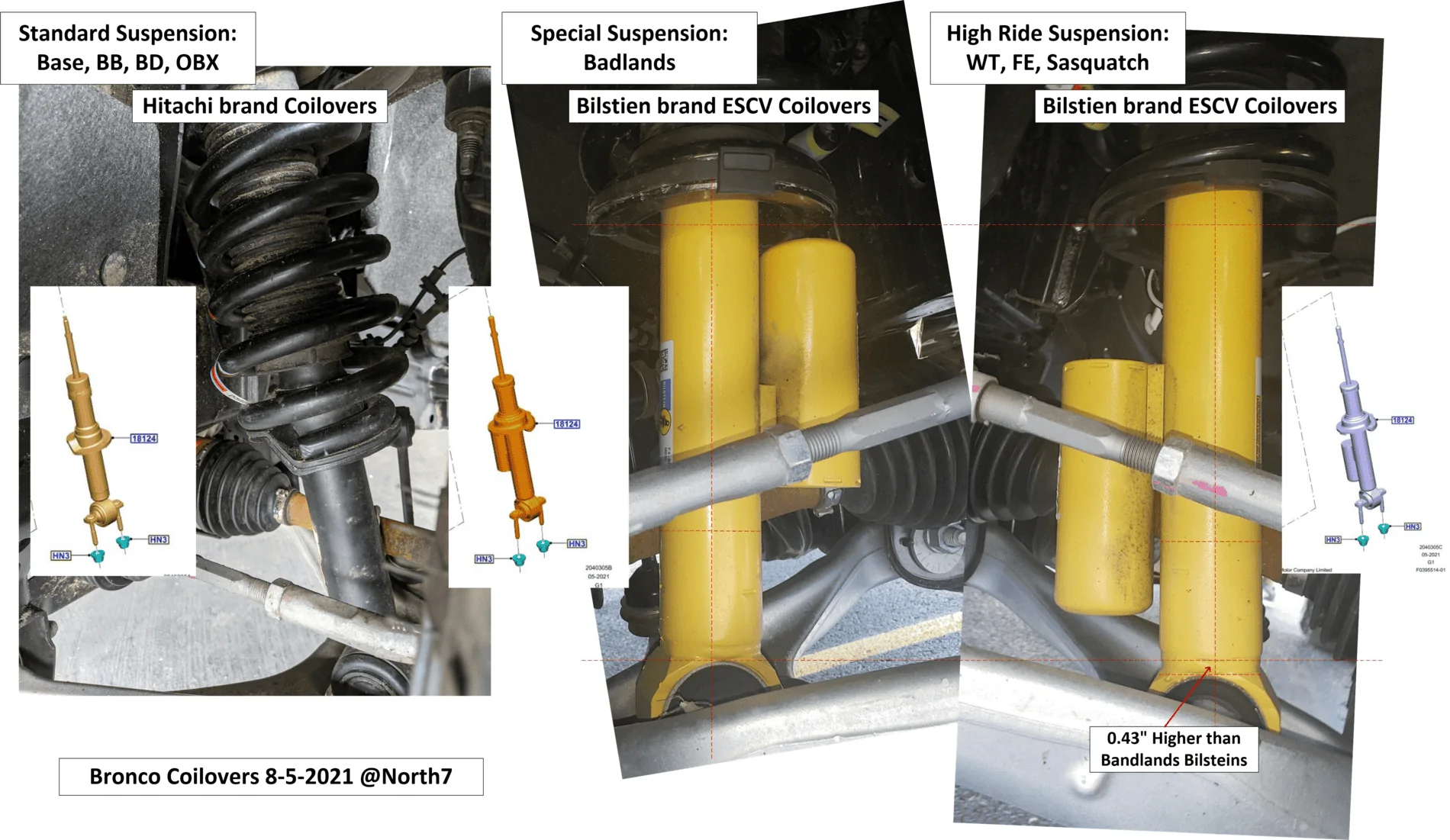

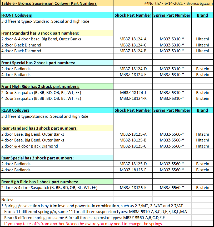

Here is that chart thanks to @North7
I always found it interesting that the BD has different shocks than the Base, BB nd OBX, anybody know what's up with that?
I believe the consensus is because it's heaver since it comes standard with more armor.
Right, although the PN's are for different shocks not springs, but probably right.
