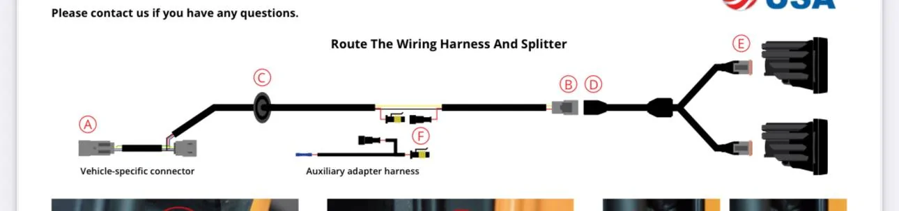

Has anyone had any issues with their reverse lights not coming on when going in reverse? I resolve it by shutting off the car and starting it back up. Issue just started. Yes I have aftermarket lights. I’ve had them on for months but this issue just started. When this issue happens the camera does work. Bronco enrages reverse (manual transmission) it shows it on screen to

The only aftermarket lights are the diode chase combo. I’ve unplugged those and the issue still happens intermittently

Are the aftermarket lights spliced into your factory reverse light circuits?

Not exactly. It’s a wire harness but it never gave issues before

Sounds like it may be now.
May be worth checking to see if a DTC is set for missing or shorted lamp. It wouldn’t necessarily set the CEL
