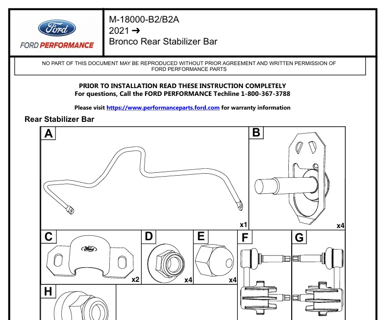

Thanks for the reply. I was going to write Sway bar, but I looked and the Hoss 3.0 wildtrack kit called it a stabilizer bar on the instructions so 🤷‍♂️
Ford Bronco No Rear Stabilizer Bar + Small Lift 1755706849303-kh
I was also looking at the Eibach 2.0s, how do you like them and any noticeable change in driving on-road?

They are soft and great for off-road. It has more brake dive because they’re softer. I rock crawl, so they’re perfect for me. You may want something a little stiffer if you’re more concerned about on road then off. But they absorb speed bumps like they aren’t even there..
