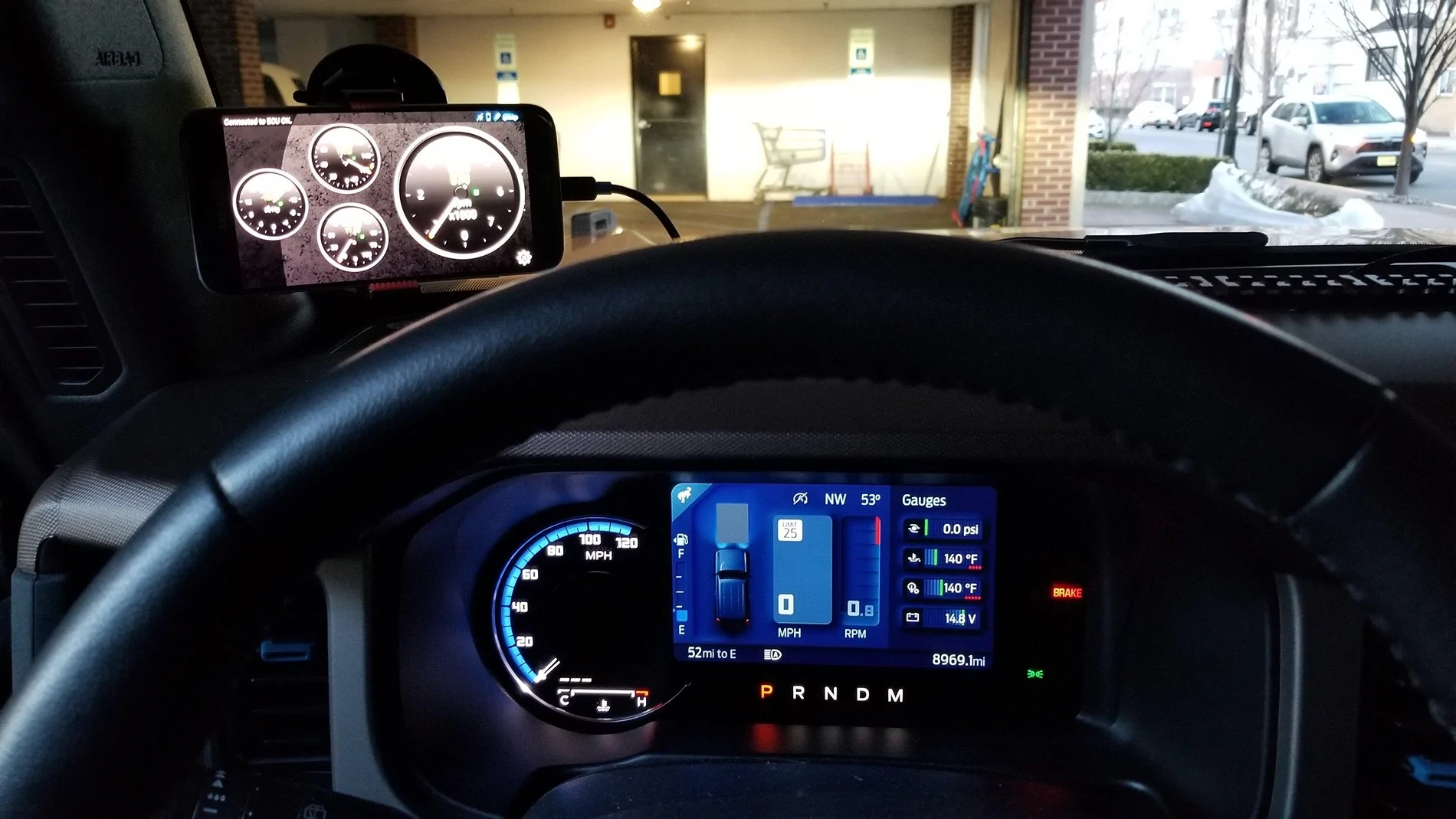

Here's my Torque Plus/Old Android phone tachometer MacGyver set-up: Total cost-$24.95
Added Bonus-Vacuum/Boost-Actual Torque to wheel-Coolant Temp.

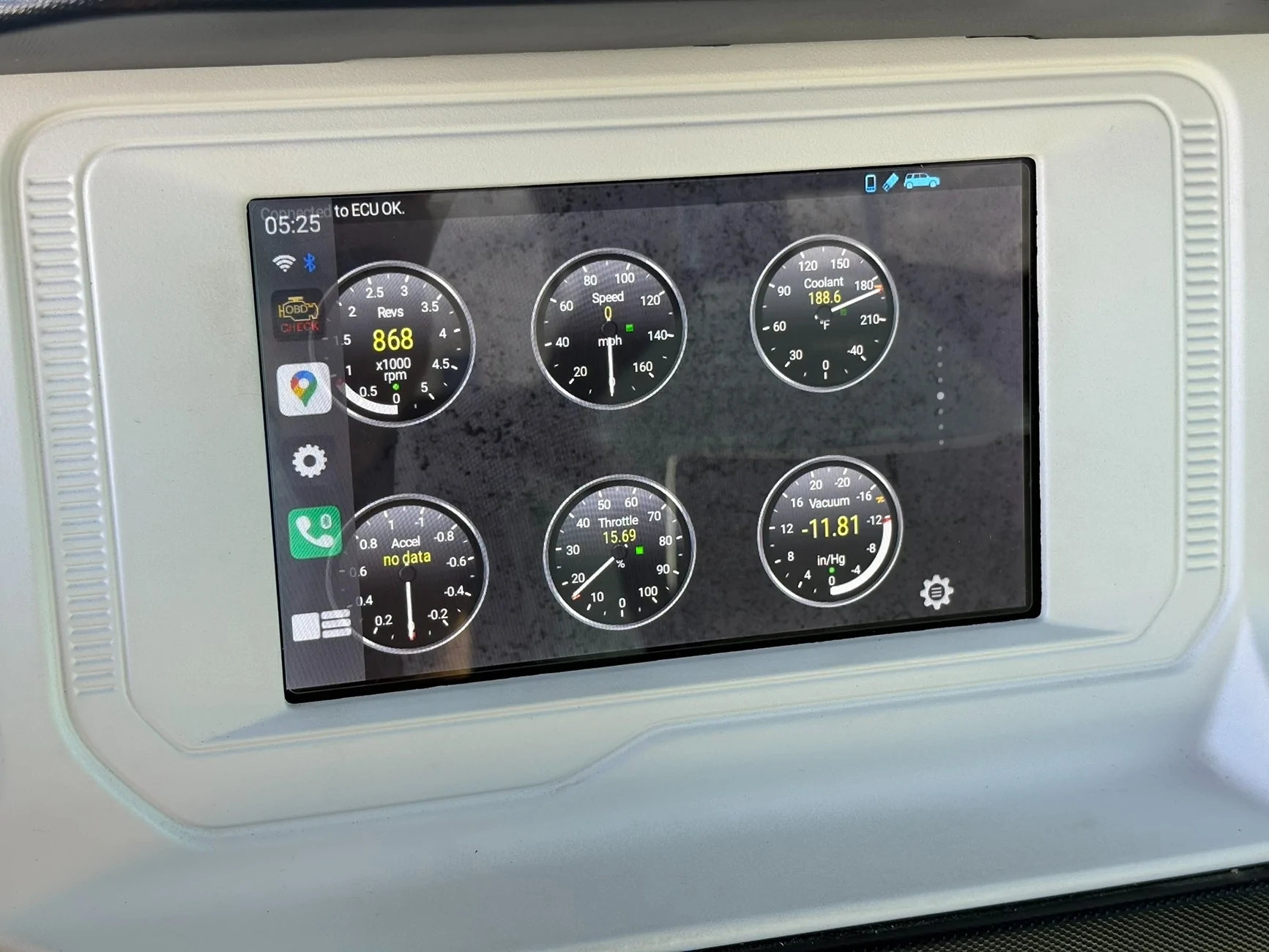

I did the same thing only display it on my dash screen. Just getting it customized now. Was wondering which gauges people find most useful.
The one thing that I like to see that I can't get on the IPC is Battery SOC, but you don't really need a real-time value while driving.
Learned Knock Mod is interesting to see, but again, isn't really useful real-time while driving. Really super helpful if you are running any sort of tune, or want to know if you'd get any performance gain out of a better grade fuel (or blending E85)
Ignition Timing Advance might be helpful if you are doing time trials or something, but as far as real time data for day to day or trail driving, not really all that helpful - just neat to know. Intake Air Temp 1/2 are nice to have for for the same reason. As is Calculated Load Value.
For Auto transmissions - the actual freakin' gear the transmission is in might be kinda neat to know
Fuel pressure may be good with the fuel pump recall going on.
Just some ideas.

Looks like you doubled the problem.

@8rent and @Murraydog11 - I did not see in the thread, what Android app is that? Those gauges are easy to read and ell laid out. I’ve tried a bunch off my App Store and many just make it seem like I’m playing Defender or something. These look automotive-oriented.
The app is Torque Pro. Costs $5. There is free version called Torque lite. It is android only. It is specifically for automotive use. Does all DTC reading and clearing as well as readiness monitoring, but I am just using it for Displaying parameters that don't have a gauge on the bronco.

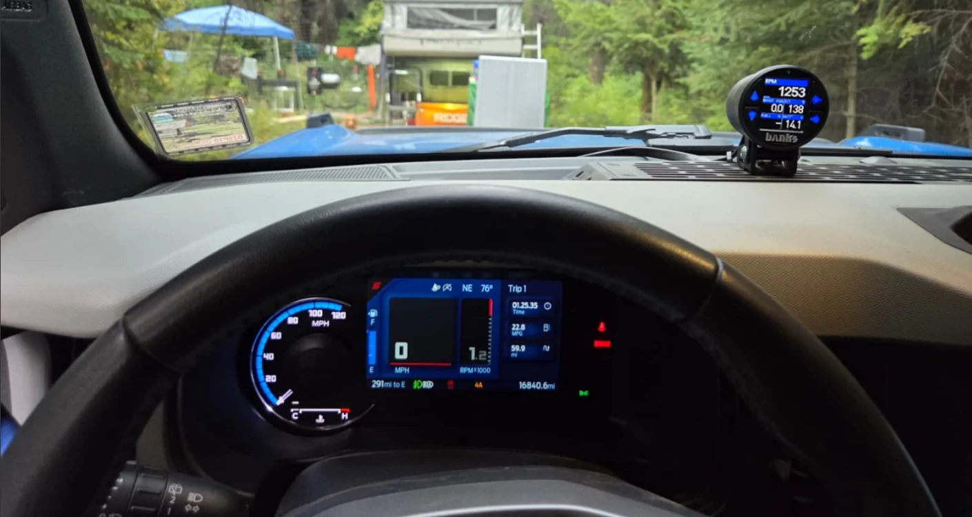

This pic reminds me. One thing I will add now that I saw the pic, and had forgotten - the reason for a HUD is I can’t see the display and scan my gauges when the wheel is turned over (airbag/horn block). So whether the OEM cluster is good or not, I miss my readings at times I can get a glance at them depending on steering wheel position. Think about it when your wheeling gets crazy and sustained.
With the right HUD setup, the other trick is to real time record values, or be able to hit “log” if things look weird.

I use a Banks iDash.
I have been studying Banks for a while, A pillar or vent mount display
- mounted left it’s natural for my eyes to quick-glance at as needed and can include logging too - but the font is too small for my vision to quickly evaluate. I have these cheap split-reader sunglasses I’ve been experimenting with off road (I’m easy to see far unaided, need vision help in close in for maps and gauges until my eyes adjust) and it’s a step in the right direction. For one number BIG I’m all for digital. But I’m leaning towards analog for and array of readings.
If your eyes are that bad, you need to get prescriptions.
I wear progressive lenses and have an astigmatism. I can read everything just fine, but slightly fuzzy without the glasses. Text is nice and crisp with them.
The nice thing about the dash mount I used is I could move the gauge to where it was ideal for me. The pod mounts on the A-pillar are a fixed location. The one in my F350 was just a bit off for me, so I ended up making a custom mount for the dash.
