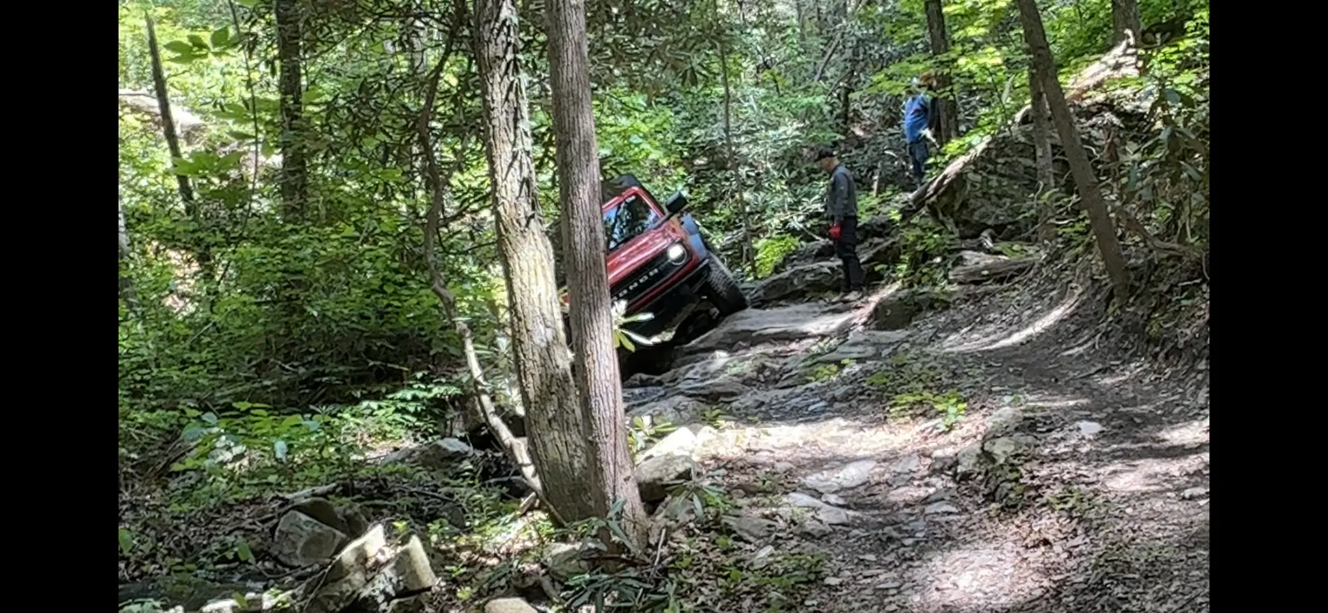

I am going to define two terms before I try and answer (defined only for my use here - not correcting anyone).
Inclination I am using as forward and backward.... It depends on your center of mass.... If you start getting your center of mass behind the rear (or front) tire patch is where things will start to get dicey. How high is your center of mass and how long is your wheel base will be significant factors.
Off Camber I am using for my side to side tilt. Again depends on your center of mass height and the width of your vehicle. I am wider and taller than most and I have been in the high twenties with out problem but when getting over 30 it starts getting really tippy....
this can give you an idea of what it is like inside when getting close to that limit... I am pretty sure I got on two tires on this one.

EDIT: Odd it is telling me post may have been removed when it is still there for me.....
I was able to watch it but does say not available.
Pretty tippy there, 😆
