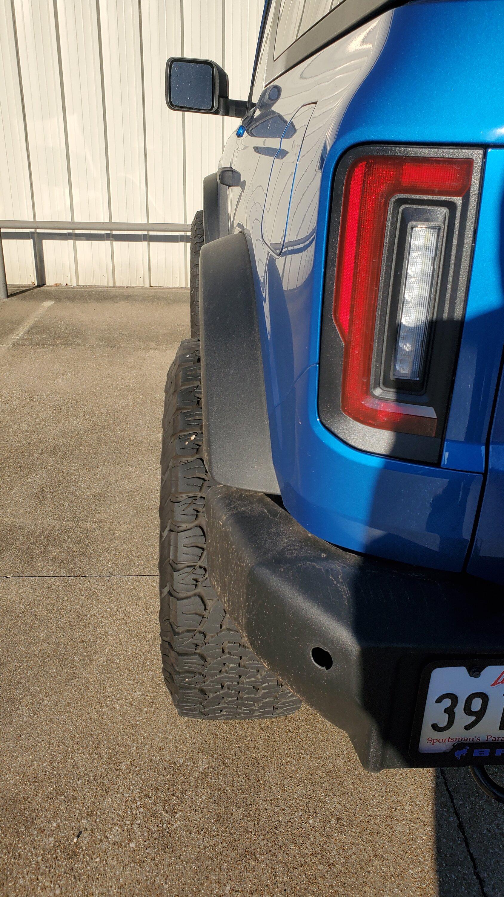

Thats gonna poke out a good bit. Possibly interfering with crash bars when turning. Mine are 295/70r17 with -6 and just slightly rubbed the front bars. 275/70r18 will be a little skinnier than mine but fairly close in diameter.
