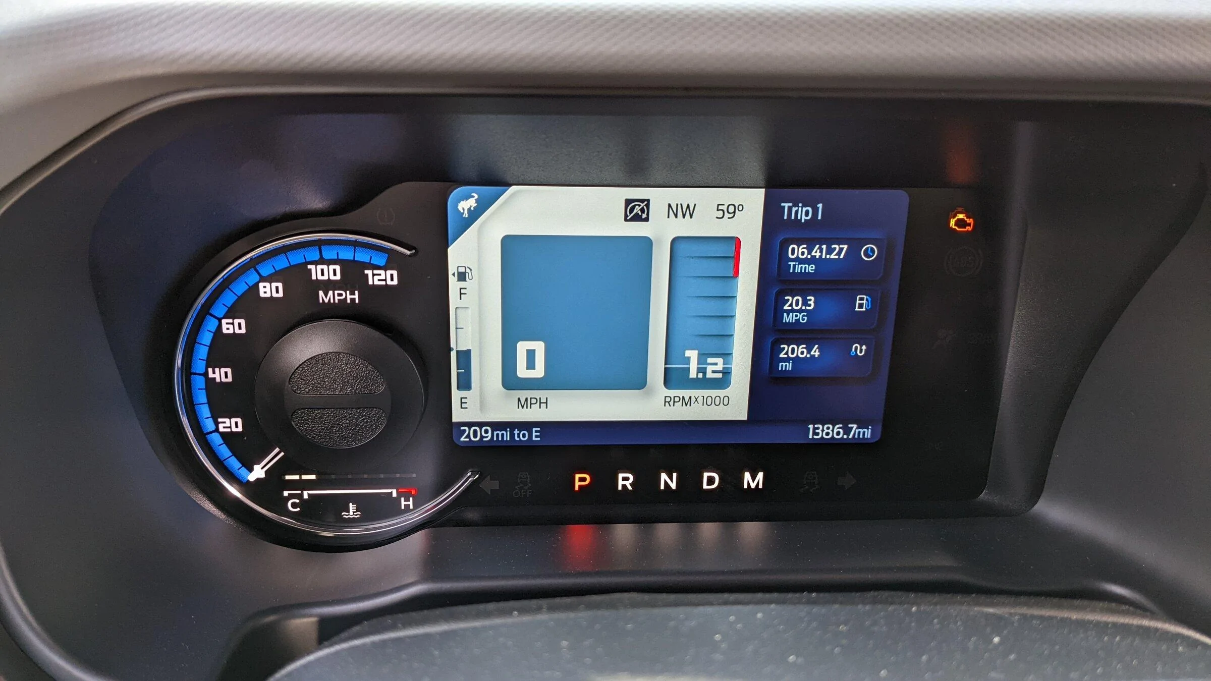

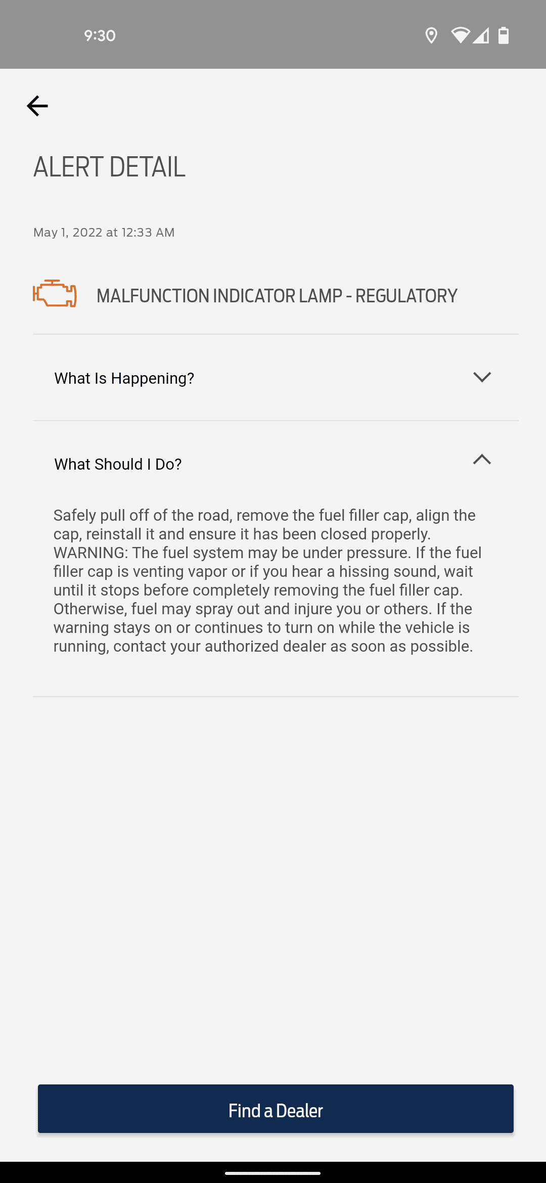

I checked Ford Pass. The Check Engine Light says Fuel Cap issue but Bronco does not have Fuel Cap. Is it a false positive error?
