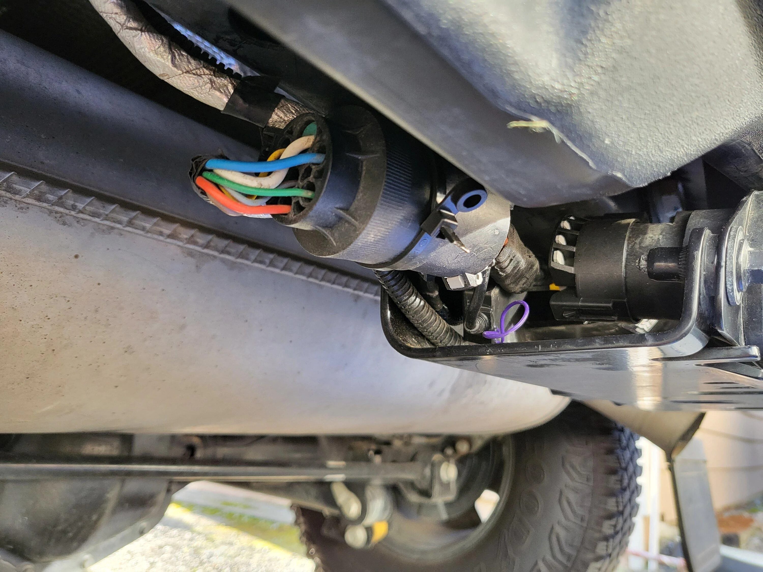

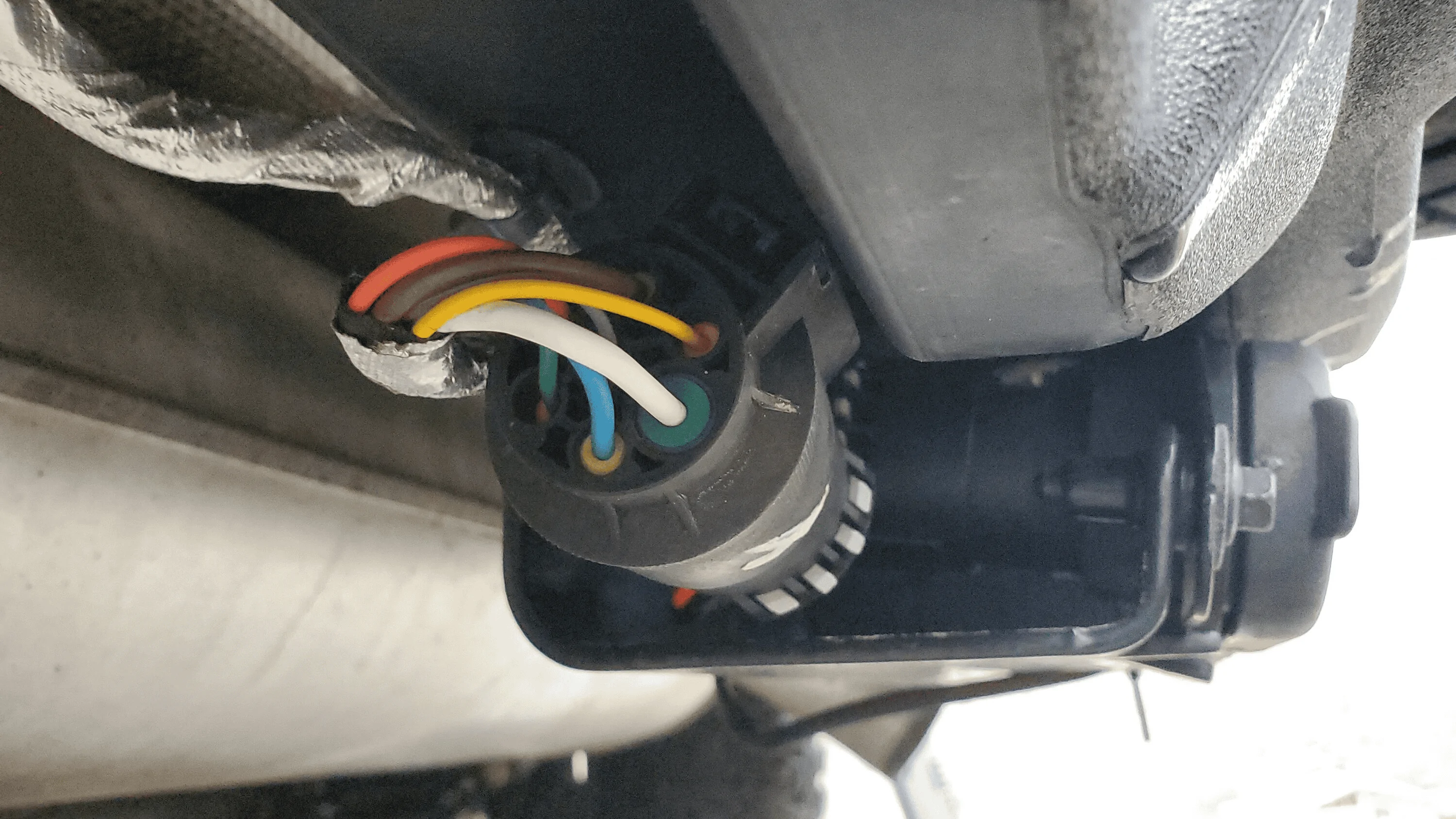

Someone just posted this photo. Seems to work just fine...

Yes mine worked out the same way. Zip tied to be safe but can’t see harness from behind vehicle. Just undo 10 mm bolt and makes easy. Unfortunately I had one of the first ones with resistor but now cut and will test tomorrow but in first startups, tow / blis issue didn’t light up.

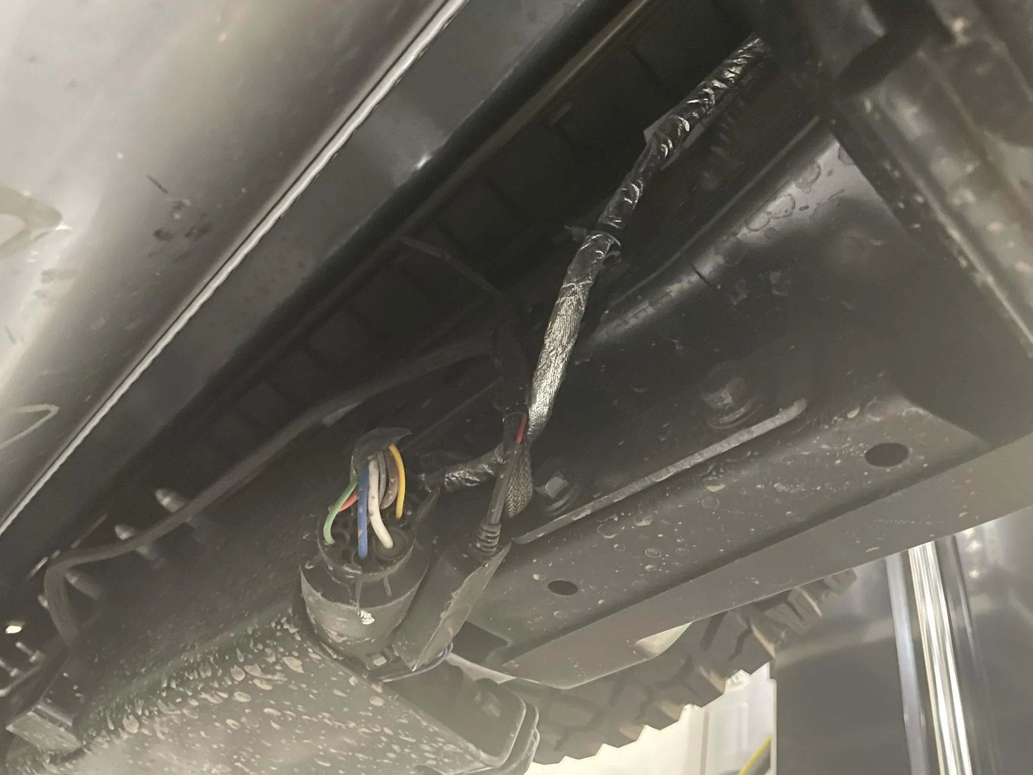

Did it and worked great. Definitely need to remove bolt to get better access. Got a longer zip tie.

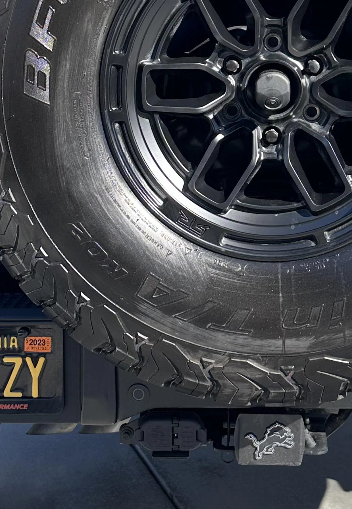

Doesn't work the best for the Bronco Raptor. The Exhaust actually exits very close to the location where it pokes out. Gave mine to my brother in law for his RAM. I may have to think of some shielding and try again... @4x4TruckLEDs.com do you have any more C1R's in stock?

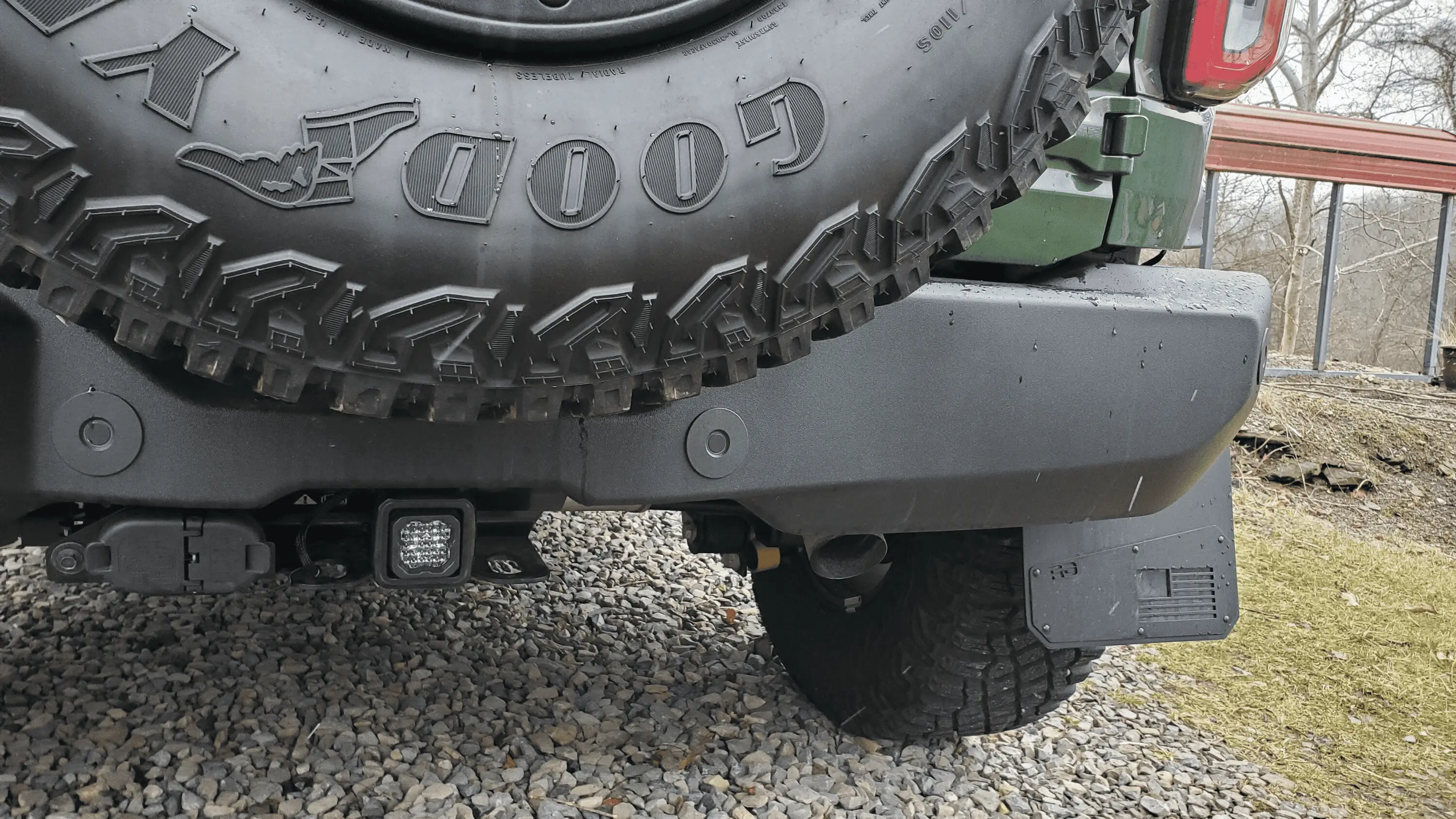

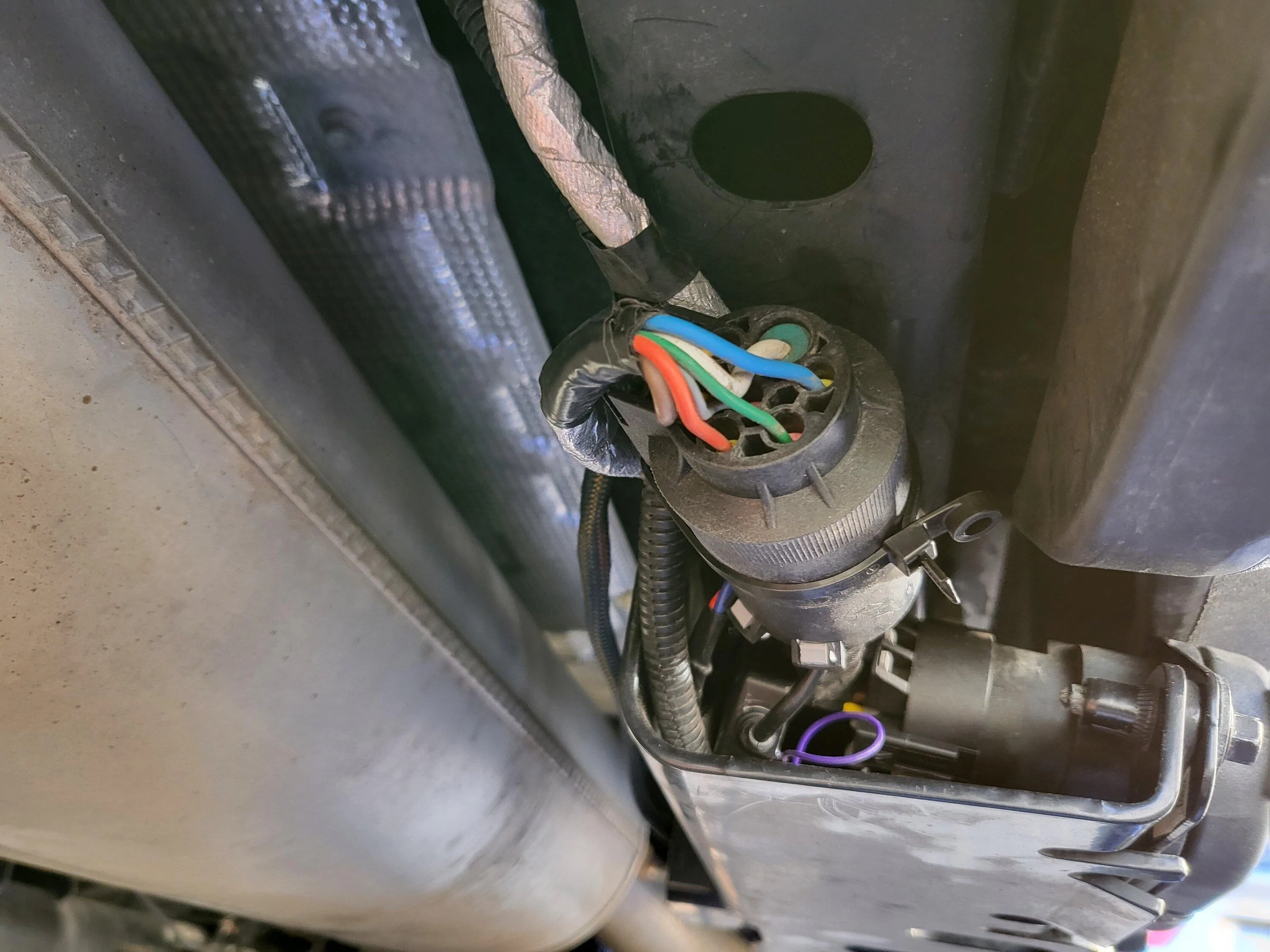

I received it earlier in the week and fought over a few days to get the wiring to fit. Finally got it today, but I don’t love the way I had to leave some of it hanging out instead of nicely tucked out of sight. I’ll revisit it at some point. I’m very happy with the light and function.

No one can see it. Enjoy the extra light

That looks like a Clean install from your pics.
