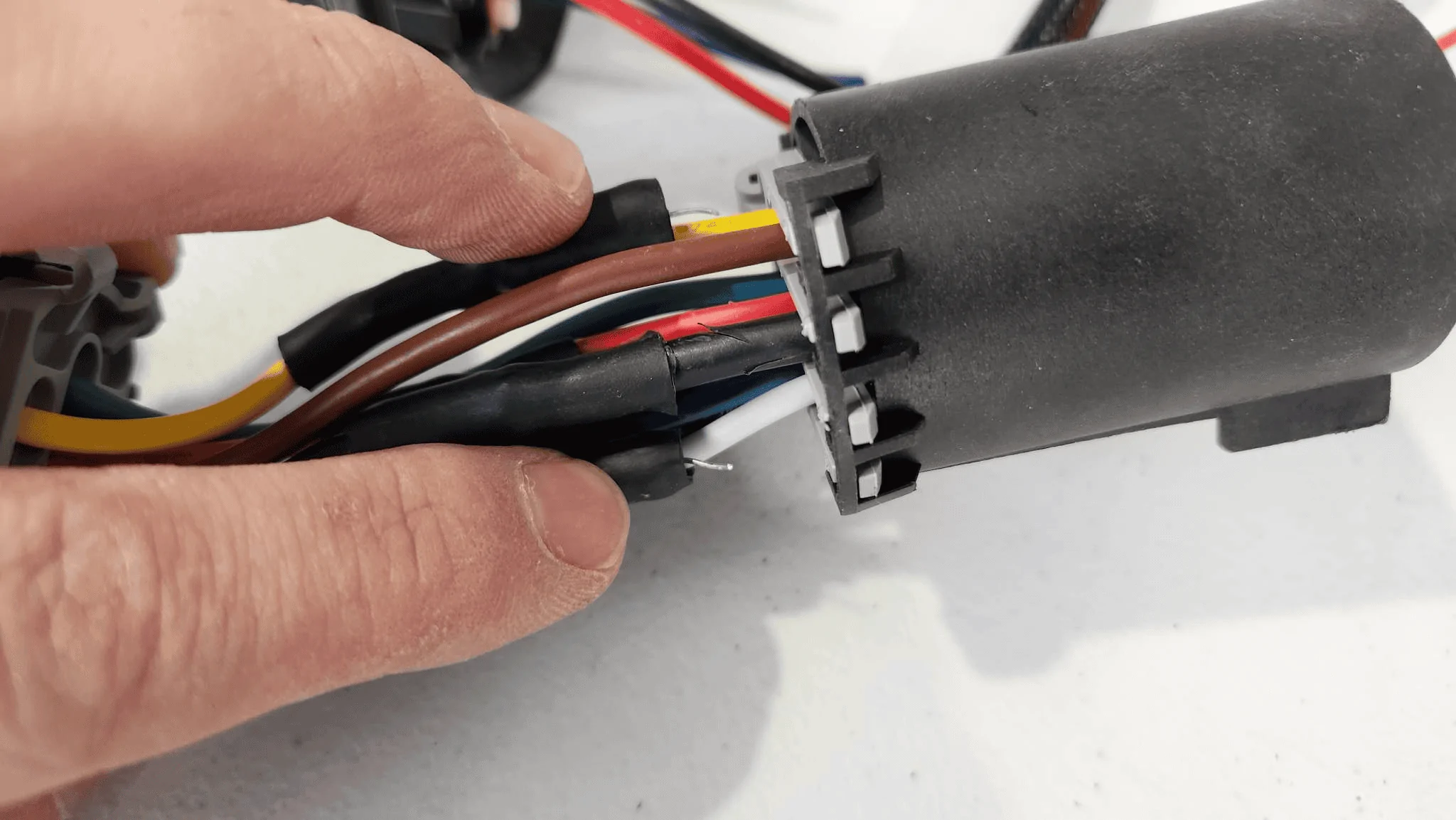

For those who have received these from us your truck MIGHT think a trailer is connected. This a known issue by Diode Dynamics and they are fixing all future kits. It's a VERY simple fix if you already have your kit.
1) Remove the black tape on the trailer harness
2) There are 2 resistors. One resistor goes from BLACK to YELLOW and the 2nd resistor goes from BLACK to WHITE. Look for these
3) CUT the resistor wire (it's the exposed metal wire). I recommend cutting it FLUSH with the resistor/wire.
4) Re-tape your harness
That's it.
Basically Diode Dynamics installed 2 resistors on the harness which don't work on Ford vehicles, as the Ford trucks think a trailer is connected and will disable your cross-traffic alert system.
If you don't do this the Hitch Pod WILL still work, but your cross-traffic alert system will get disabled. So simply cut those 2 resistors and it'll fix the issue.
We tested this in-house AND Diode Dynamics tested this in-house also (they provided us the instructions to test on some additional Ford trucks like a Lightning).
Here is one of those resistors shown with the wire still sticking off (cut it flush)

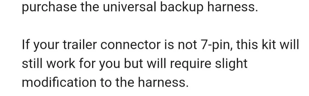

This was in the original post for these lights, I took it to mean it can be used with a 4-pin connector. Am i reading it wrong?

I'd say you read it right but Diode Dynamics wasn't AS CLEAR as they should have been.
You'd need to get a 4-pin trailer harness and then cut the 7-pin diode harness and splice it into the 4-pin to get it all to work properly.
Not quite sure what "slight" modification they expected, but there's no other way I'd see it as an "easy" solution

Yea that's not gonna happen. Thanks for the info.
