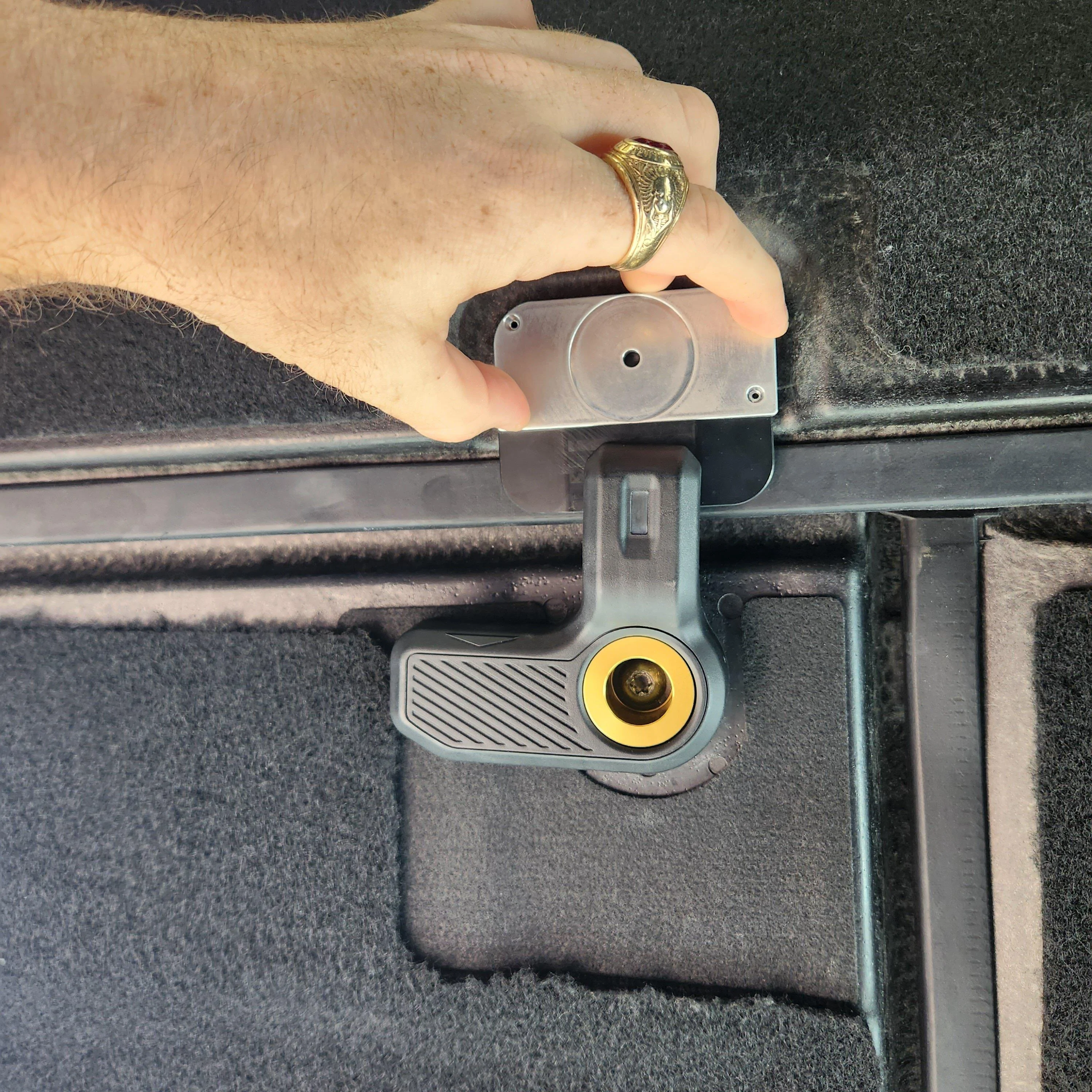

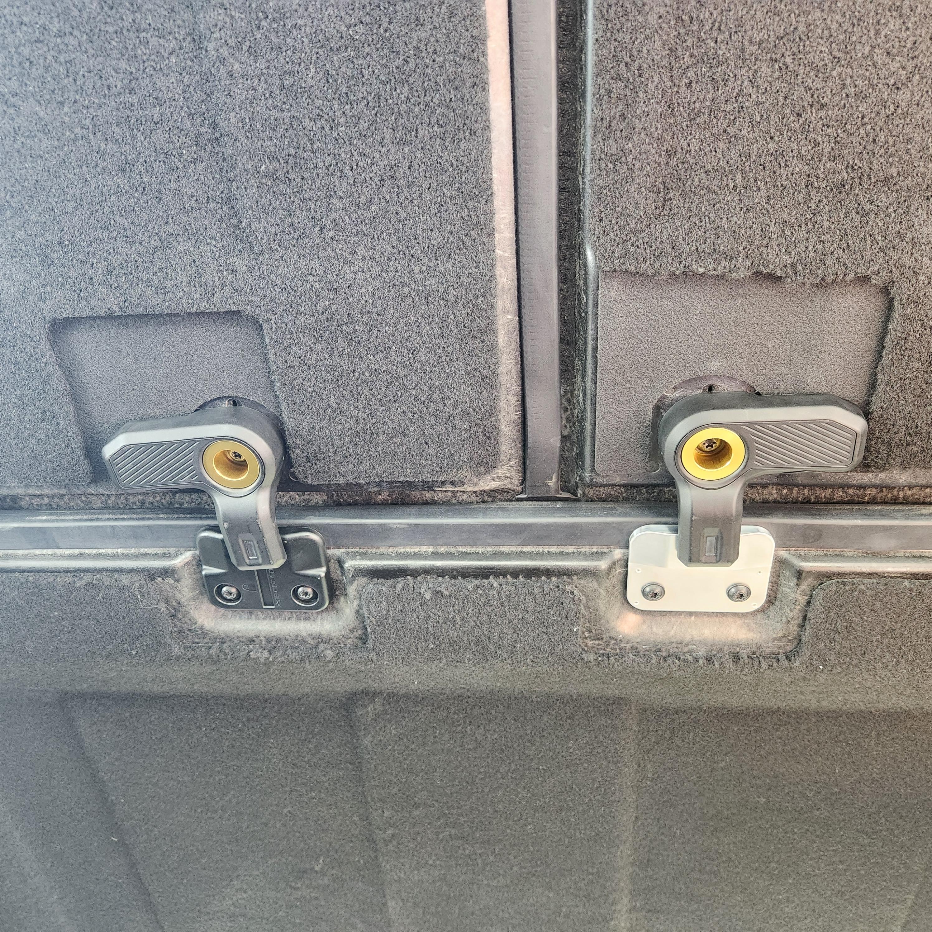

Of course!
Keep in mind these pictures are earlier prototypes I am saving final product pics for launch day.
Ford Bronco [New Product By ModCrate!] Modular Latch Plates 20230607_105700
On the left is the OEM part. On the right is my version.
Ford Bronco [New Product By ModCrate!] Modular Latch Plates 20230607_105829
The latch plate I am holding will be swapable. Ill have functional adapters for various accessories a decorative plate if you prefer no mounts. I even have a cabin light planned.

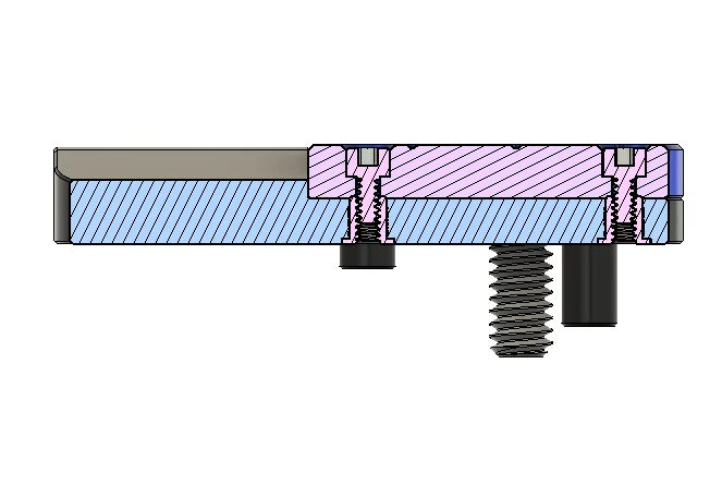

interesting. Becasue its delrin you probaby already thought of the threaded insert coming from the back like a T-Nut, but for plastic - so the threads dont spin and strip out the threaded insert ridges over time
I did yes. I tried to avoid it because fasteners are surprisingly expensive. In the end the exotic plastics were just too expensive.
Ford Bronco [New Product By ModCrate!] Modular Latch Plates Sectional Cut
The color schema might not make the most sense for separating parts but its set up for how I work. The light blue hatch is the delrin rub plate. The pink 25 degree hatch is the adapter plate and the pink 45 degree hatch is both the insert and the bolt.

Pretty cool idea and way more reasonable than those guys who want to charge $600 for an accessory rail.
