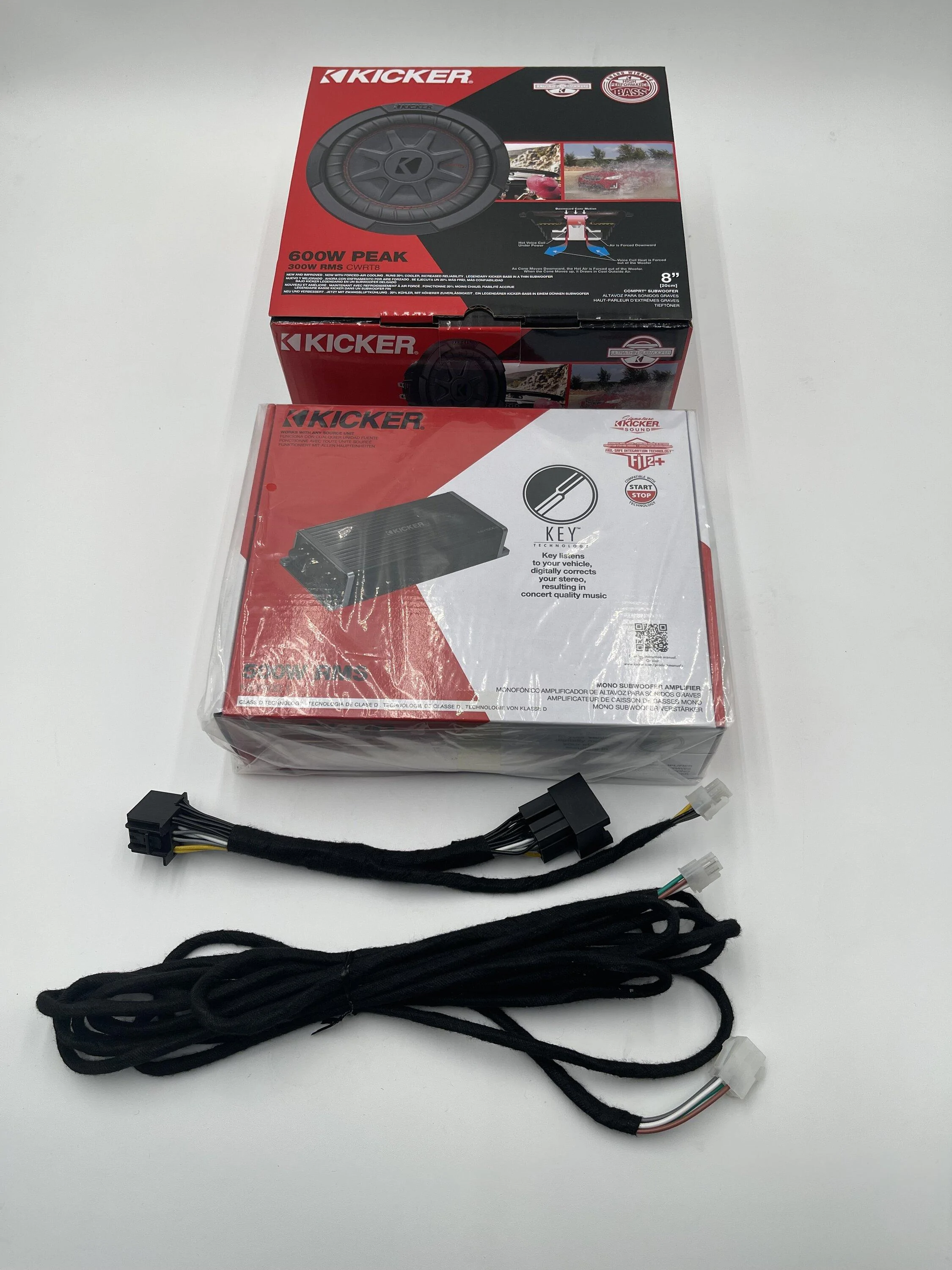

I just want to share that there’s been a few more packages updated for adding a 8 inch kicker comp subwoofer to your existing factory enclosure . We have now added package L which comes with the kicker key 500.1 300 watts @2 ohm with plug & play harness and kicker 8 inch sub . $499
Ford Bronco NEW PACKAGES FOR ADDING 8 INCH KICKER SUB IMG_6256

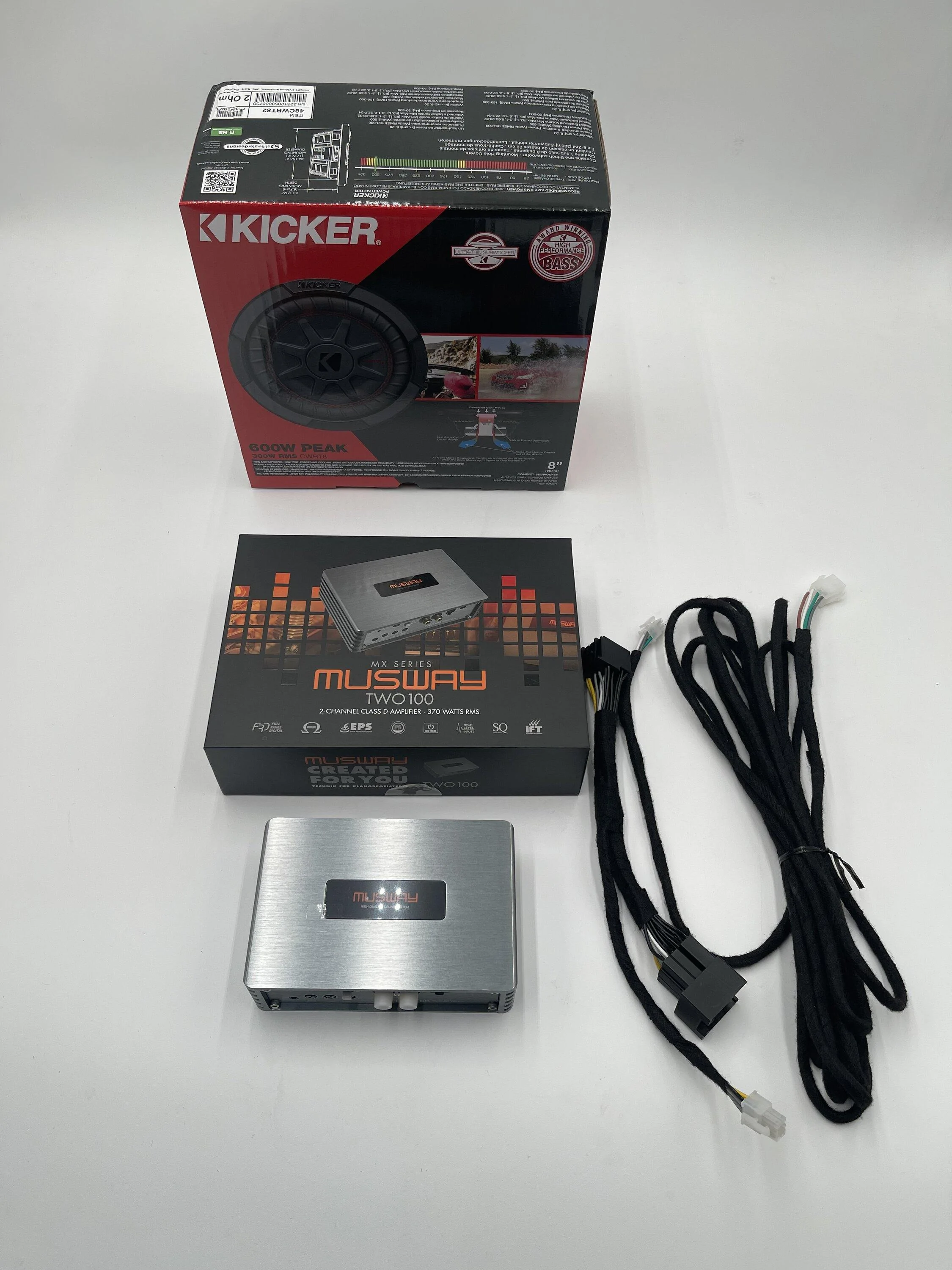

Also we have package M with musway two.100 amp 370 watts @ 4 ohm bridged , more power than the kicker key and the amp is the size of a iPhone easily mounted next to the subwoofer enclosure $499
Ford Bronco NEW PACKAGES FOR ADDING 8 INCH KICKER SUB IMG_6255

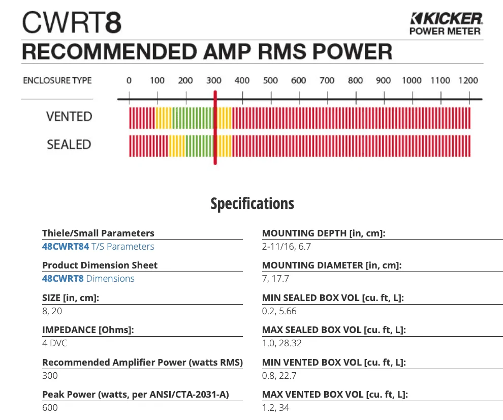

Sorry for the rookie question…
But does package (M) Amp make the
“8 sub louder ?
Depends on the subwoofer, how you tune the amplifier.
If you have an underpowered amplifier, then your volume will be low and the audio quality may sound like garbage. BUT... there is a point where the amplifier is capable of pushing more power than the subwoofer itself can handle, and you'll end up blowing the subwoofer.
Typical amplifier recommendations for subwoofers:
  • 6.75" Sub - 160 watts
  • 8" Sub - 300 watts
  • 10" Sub - 400 watts
  • 12" Sub - 500 watts
Just check the subwoofer manufacture's specification sheet. They will usually list a recommended power rating. Example from Kicker's website for the CWRT8 below.
Both of the kits listed above are great setups for the subwoofer he is bundling them with.
Ford Bronco NEW PACKAGES FOR ADDING 8 INCH KICKER SUB 1694354695500

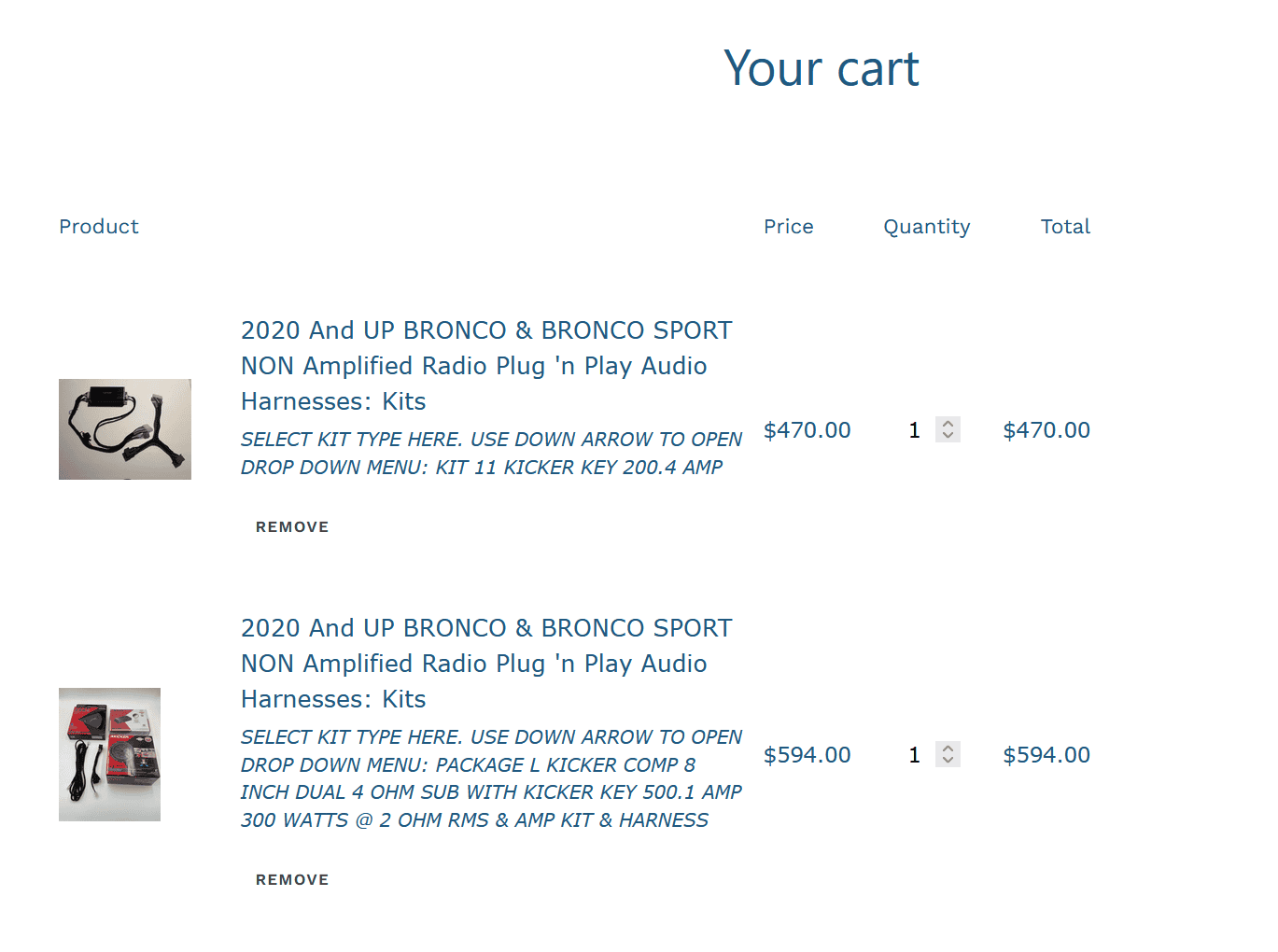

I need a 200.4 amp, a 500.1 amp, the 8" Sub, the amp install kit and remote bass control, along with your plug and play harness(es) @plugnplaykits. Not sure how best to order all that from the dropdown menu on site. Also not sure if the pnp harness is just for the 200.4 or there's another for the 500.1?
I've already replaced all the speakers with Kicker and not getting the depth of sound I want.
I think this is the bulk of what I need, but don't see the remote bass harness. Possible to add?
Ford Bronco NEW PACKAGES FOR ADDING 8 INCH KICKER SUB 1695073979524
