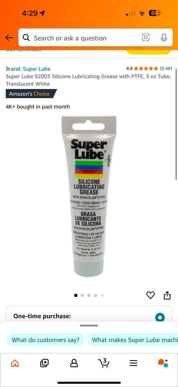

I had the same issue, apply this stuff to all the hardtop seals and lt will disappear
