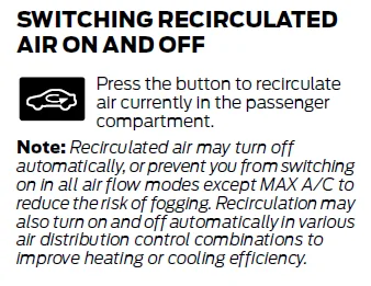

@flip is correct in that it does fluctuate. It was driving me nuts after I did a road trip this summer so I started digging in the manual and found this quip:
Ford Bronco New Bronco, a few concerns. Screenshot 2022-07-10 052638
Now the thing that puzzles me is that on long drives the recirculate stays lit though you can tell it shifted to outside vent. I'd do a quick double tap on the button and it would go back to normal.
Now during my daily use, every morning I will put it on recirculate and will notice that it switches and I look down and the recirculate light is off. Don't know if there is a reason behind this or if it's just gremlins in the system which seems to be common.
