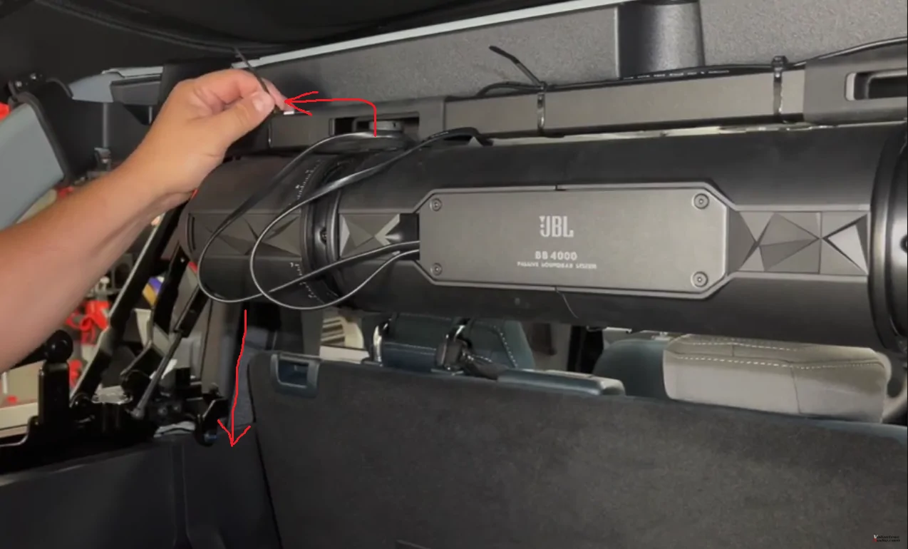

Since the sound bar has excessive speaker wire I am thinking that I can tap right into that, and run it to the trim panel and then down to the amp which will be mounted right below the sound bar. Since I will already have the back driver trim panel off to get to a ground spot, I can run it across the top of the sound bar and then behind that panel with minimal effort. Pic snapped from an install video, not my Bronco, but the wires are the same.

I did reach out to Rockford and they confirmed their high level input would work with the factory head unit and would also enable the remote turn on.
Thanks again for all your help! It gives me greater confidence I can do it without too much issue.
