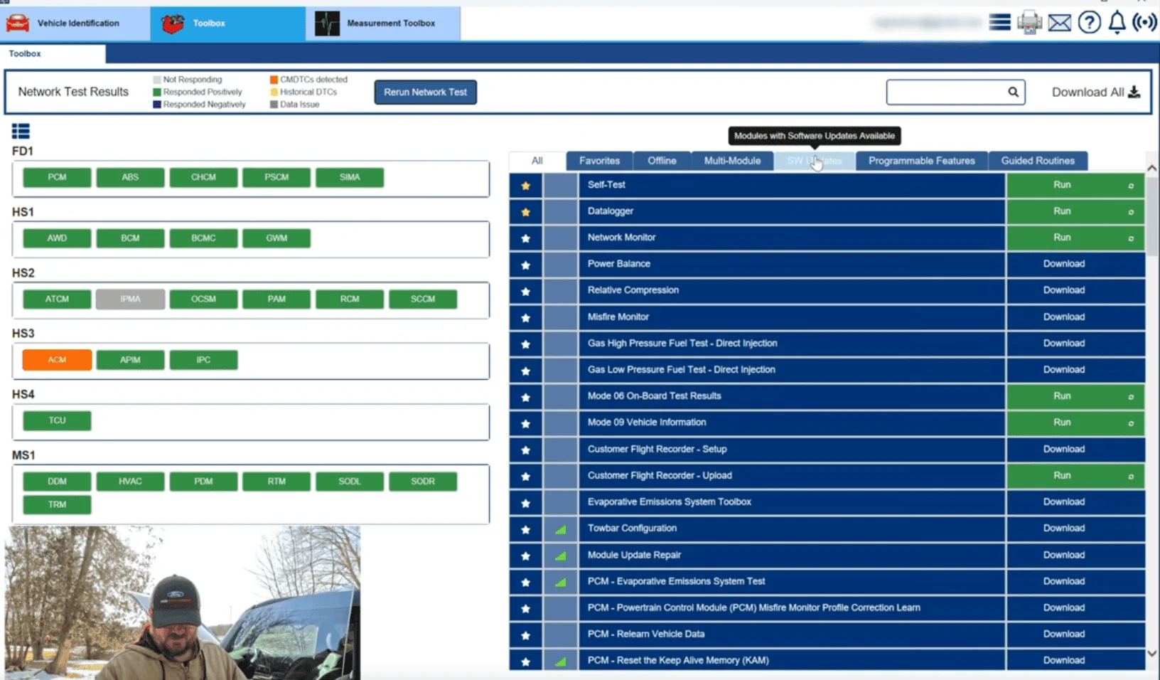

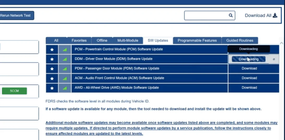

Yesterday I had my dealership plug in FDRS to my 2 door *july '22*(SASQ LUX Badlands), and in the Toolbox opened FDRS software update column he specifically looked for DDM and PDM updates and could not see any listed.
**** I gave him the pics bellow so he knew what to look for***
So I'm in your camp, with a 2door with NO .... PDM DDM updates. Thus have to live without this key Fob (window slightly down) when unlocked.
Not happy!!!:(
****Pics are of a 4 door where the DDM AND PDM UPDATES do actually show up.****
ARE THERE ANY 2 DOORS WHERE THESE FDRS UPDATES ACTUALLY SHOW UP!!!!!
If so, tell us the secret to your success. (maybe ....year/month buildate... options... maybe that is the determining upgrade factor for the 2doors????)
INQUIRING MINDS???
