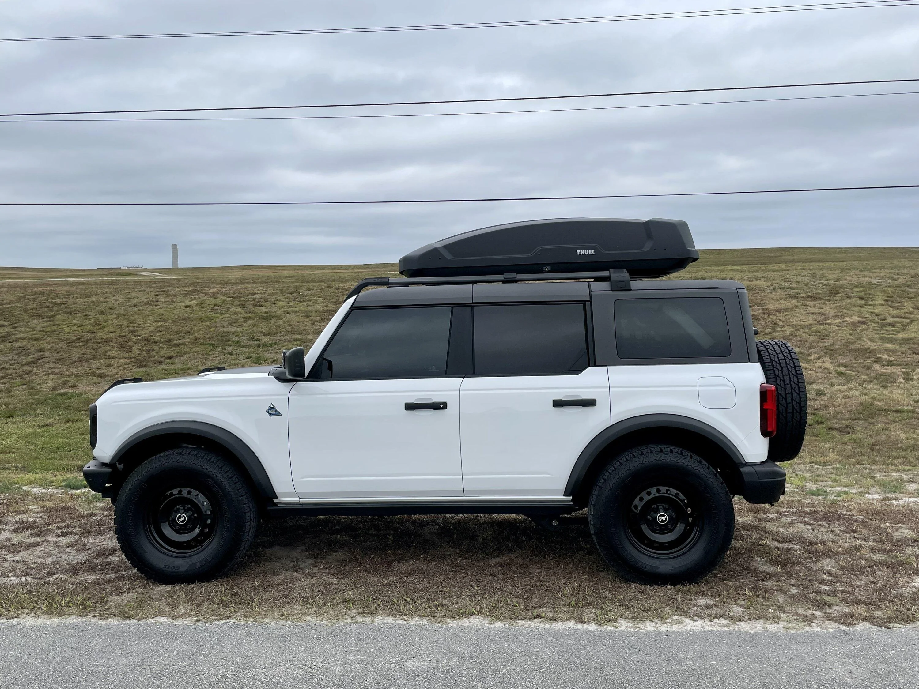

I have an MT Black Diamond with the stock steelies. I have Yokohama Geolandars in 285/75/17 with absolutely no mods. Currently, this is what it looks like:

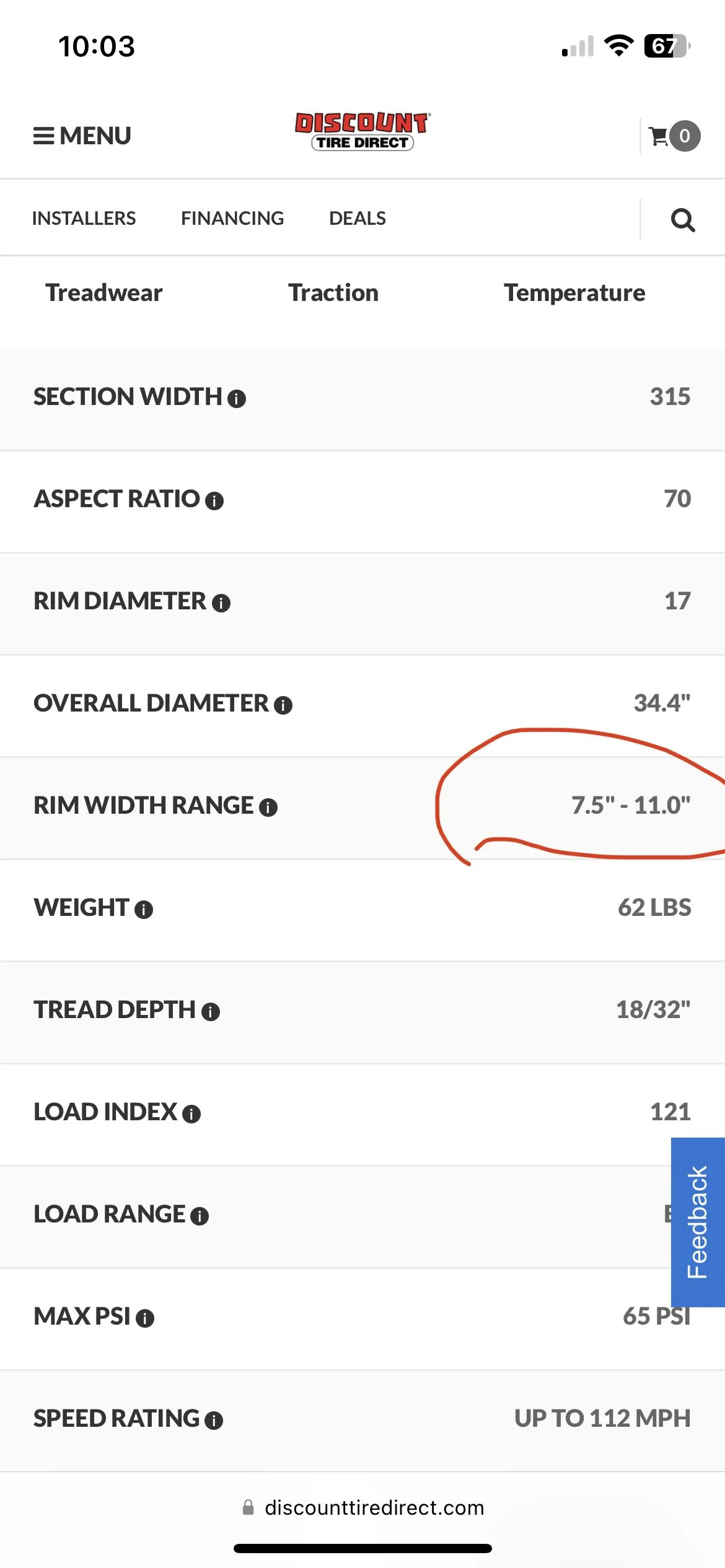

The 315s require a minimum of 7.5

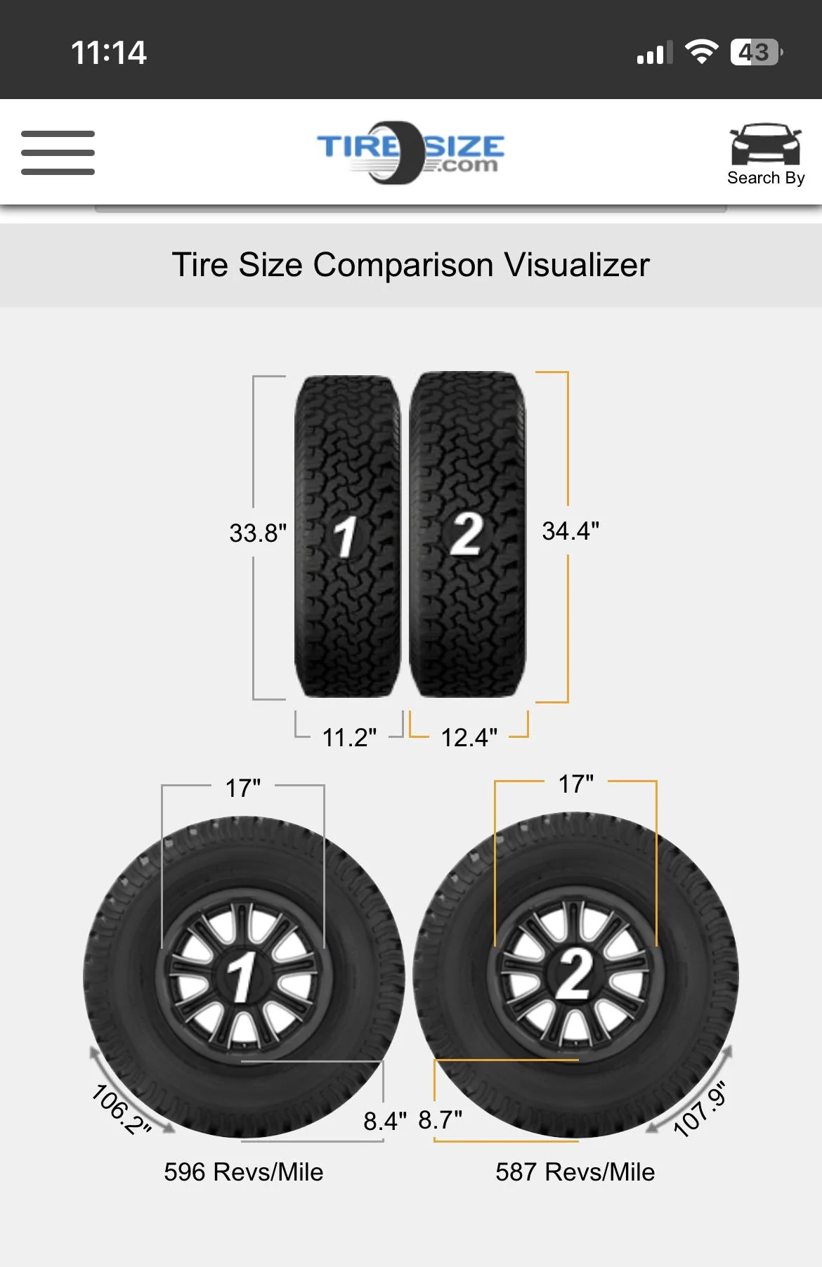

The size difference between what I have (285) and what I want (315) is negligible, except for the width:
Is it safe to assume that the 315s will fit with no problem and I should be able to just get the tires, mount them on my Bronco and drive off? Or is the difference in width going to cause some rubbing on full turn even at no compression?

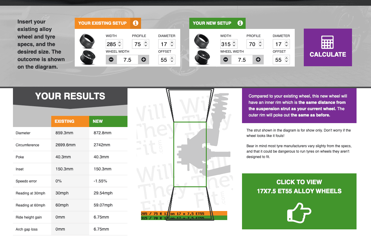

Type in all your info into this website.
willtheyfit.com. I found this site invaluable.
