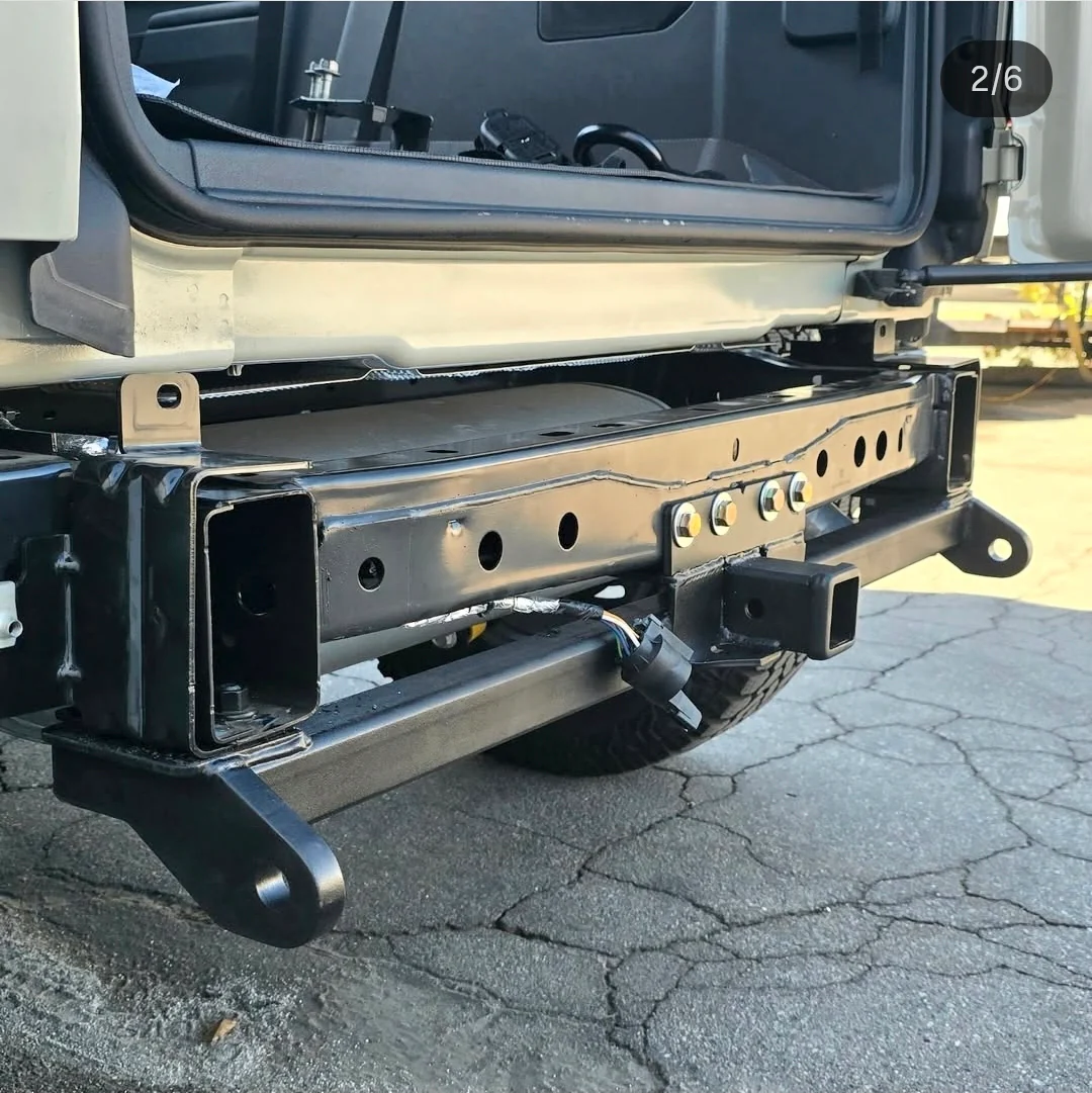

I found a heavier hitch that is great for anyone who wants a bit more safety or just less flexing:
Ford Bronco Need help with hitch dimensions HK Off Road frame mounted hitch

^^ while that thing certainly looks beefy, it begs the question, if you need a hitch like that why in the world did you buy a Bronco ?

Long story. Been driving the F250 crewcab for the past 17 years. Personal vehicle also used for taking the dirt bike to the forest. Slight overkill for what I used it for and also an increasing pain for parking. Bought it because I always had pickups and I could order it with a stick.
Fast forward to today and I still want a stick. Not many choices left, pretty much the Wrangler or the Bronco in order to get a stick. Other important consideration is that I also want an upright windshield. I can't stand banging my head on the window frames while getting in and out of current vehicles with sloped windshields.
The reality is that I specifically do not want to do any towing. Hence the dirt bike carried across the back of the vehicle. At 170 lbs that should not be a problem. Like you say it's not about capacity, it's really just a problem with the crossmember. I think the stock Bronco hitch can do the job, I just don't like the flexing. But I can also reinforce the Bronco like that heavy hitch does.

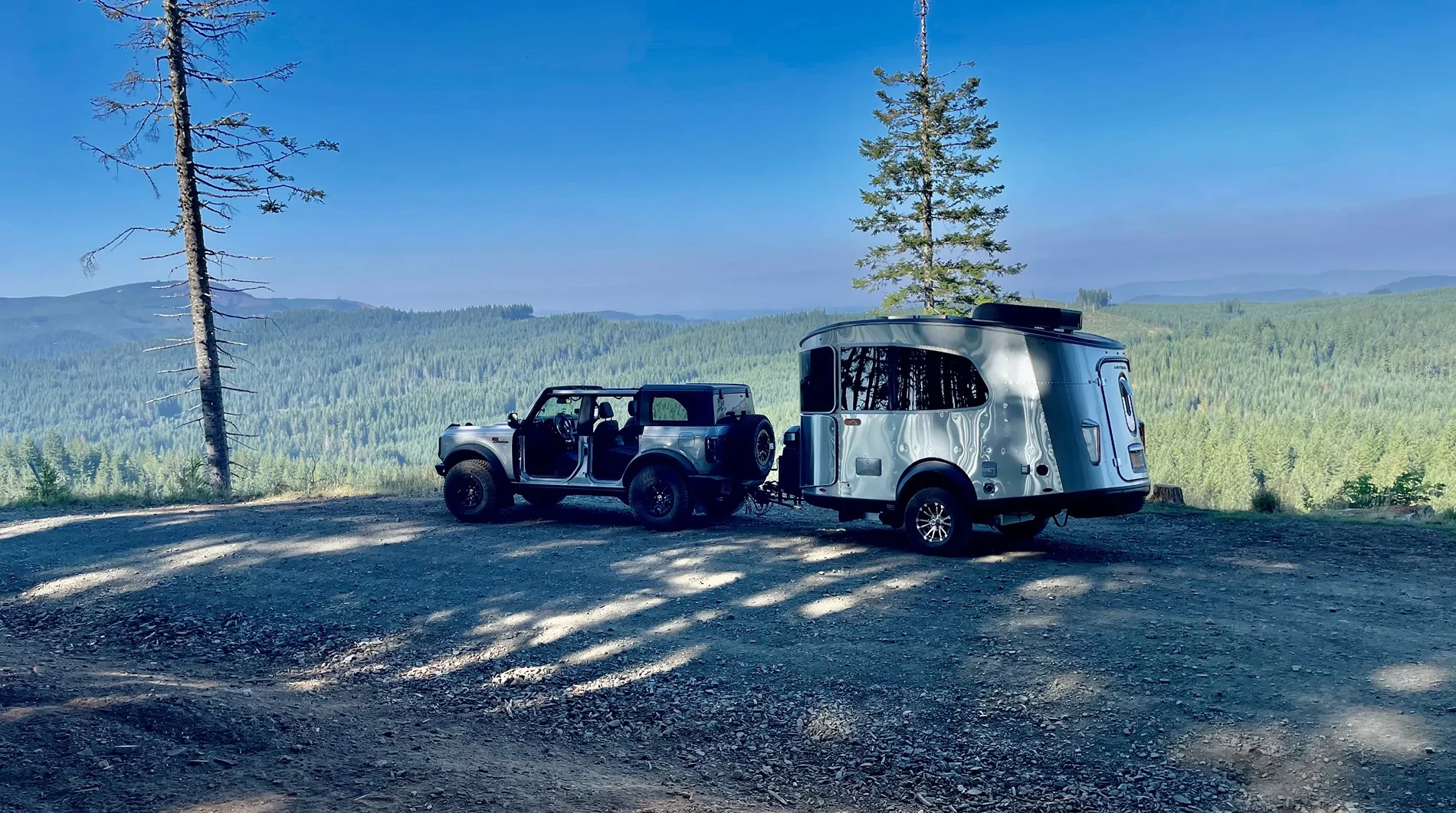

I have a 2.3 MT and own Bo-Flaps. Also tow thousands of miles at the limit with an Airstream behind me. Over 400LB on the hitch.
