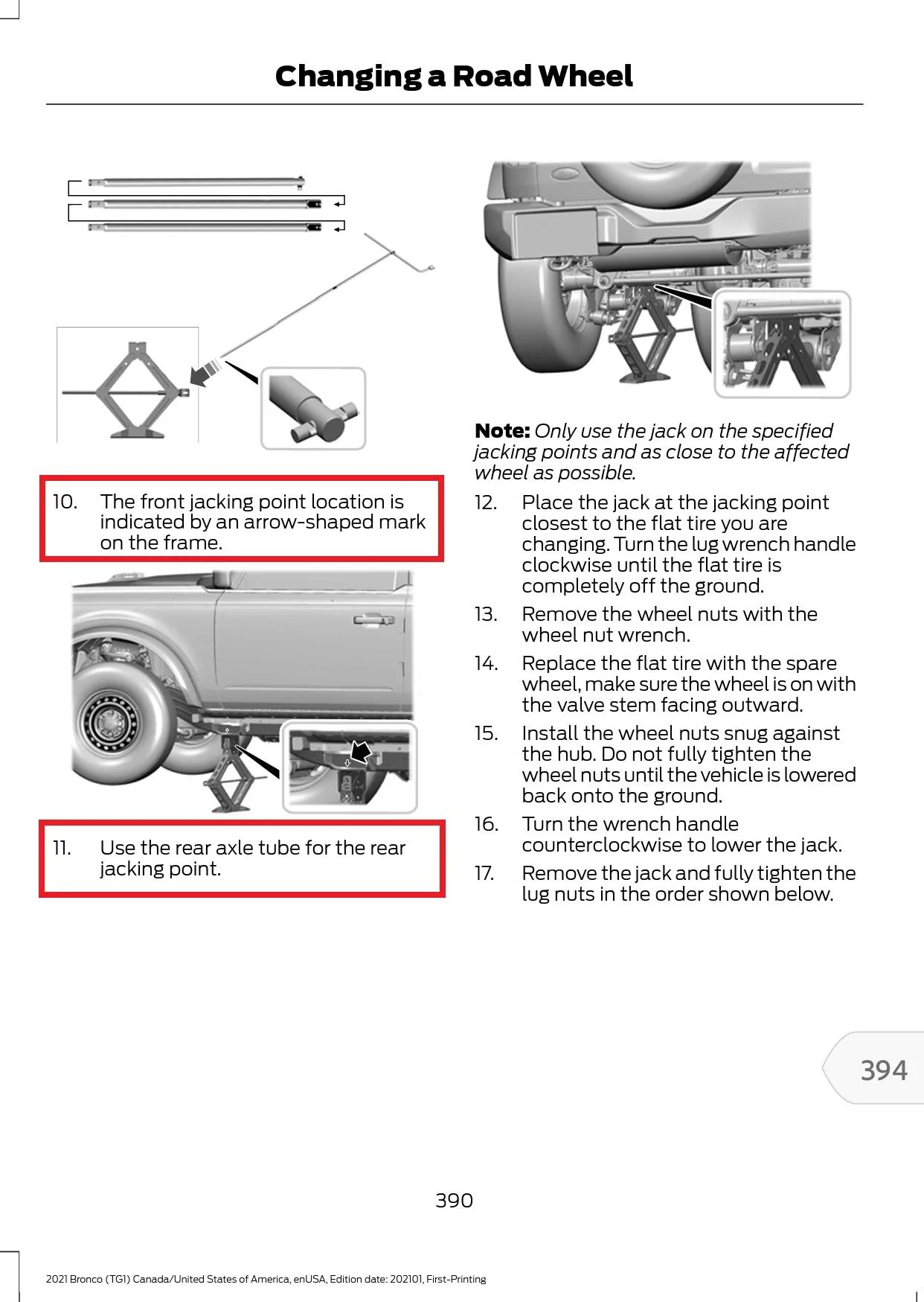

The jack point right in front of the the back axle along the frame wasn’t cutting it for me so I just jacked it up on the differential and used jack stands on the axle with no issues. Thanks for all your input I appreciate it

FYI, the Owners Manual recommends jacking from the arrow shaped mark on the frame in the front and from the axle tube in the rear...
Ford Bronco Need advice on floor jacks Jacking Points - Front and Rear

Thank you for this!
