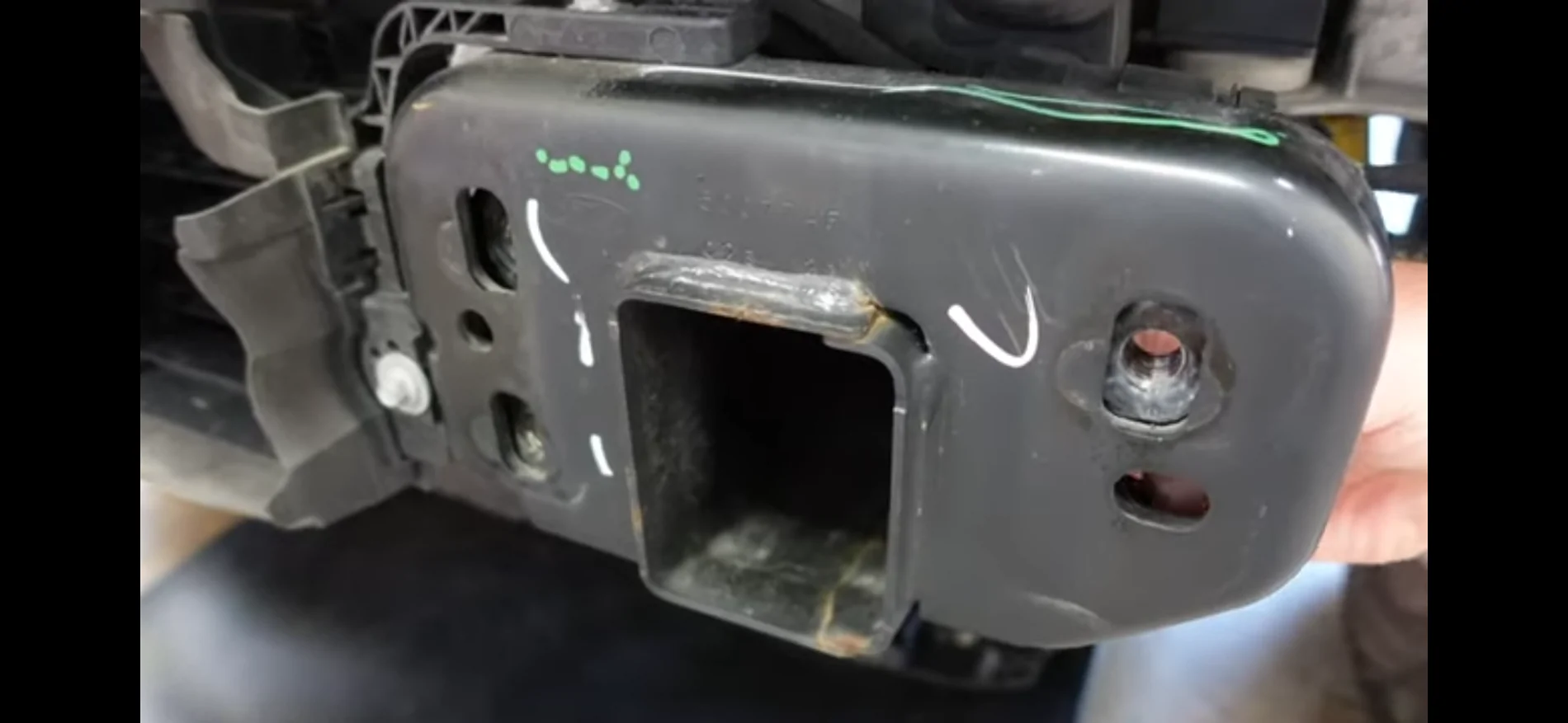

Here’s a picture of the bronco frame horn. Ford uses three bolts each side.
You need to see the backside of the bumper you want and see if you can drill different holes 1.5 inches up/down…
Or need to fab plates
