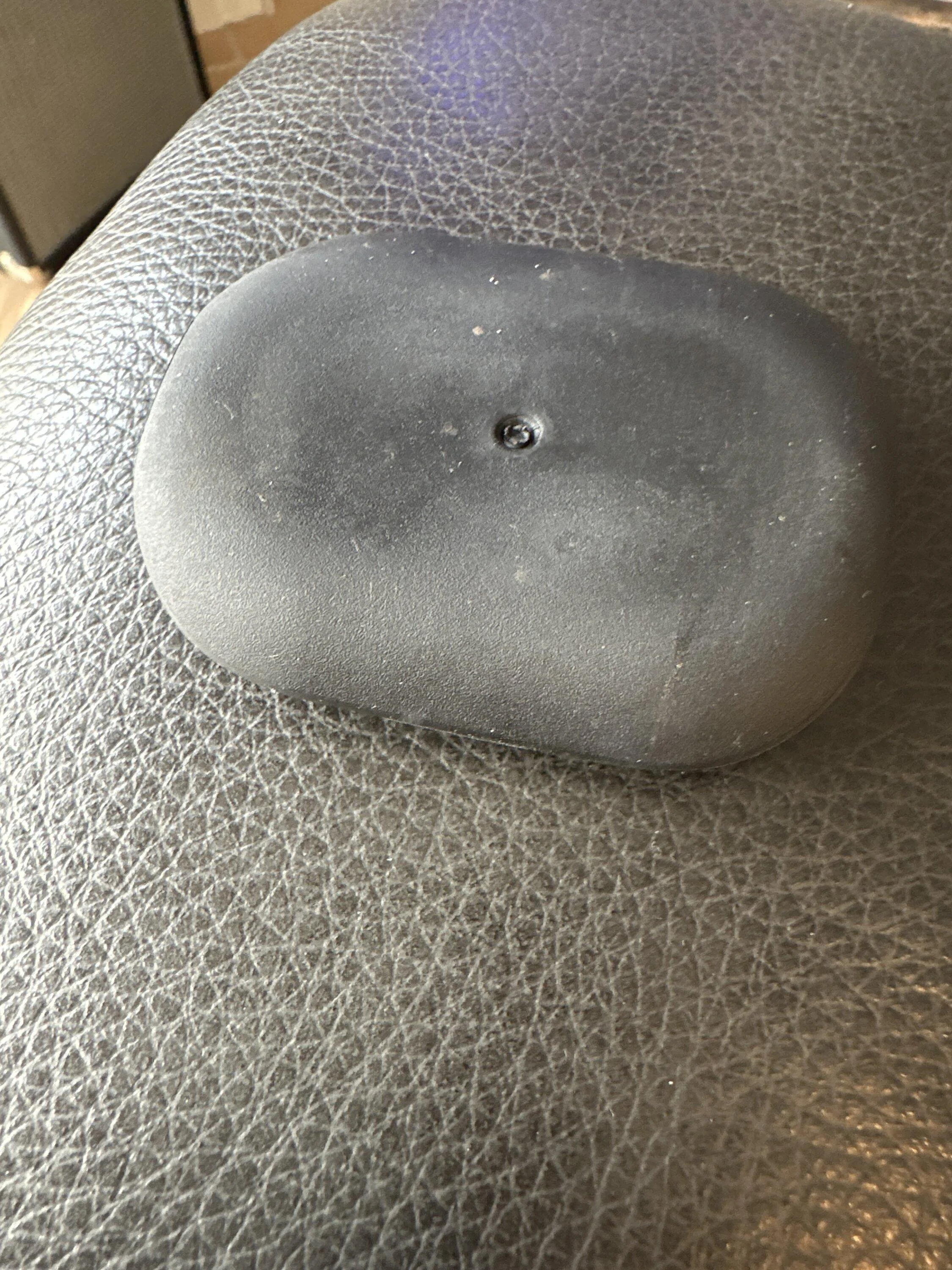

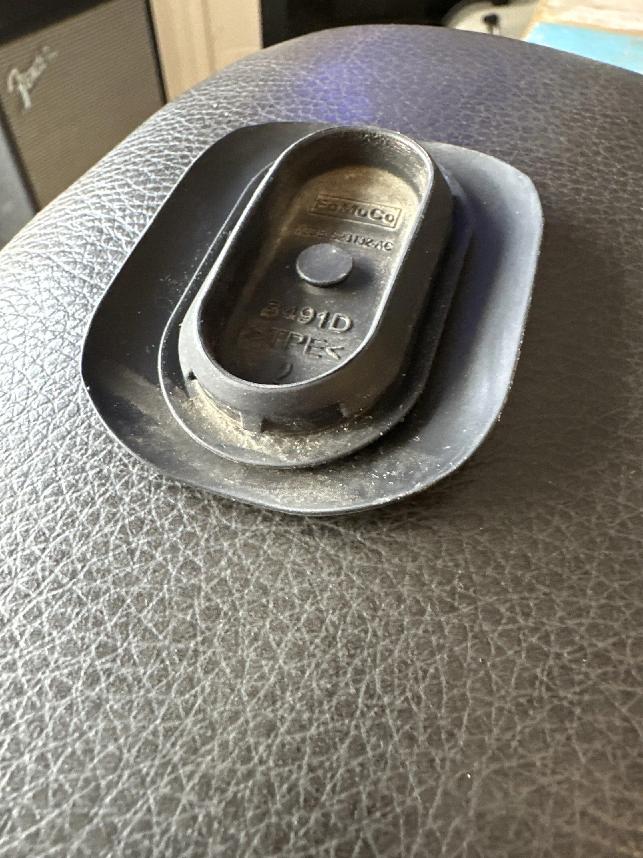

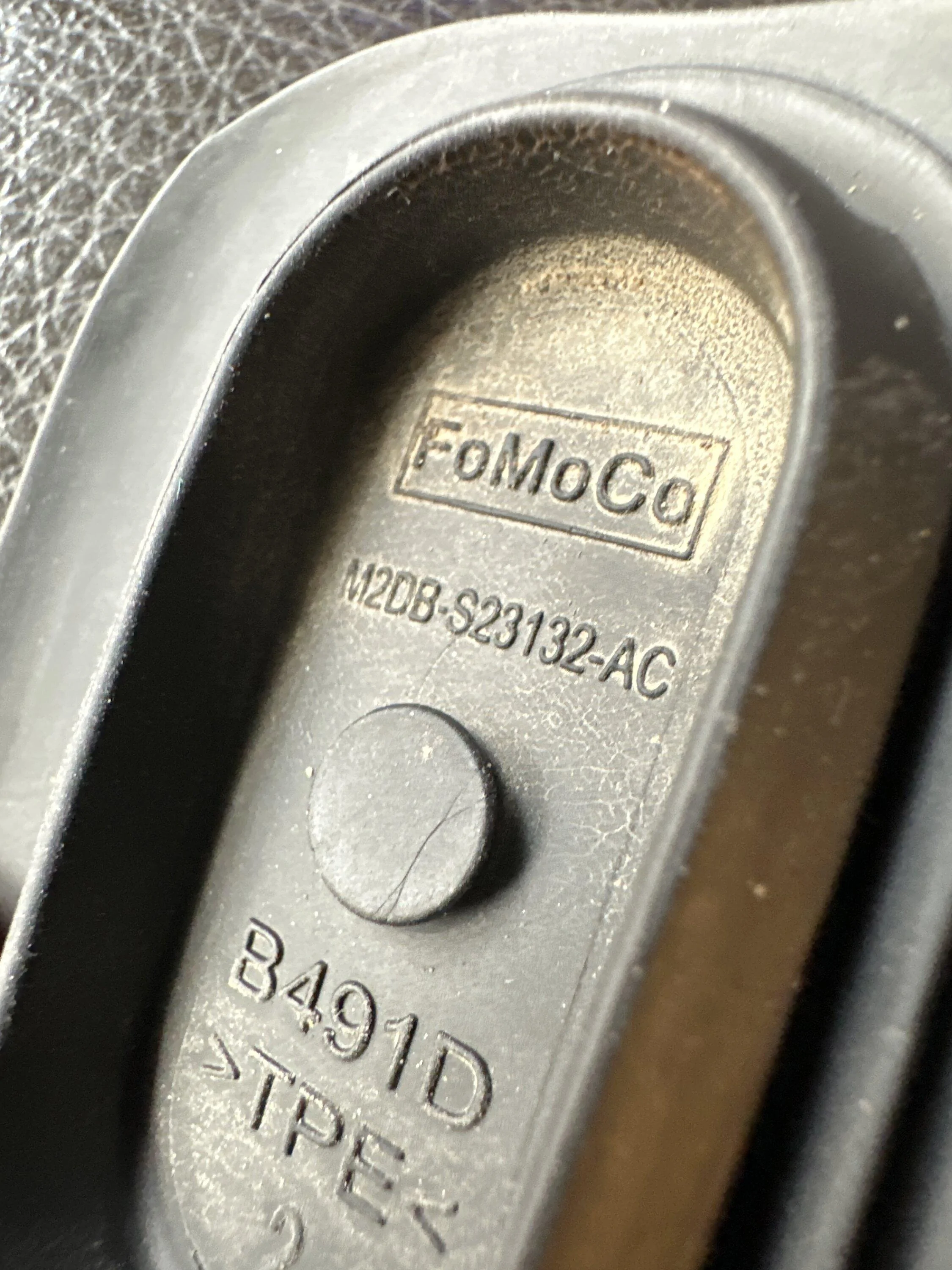

I found this part under my Bronco this morning. It looks like a frame or firewall plug, but I can’t see where it’s supposed to go. Anyone have a clue? Maybe some one can search it in the parts catalog?? Part number is M2DB-S23132-AC
Ford Bronco Mystery Part - Help me ID it!! imag

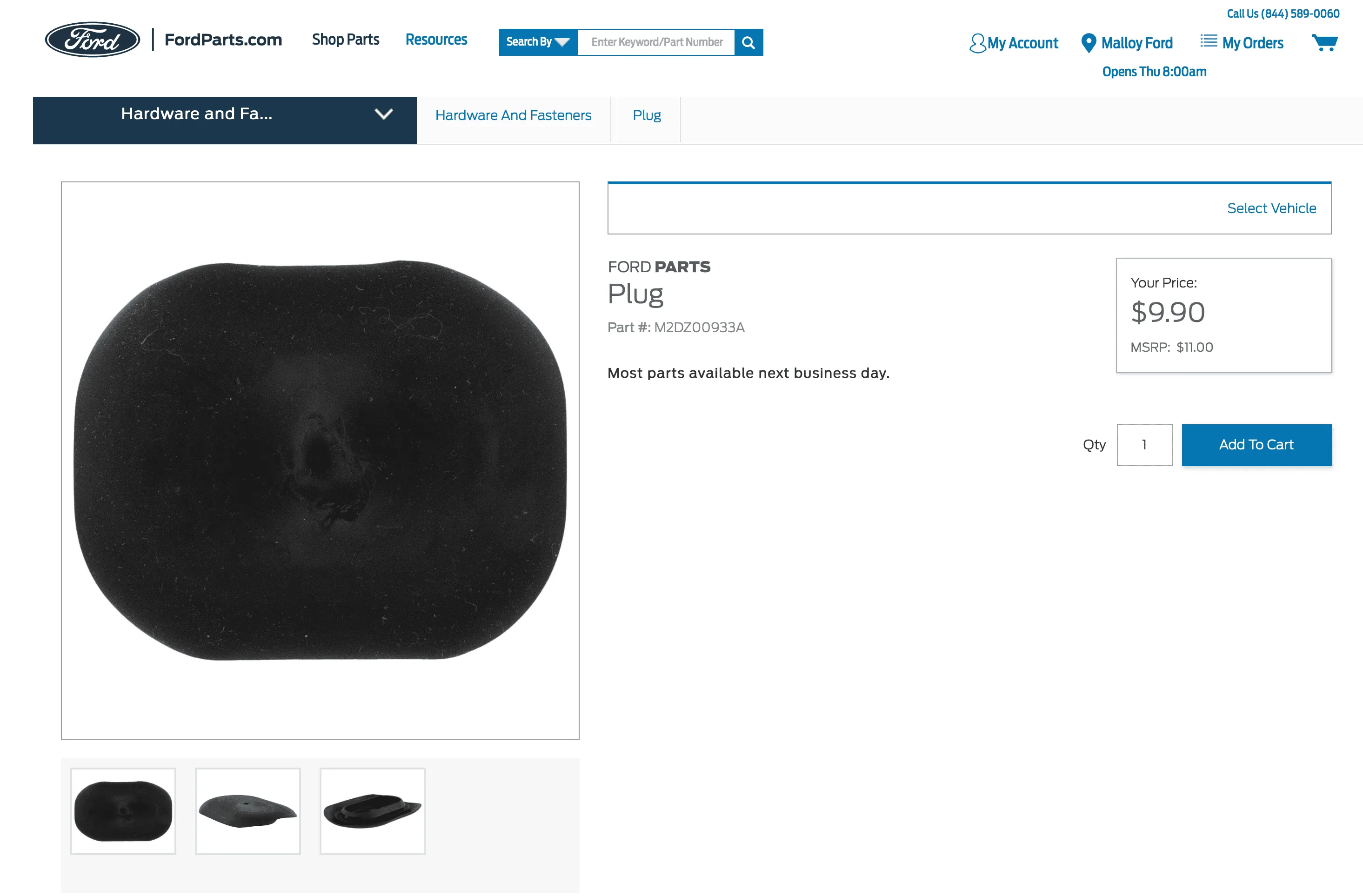

Well, it's not off a garden hose nozzle, that's for sure.
According to a quick Google search... It's a plug.
@Ducati1098 will know what hole this plugs.
Ford Bronco Mystery Part - Help me ID it!! Screenshot 2023-08-02 at 6.42.15 PM

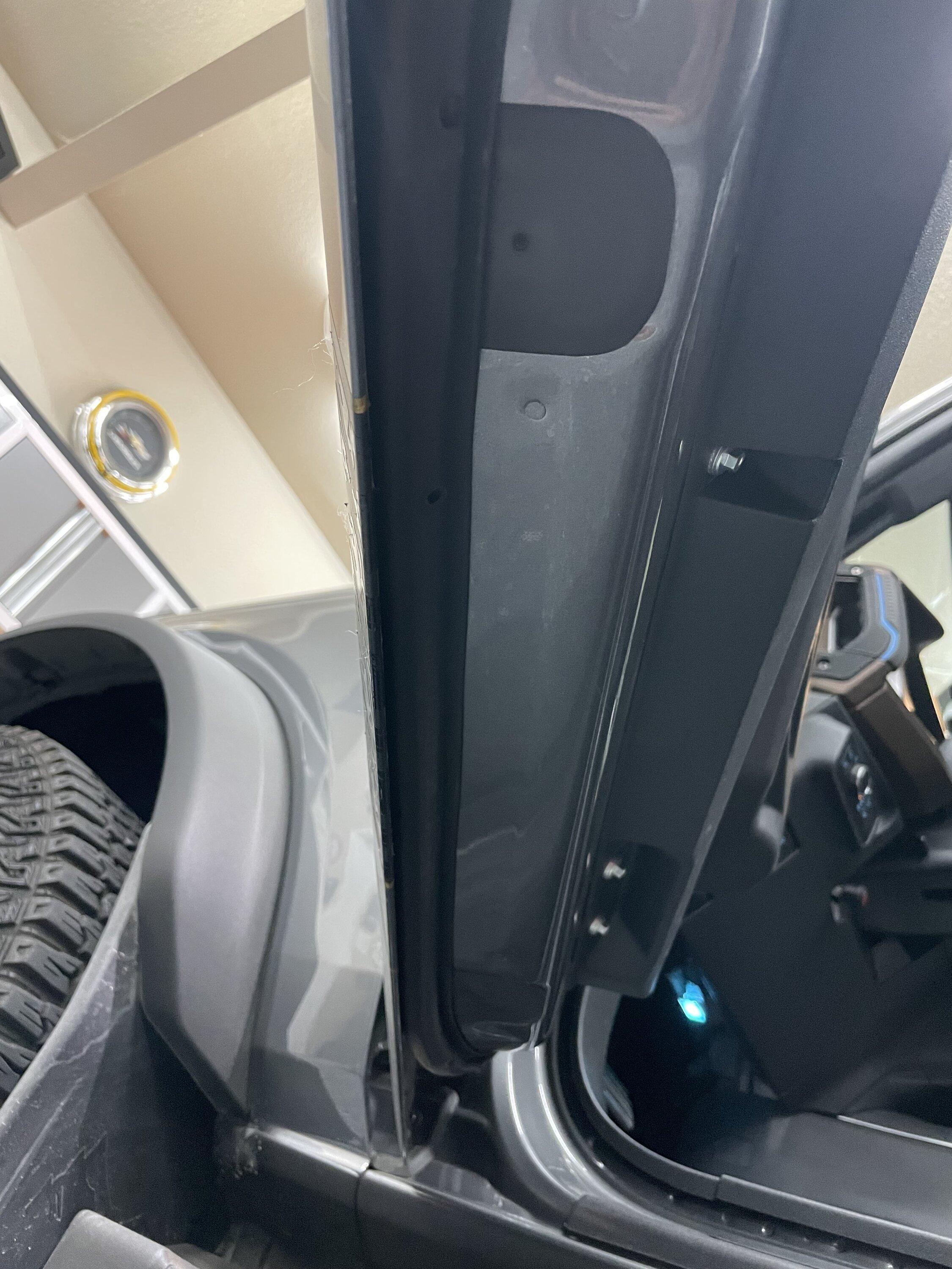

Look under the bottom of the door where you found it. There will be a hole that shape that it needs to go into. The bottom edge of the door.

Bam, nailed it!
The dealer adjusted my windows last week and obviously didn’t bother to put it back in properly. Thanks!!

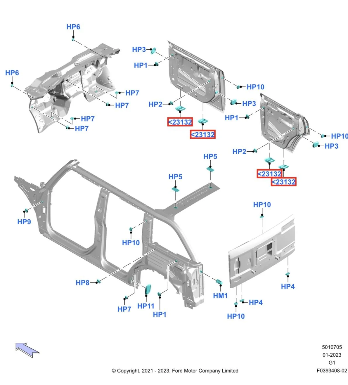

Late to the party, but looks like you guys figured it out!
Ford Bronco Mystery Part - Help me ID it!! IMG_1715
