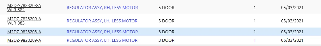

Bongo it seems like both parts are the same number. Got any tips?

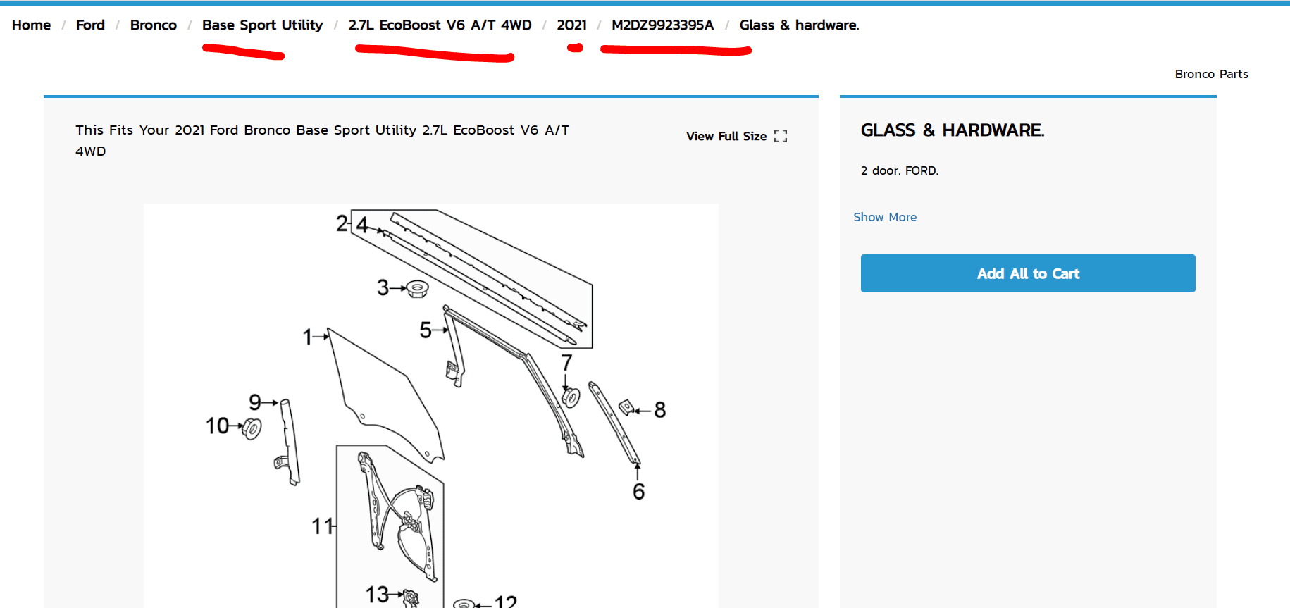

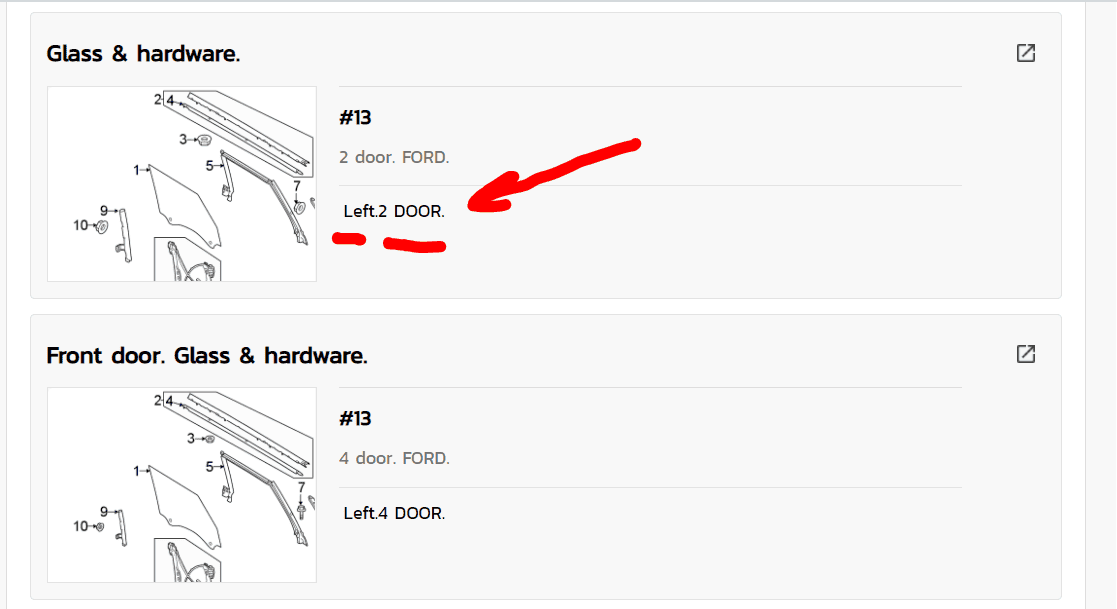

Here's all I got
link for 2 door assembly
https://parts.lakelandford.com/a/Fo...AT-4WD/__9423708/Glass--hardware/ML21705.html
And for comparison numbers here's a link for the 4 door assembly
https://parts.lakelandford.com/a/Fo...23916/Front-door-Glass--hardware/ML21740.html
As you can see the part numbers between the two are quite different.
I think this is what you're asking.
Sometimes my interpretations of what is being questioned end up way off mark...use your best judgement
.:D
I agree with Bongo. There are subtle differences in the part numbers for the 2 door glass and 2 door regulator (look carefully at the full number..not just the last few digits) versus the same 4 door parts. The motors for the 2 door and the 4 door appear to be the same, which would make sense.
And, if still can't figure it out, I suspect the parts that need replacing are labelled with the exact parts numbers. Have your dealer pull the parts from your door and get the numbers off of them.
