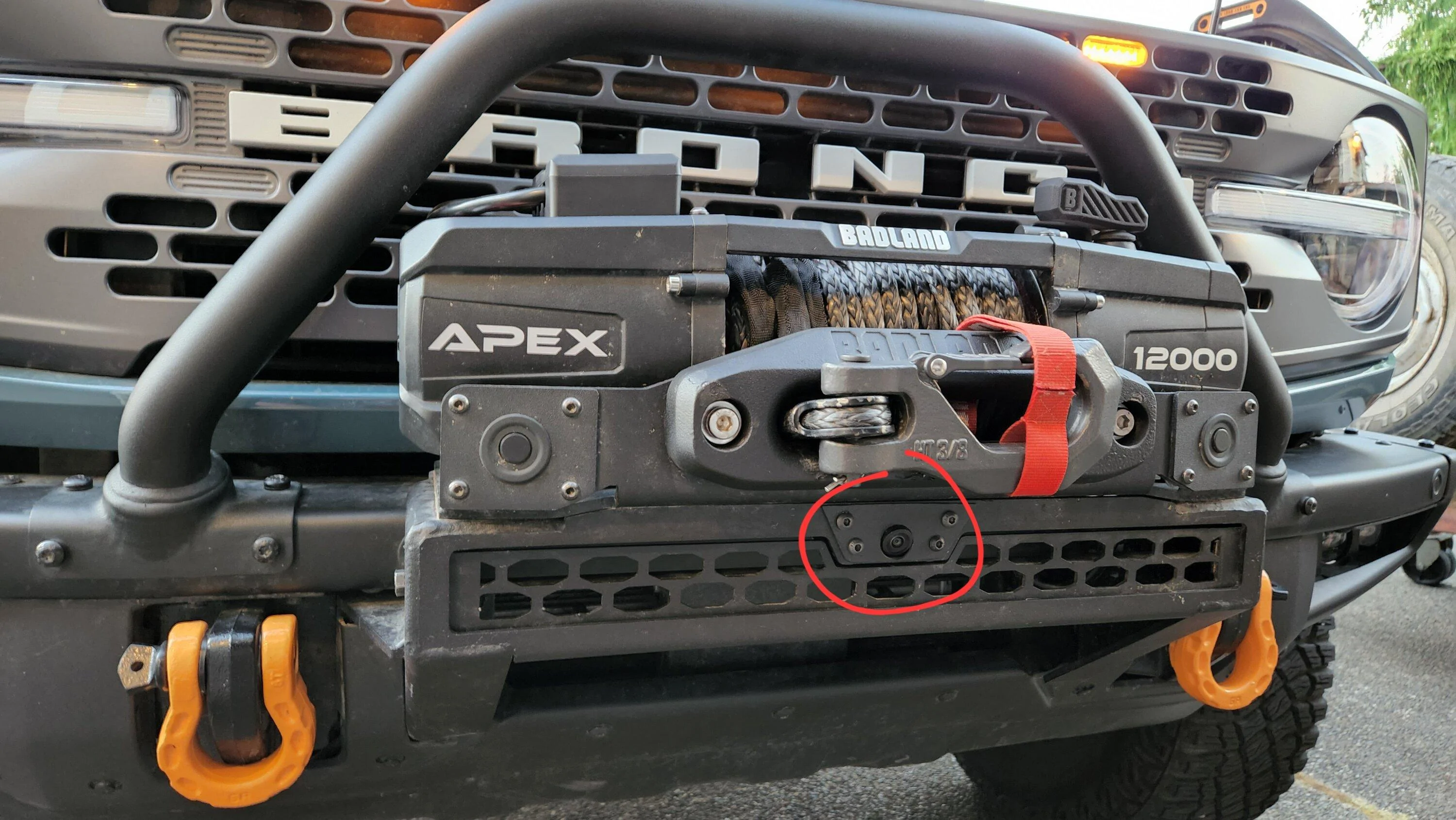

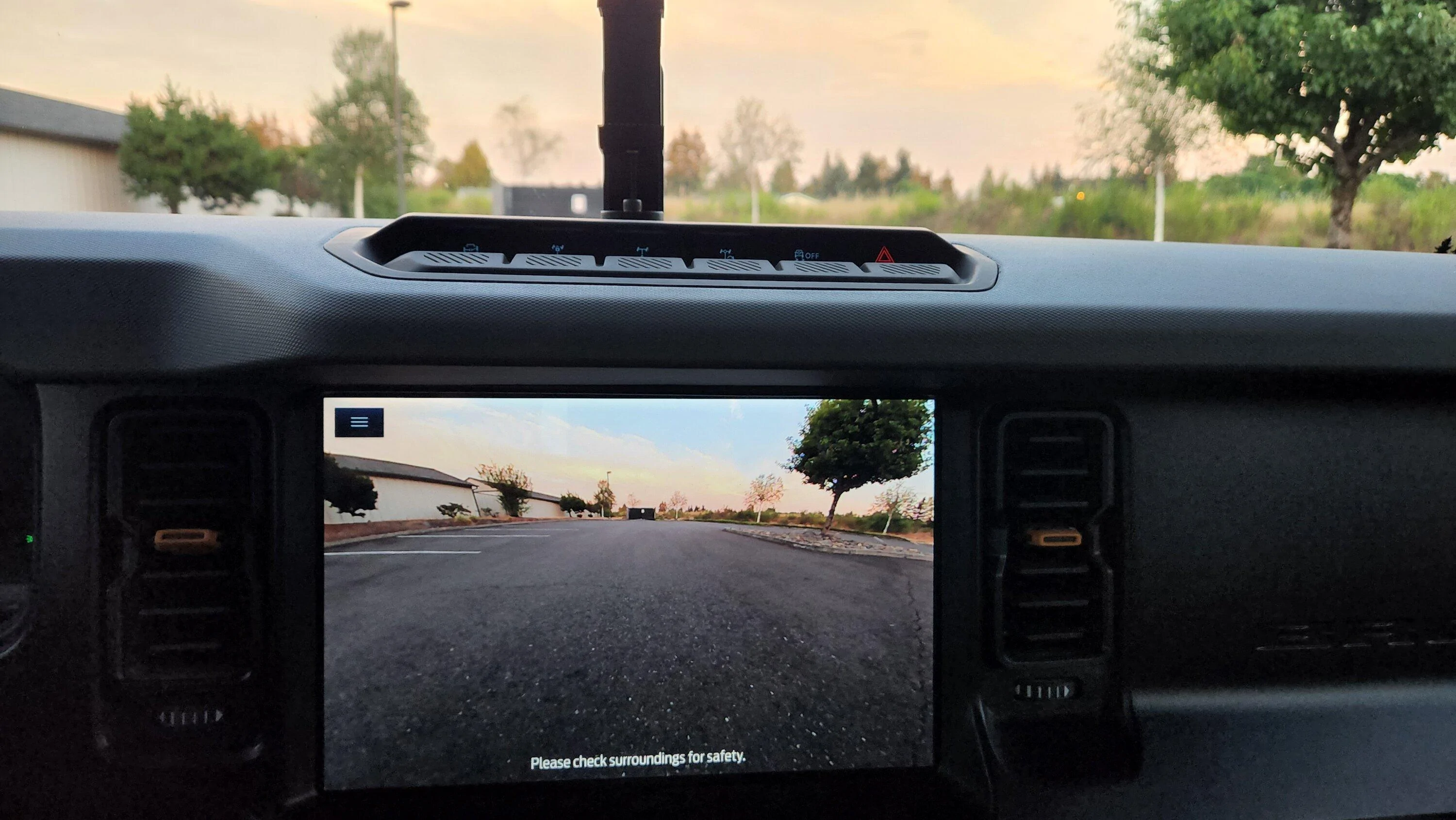

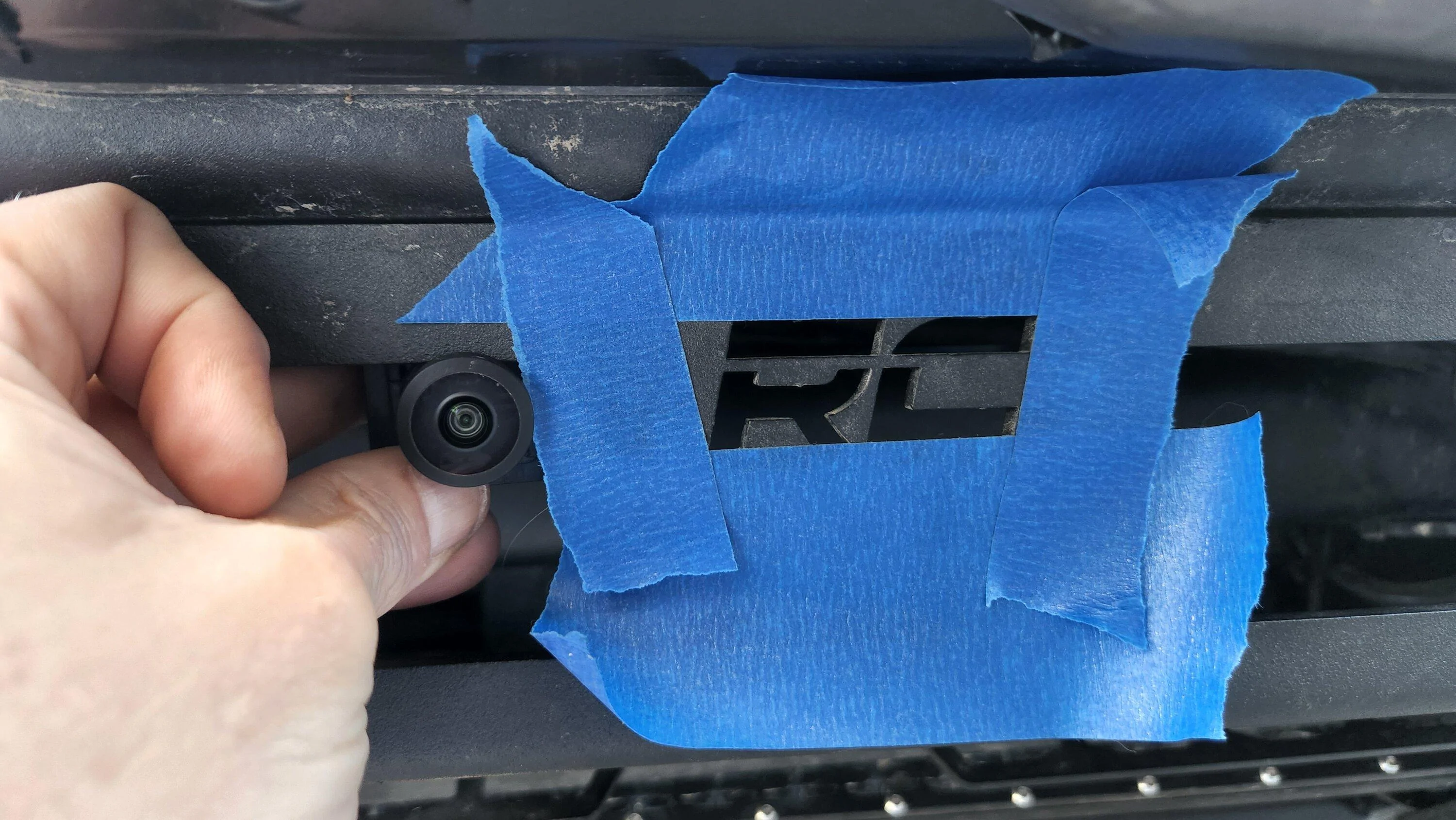

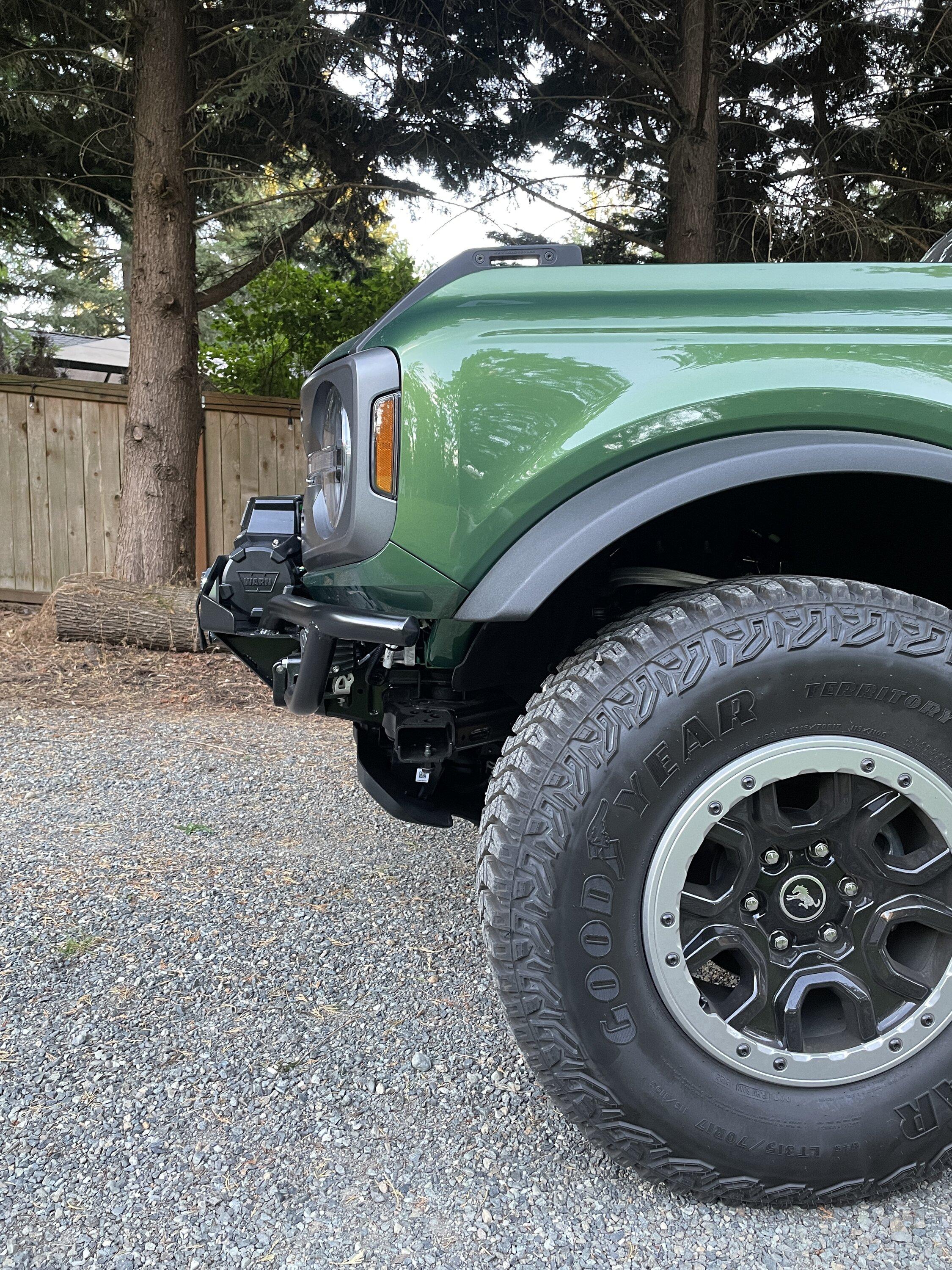

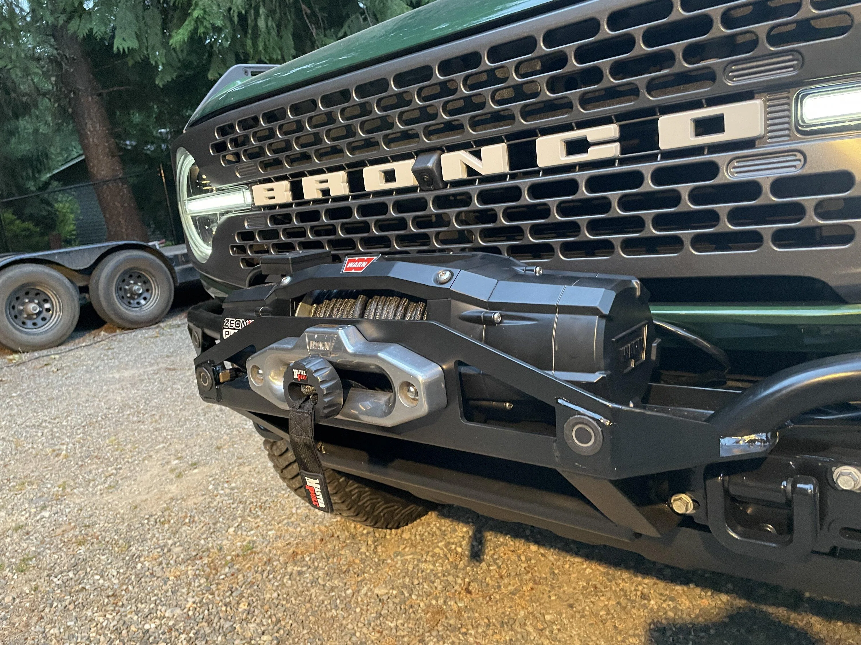

You'd be surprised how low you can relocate your camera and still get a great view. Just fabbed up a solution for my RC high-mount winch plate. (Aiming point for the factory front camera is about 4.5 feet from the lead edge of the front bumper... which converts to about 30° mounted this low.)
Wanted something more subtle than the bulky fairlead-mounted ones. So nice to finally have a full-view front camera again.

@66GT not to mention you got rid of the RC logo at the same time. Nice job

Super nice work. Very impressed.
I saw your post and work 1 day after ordering the mount from JCR. I also ordered the cable you used and a washer hose extension.
going to see which one works best
thanks for the inspiration!

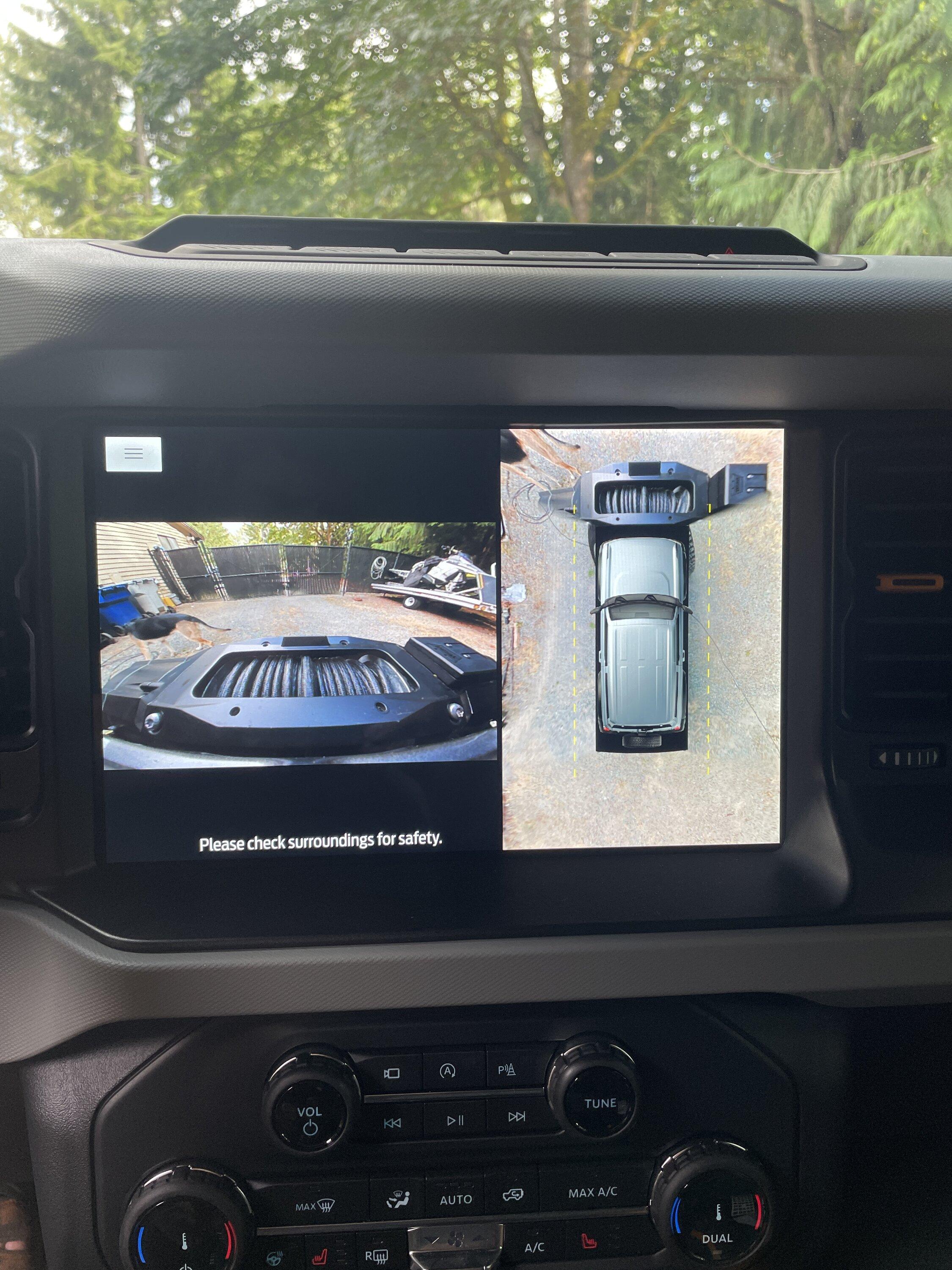

What does you front cam view look like. Are you going to trim the edges of skidplate that stick out?
i will try to grab some camera pictures as is. It’s better with the relocate for sure.
I will leave the skid for now. Going to pick up a full set at some point to cover the transmission and will get front at that point.

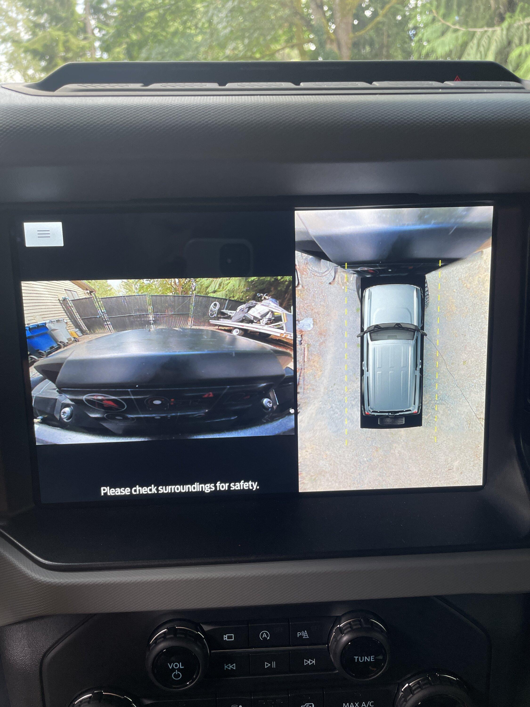

Here’s the camera views currently before and after the winch control relocate
Ford Bronco My solution for a winch bumper 9A2B5C44-88E5-4A97-B52A-5562FEF5C622
Ford Bronco My solution for a winch bumper C2E6441A-6E63-4008-A526-1A23009A9DD0

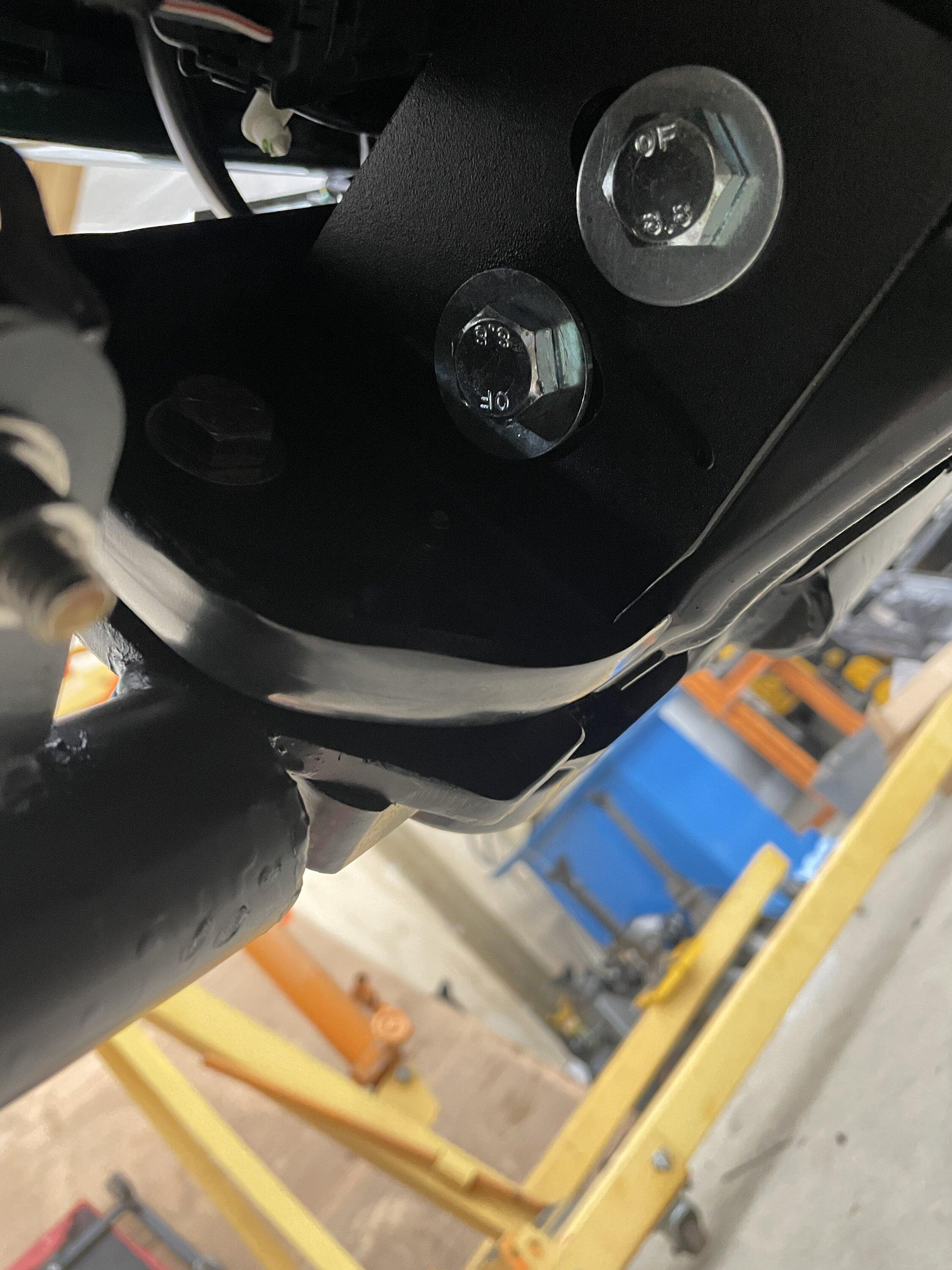

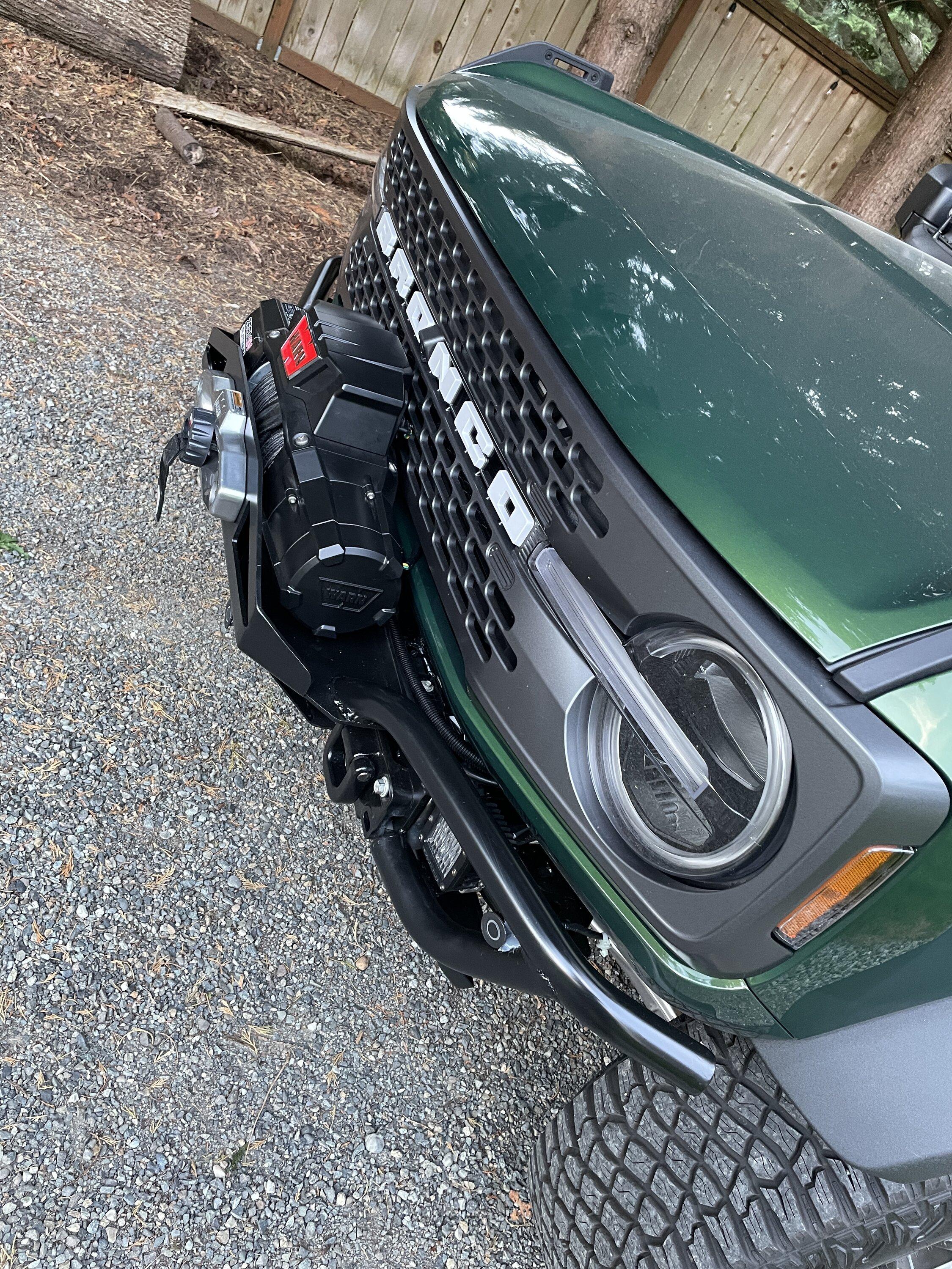

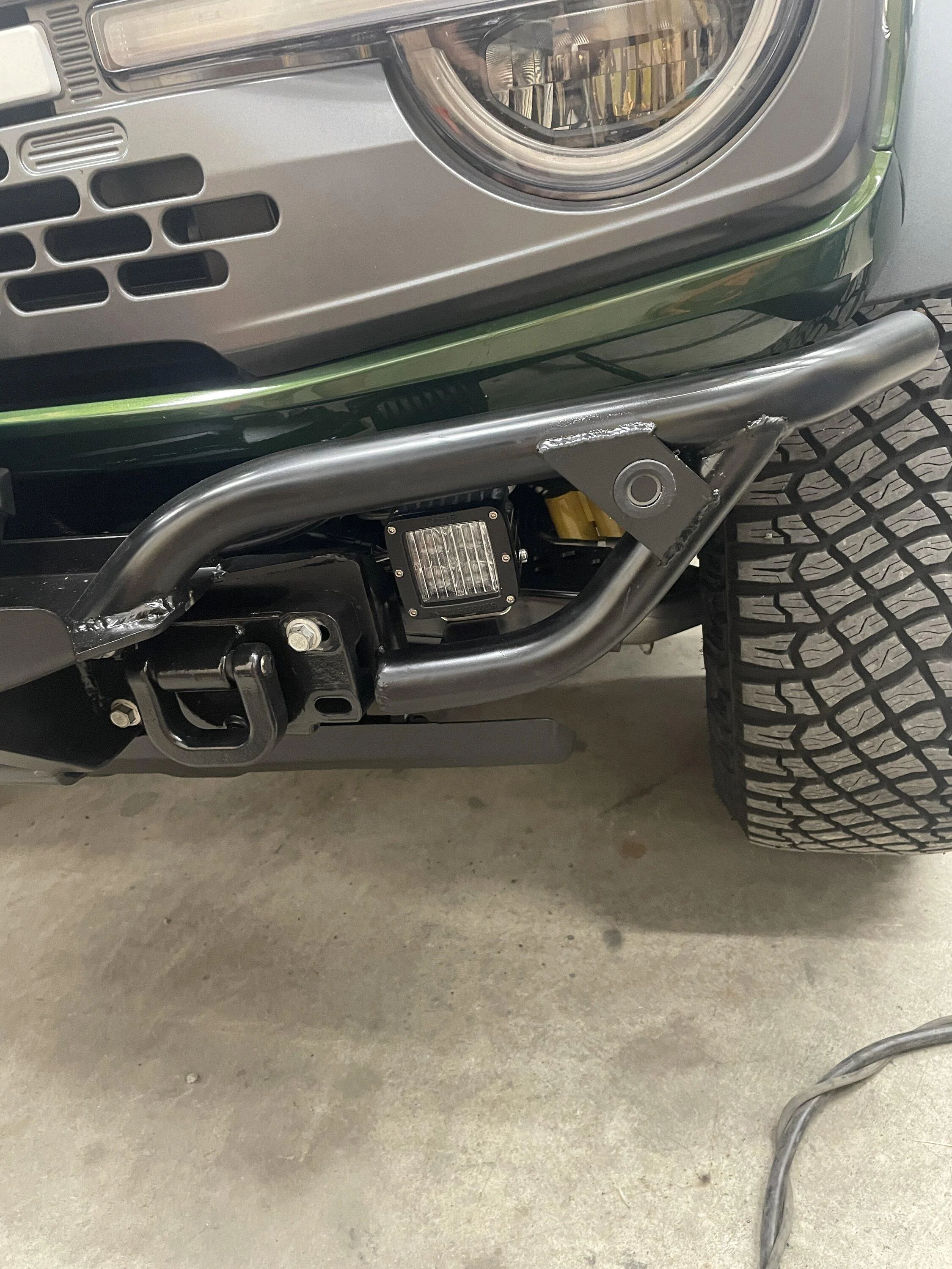

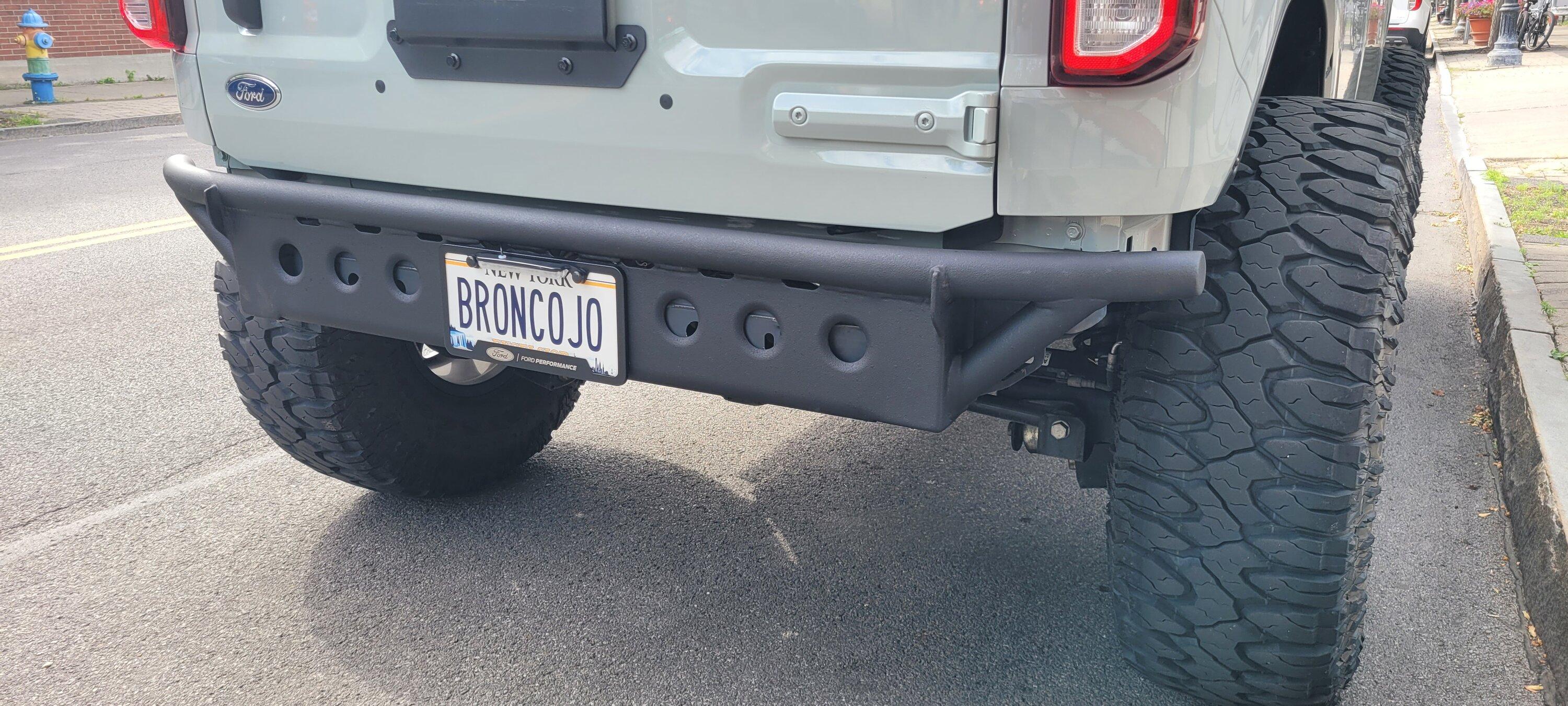

1.75 x0.120 DoM tube. It’s the only die I have for my bender.
excited to see what you have planned for a rear bumper. Im on to rock sliders next.
then I will get to a rear bumper.
Rear bumper done. I used spare dimple plate I had, not sure how I feel about seeing the frame. But I like how it turned out.
Ford Bronco My solution for a winch bumper 20220815_102715

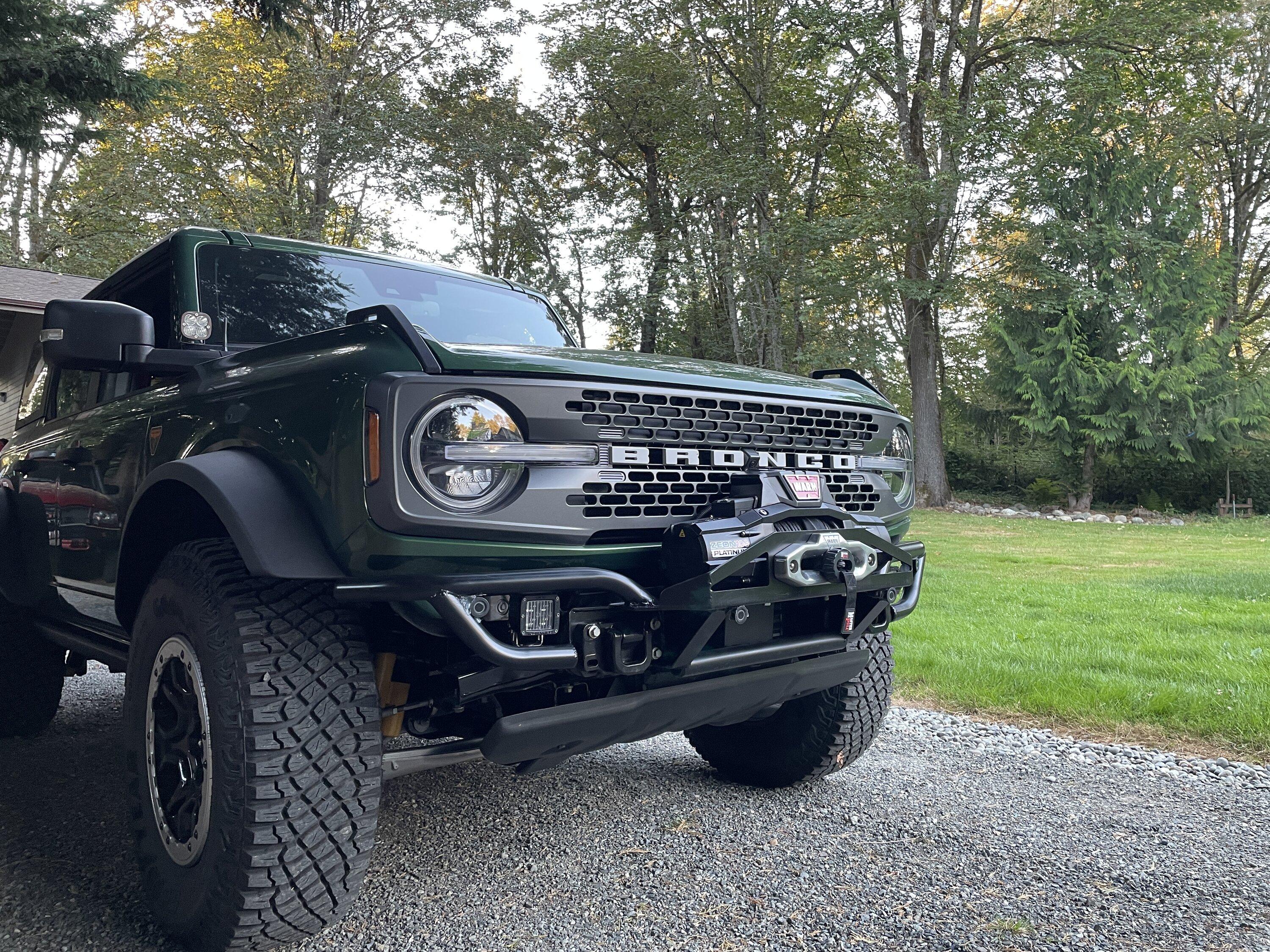

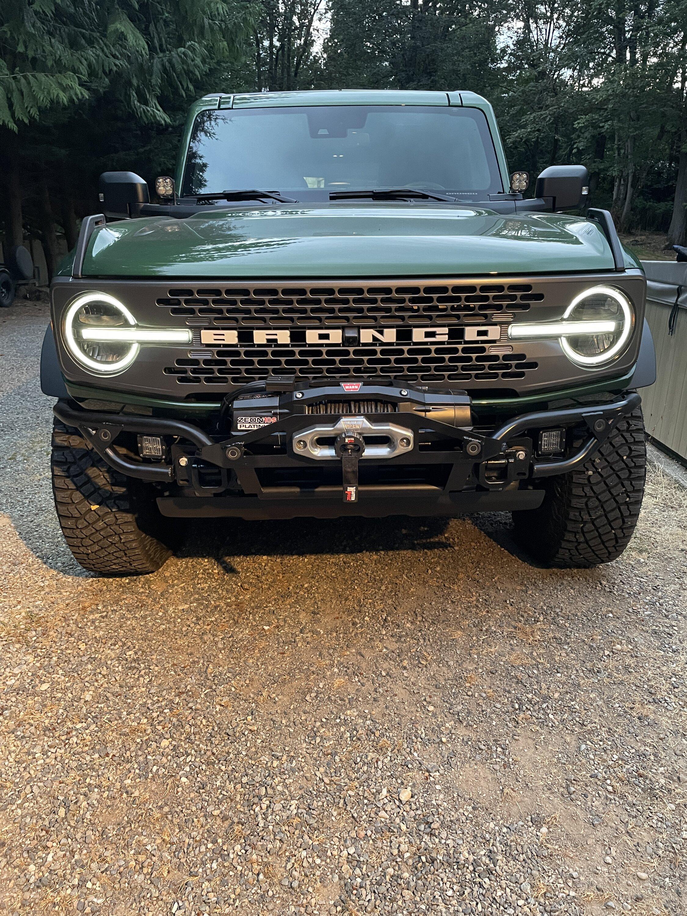

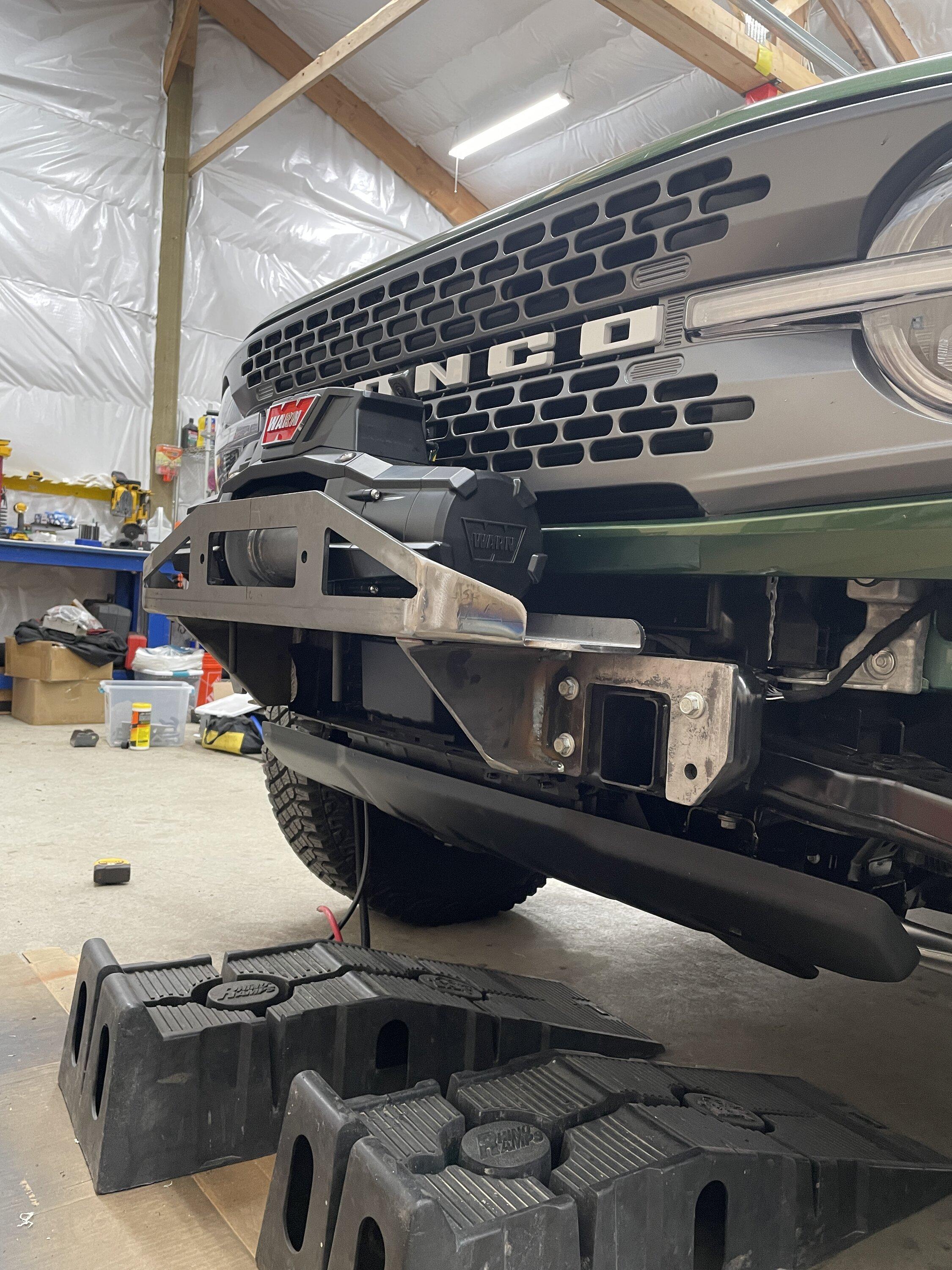

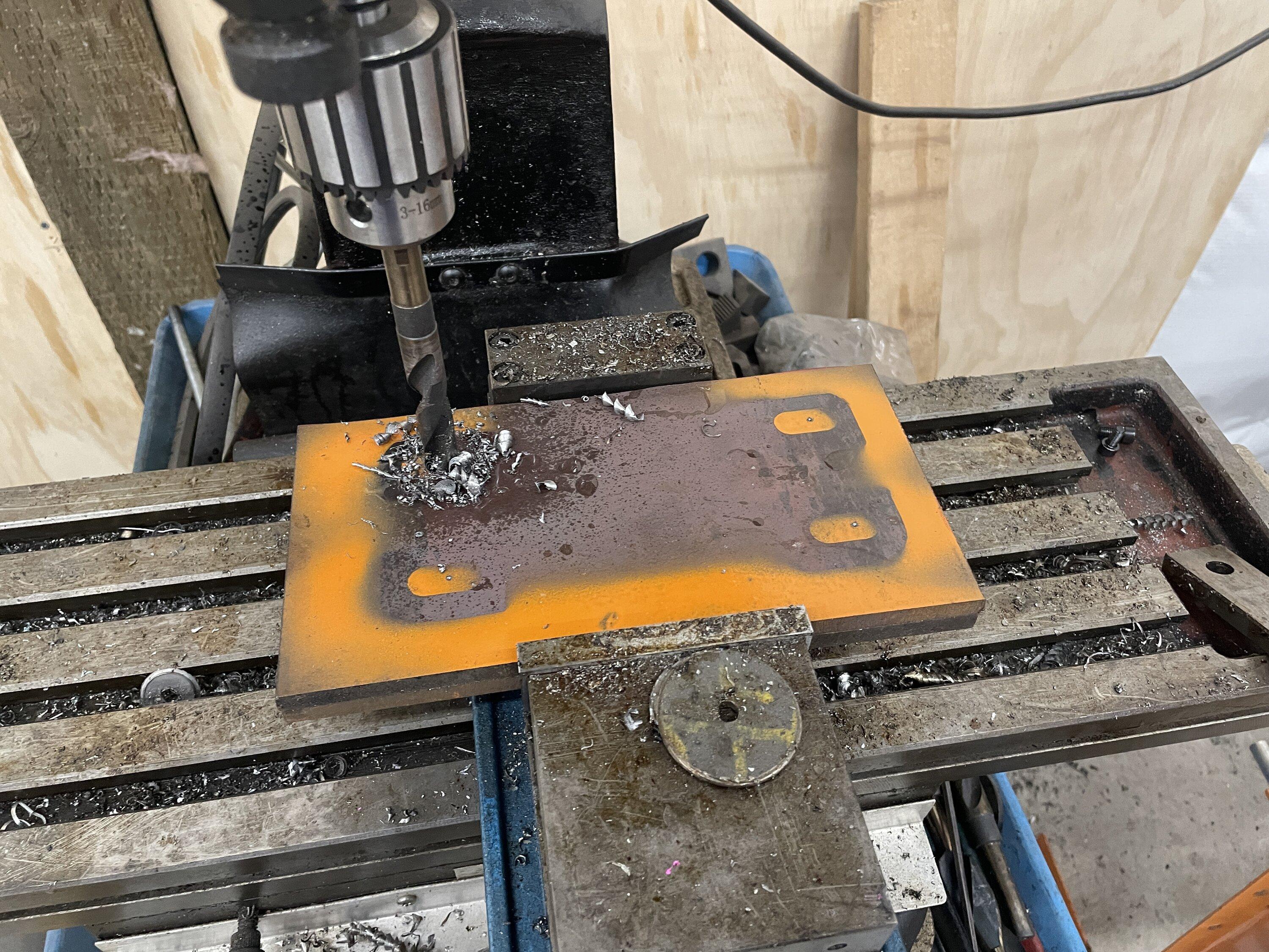

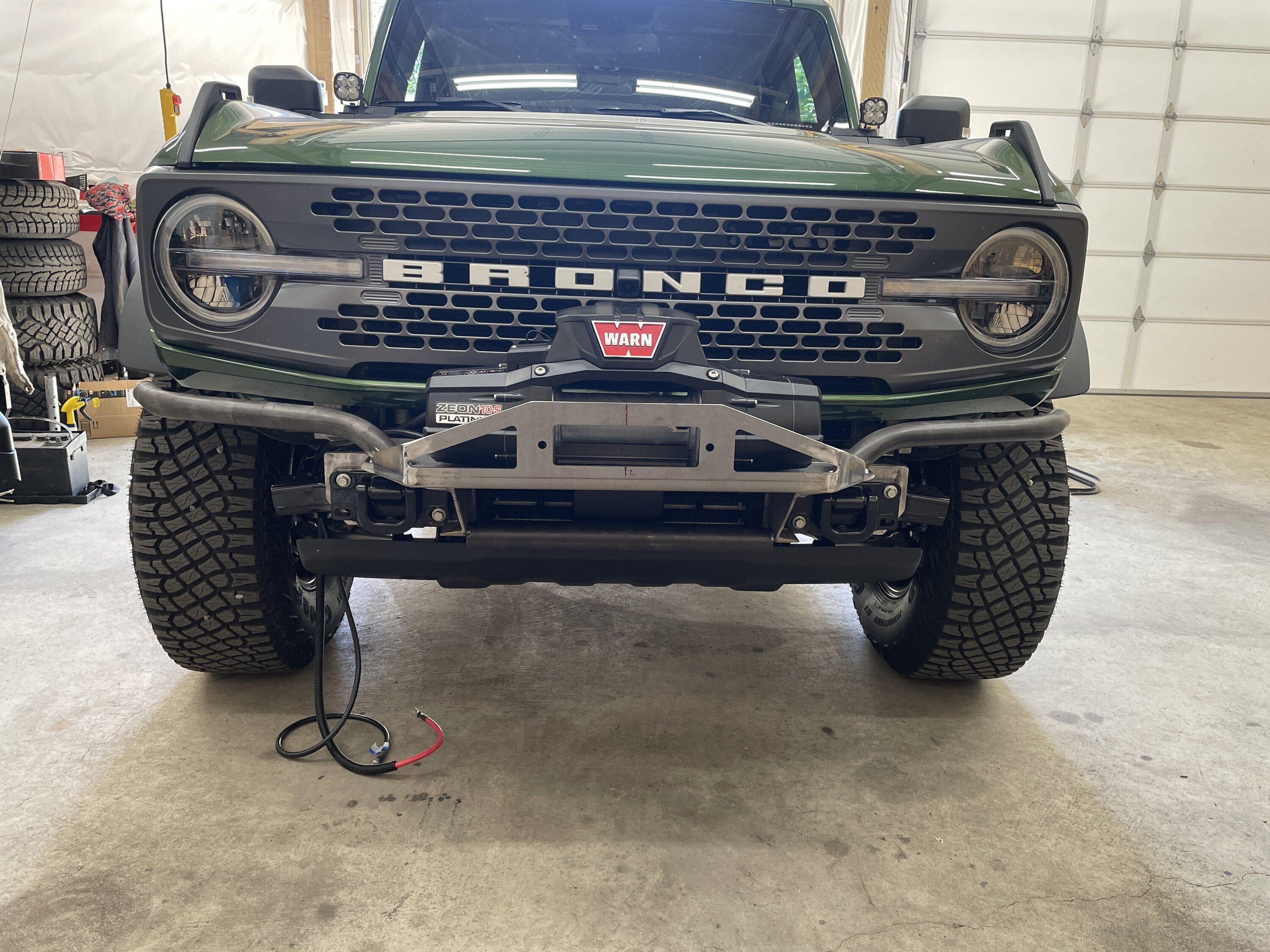

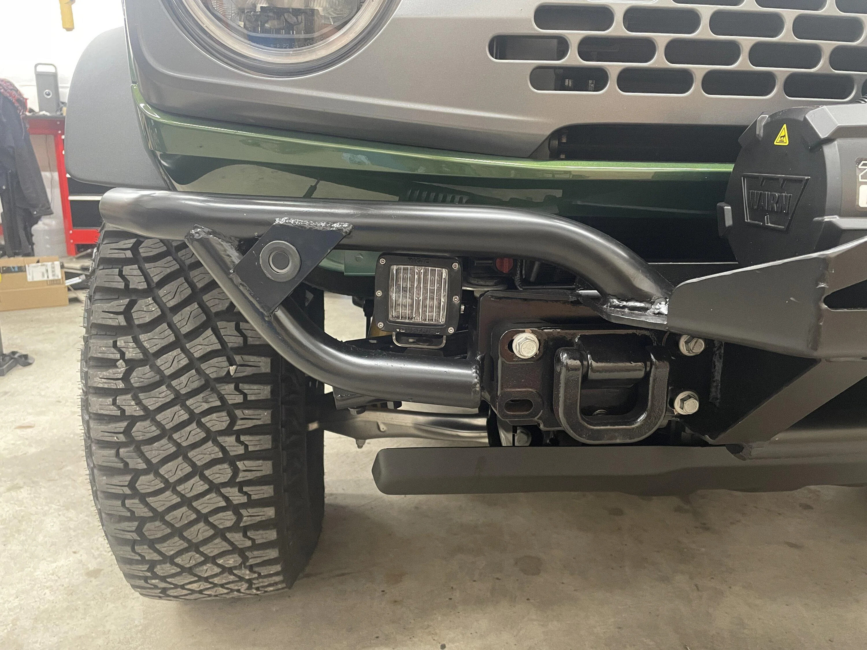

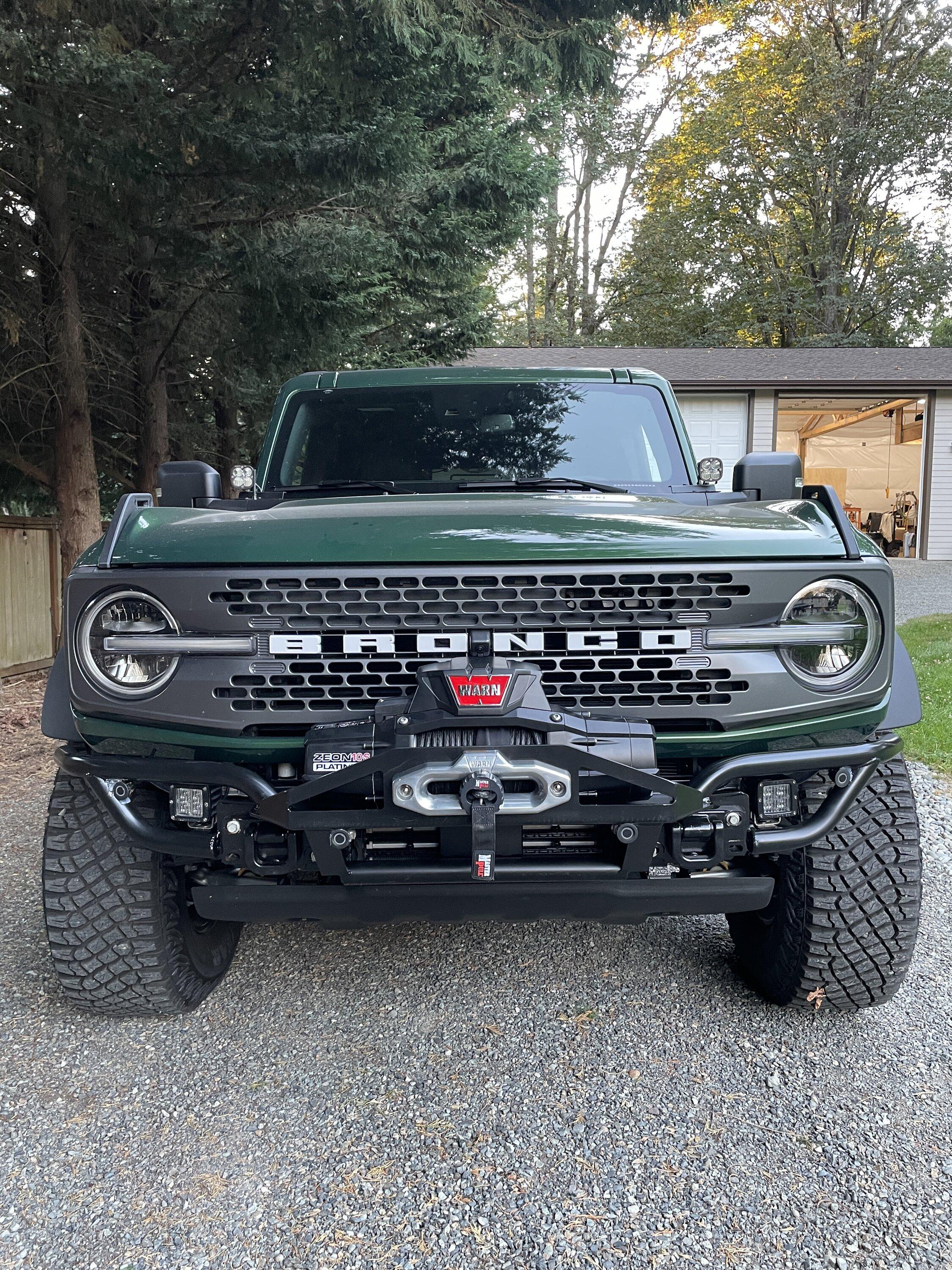

I ordered my rig with the capable bumper to gain fog lights knowing I would build one when the rig arrived.
Im no pro fabricator but this is what I came up with.

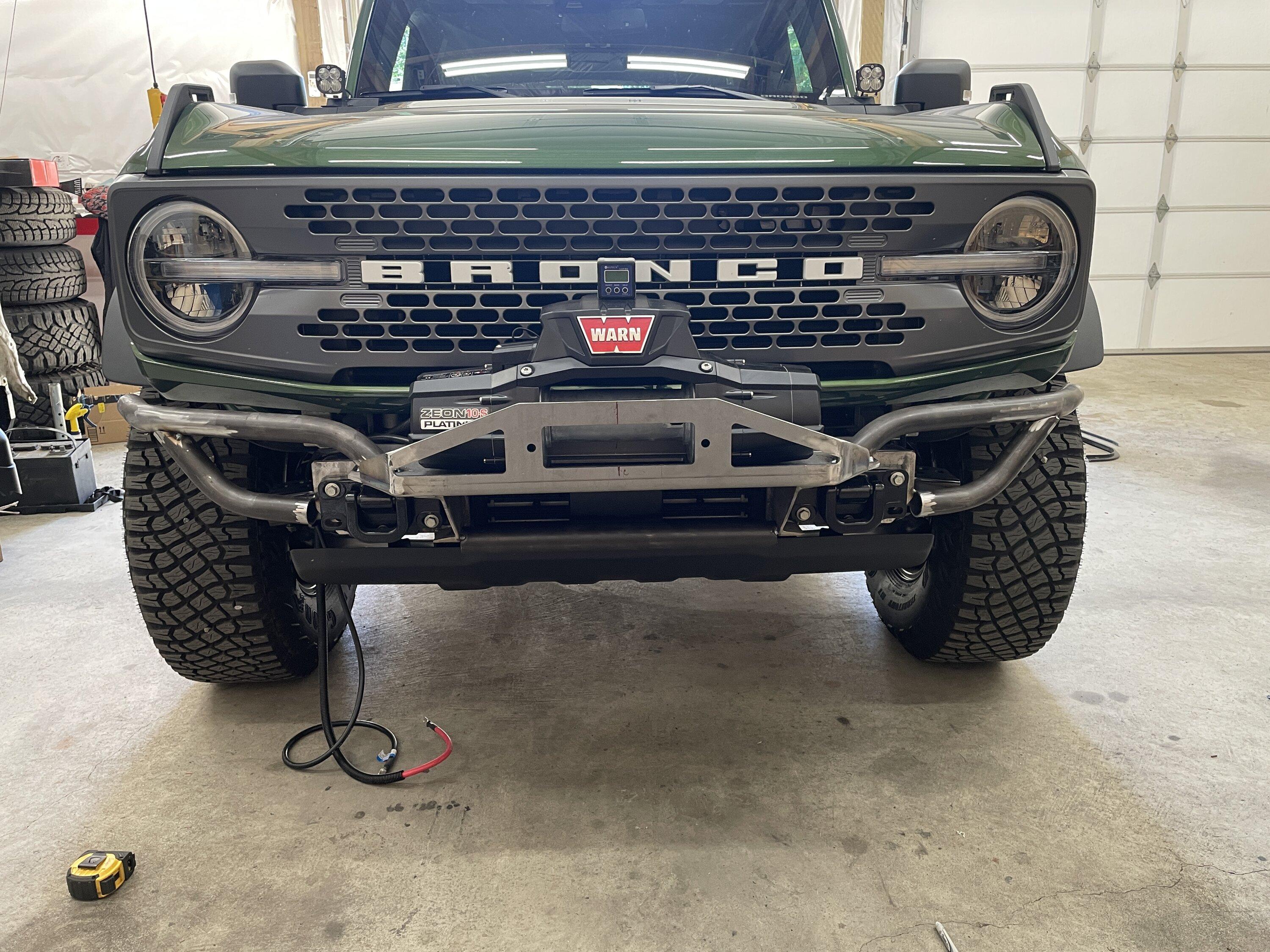

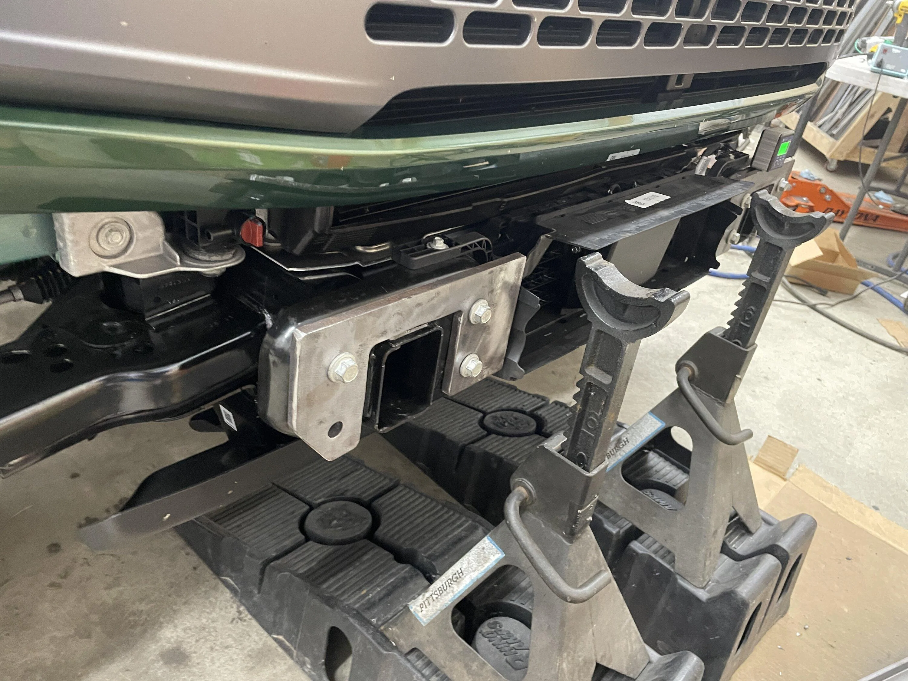

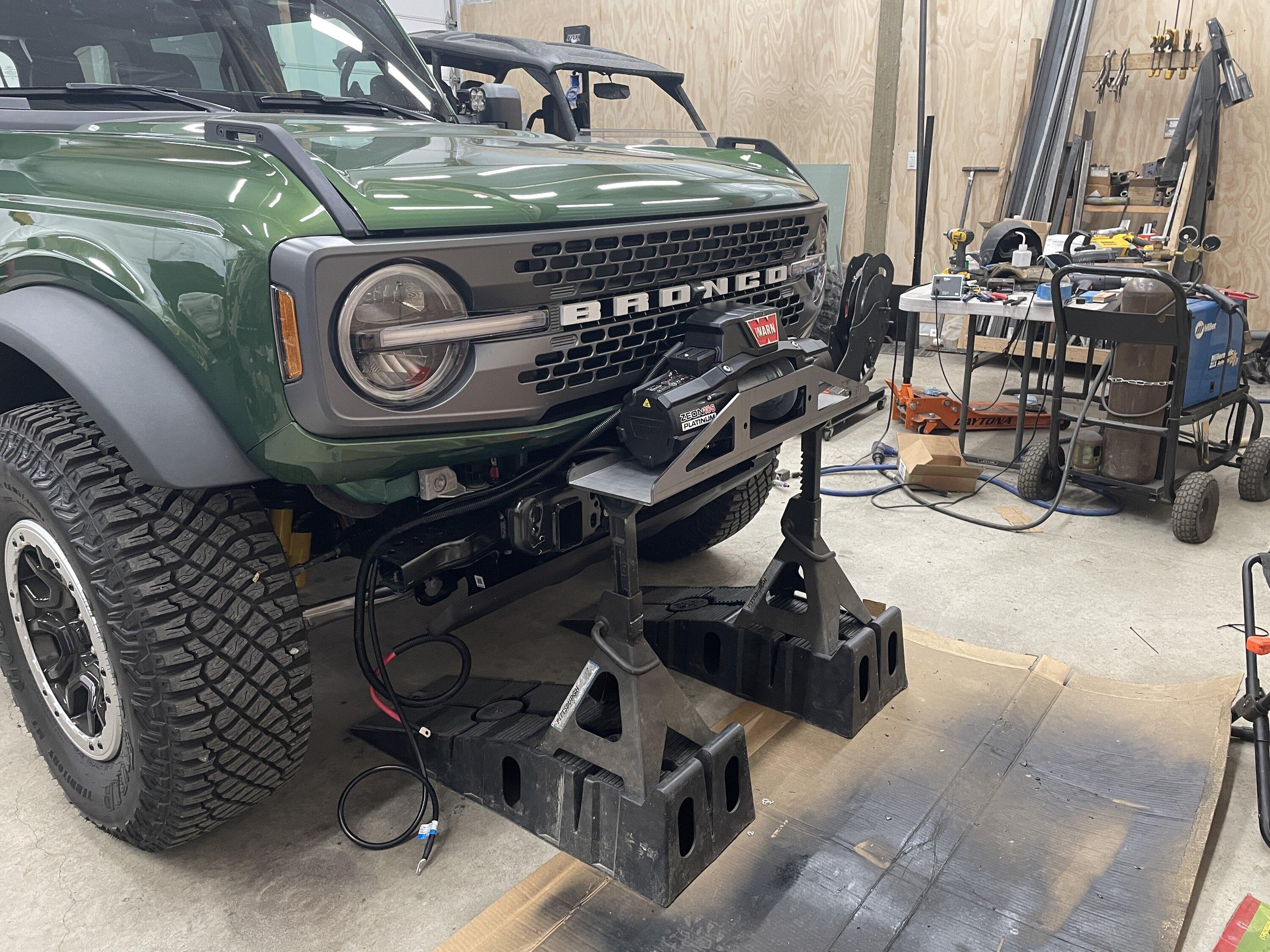

set out to make the winch mount strong and not block the ACC. Started by placing the winch and a Barnes 4wd winch plate.

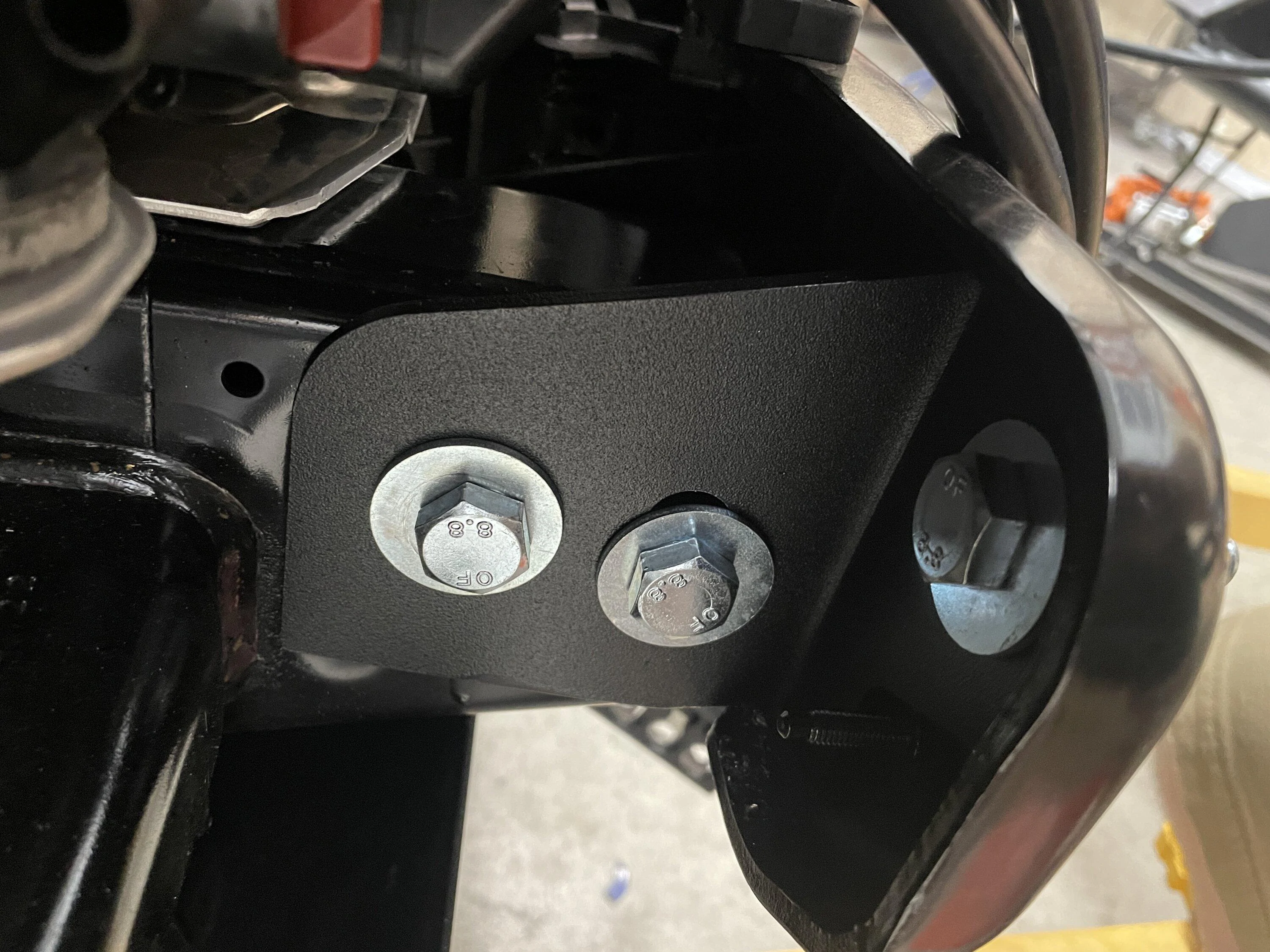

then I worked on the mounts with some 3/8 plate
next up was attachment, used some 5” C channel to tie the plate in to the mounts. Also

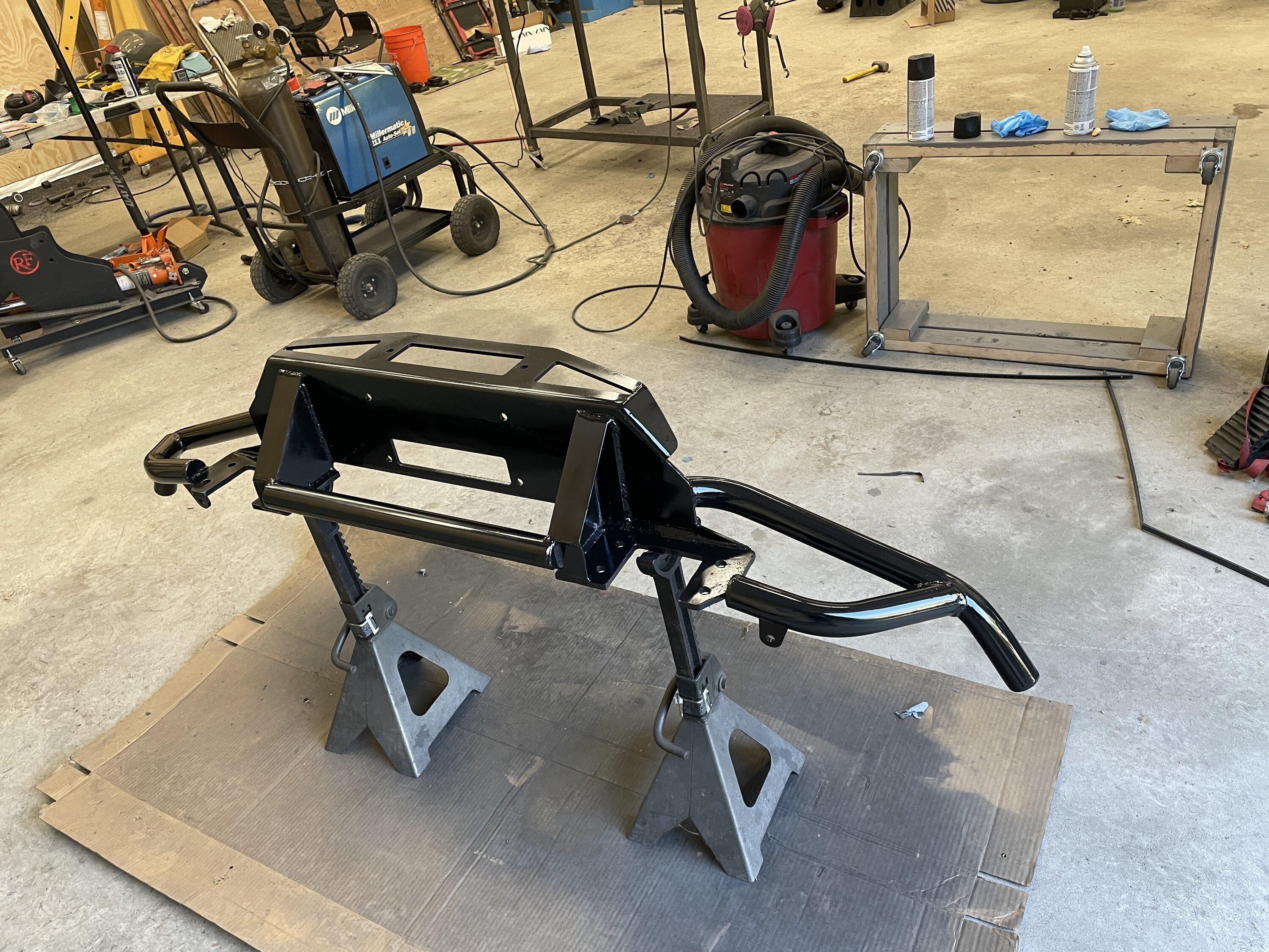

Then I started adding some tube and reinforcements
Fast forward to lots of welding later and I painted
installed.
Next plans are to relocate the control box and camera. Then make permanent mounts for the sensors. They are just hot glued in place so I can test locations for a few days before fabbing some mounts.
also have the LOD frame tie in plates to install and will replace the factory hardware with some grade 8 nuts and bolts. (Gotta see if I can drill the 4th hole on the frame too for the tow hooks.)
Thanks!
beautiful work. my favorite bumper so far.
