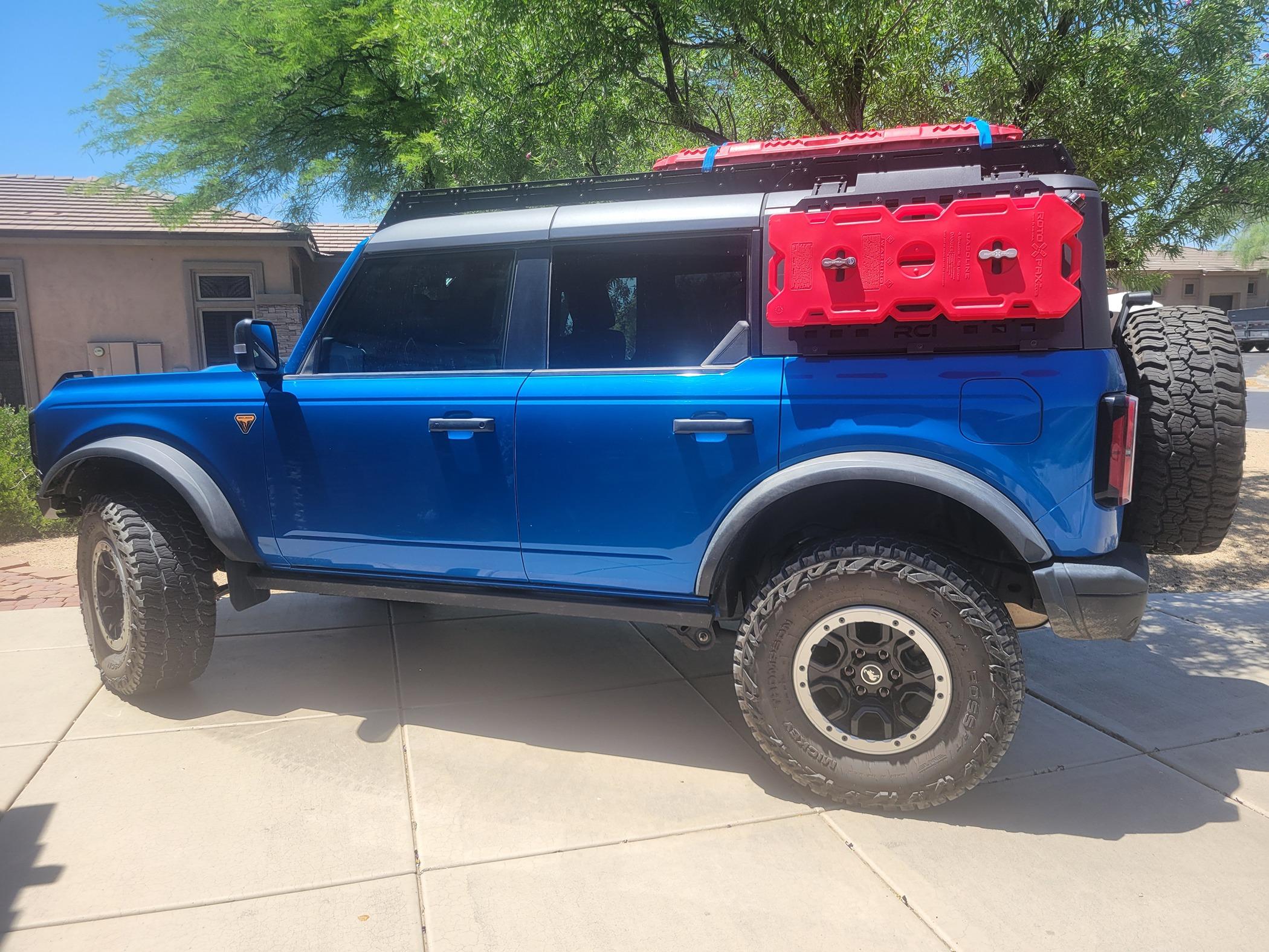

After being inspired by a lot of the work y'all have done on your Broncos, I thought I would share progress on my 2023 Badlands overlanding build. I do a lot of offroading on the Arizona Strip to access Grand Canyon and the roads can be really rough. I wanted to be able to sleep on the roof rack in summer and sleep inside the Bronco in winter. I had a buddy who builds custom cabinets build a drawer system in the rear that also levels the floor. I did a run through of the build so far in the video below:
Badlands 2.7/SAS/MIC/LUX
Mickey Thompson Baja Boss (stock tires punctured twice in two trips)
RCI roof rack with side panels for fuel and water
Trailgater table
rear saddlebag storage
Custom sleep platform and drawer system

He doesn't sell them today. He's a custom cabinet builder for high end homes. This was a bit of a distraction for him fueled by friendship and beer! :)
He built two of them simultaneously for my buddy and I. We helped with the design concept and the install. Buddy has a 4 door BD and I have a 4 door BL. If I were to guess, he'd have to charge a couple grand for the completed product. I'm not sure there's a market at that price point. But I will tell you, the end result is AMAZING! I can now sleep like a baby in the Bronco and the storage is really terrific. It's so easy to get to all of those things you need to access often even when the back is loaded with gear! It's easy to get to the jack too and use the storage next to the jack. I already had the Trailgaiter table installed, and the design is compatible, but the floor slides out into a very large and nice table. Had I installed the floor first, I might not have needed the the Trailgaiter. But I do like them both, and with gear loaded in the back, it's nice to not to need to slide the entire platform out.
The latch system is from home windows, and there is a locking option. I chose to skip the locking option because I didn't need it. The latch is located offset because it would impact the Trailgaiter table otherwise. If you didn't have that table, you could install dual latches, or locate the latch wherever you wanted.

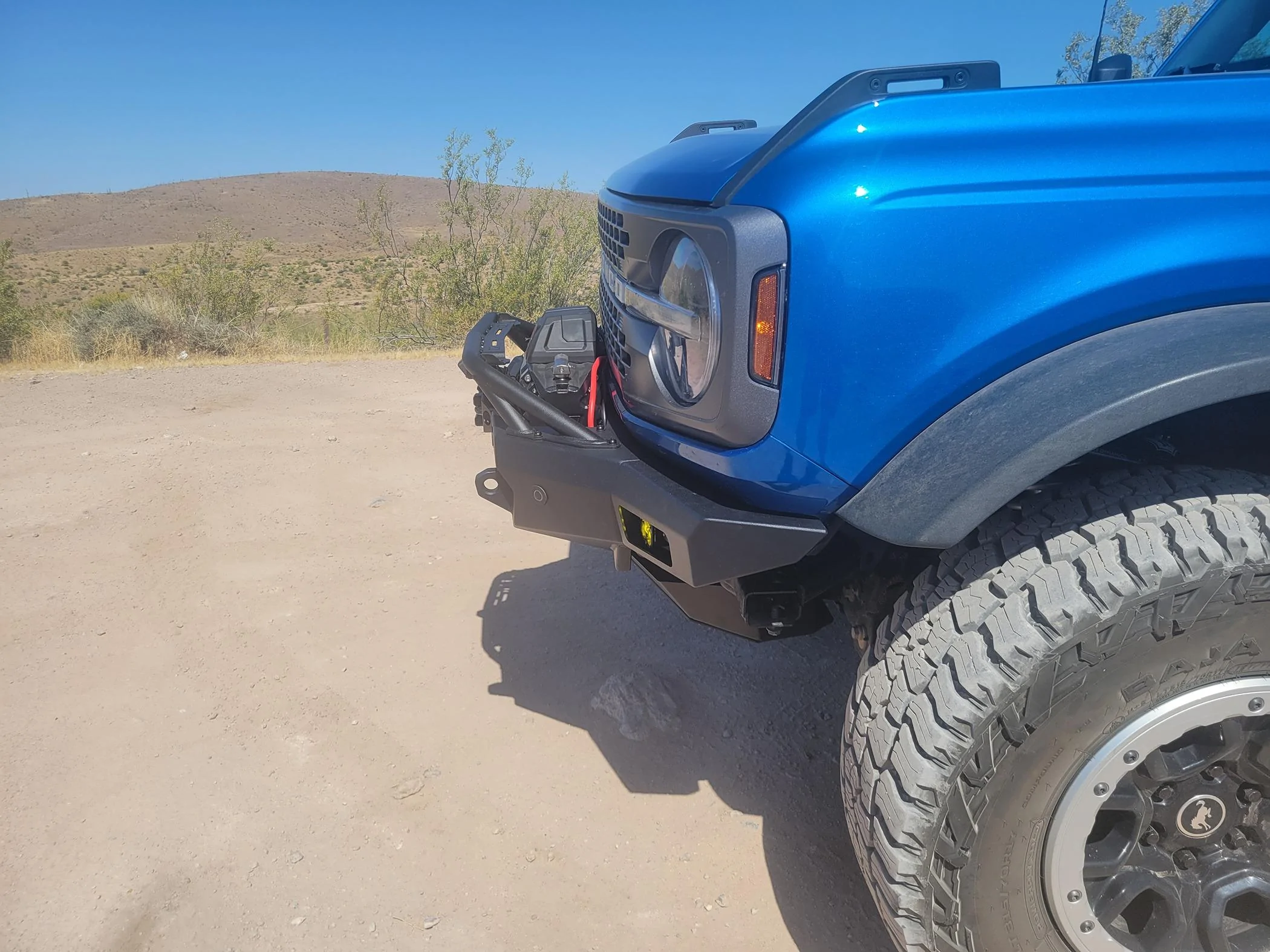

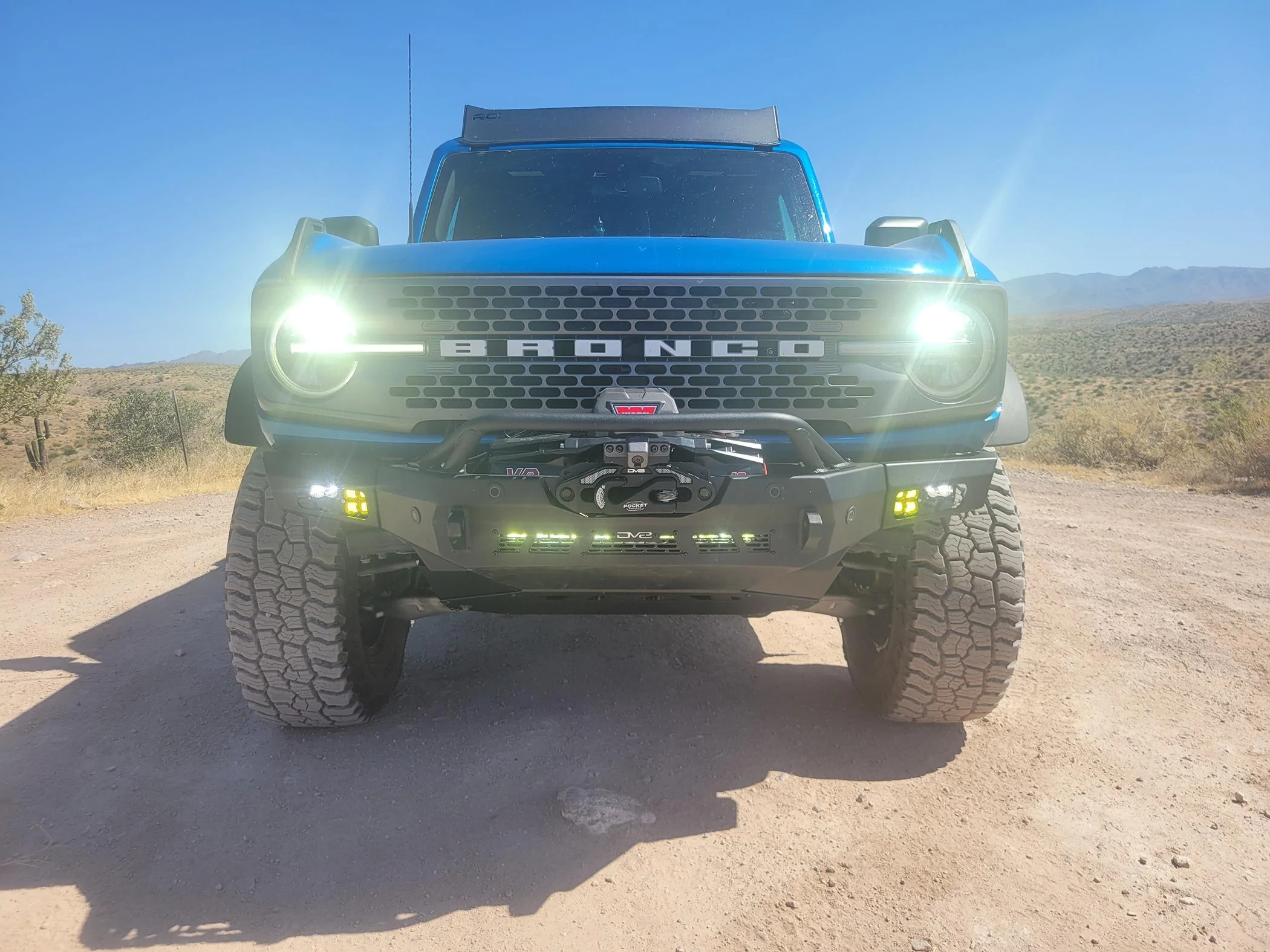

- added a DV8 Spec bumper, Warn Evo 10s, some Baja Designs lights

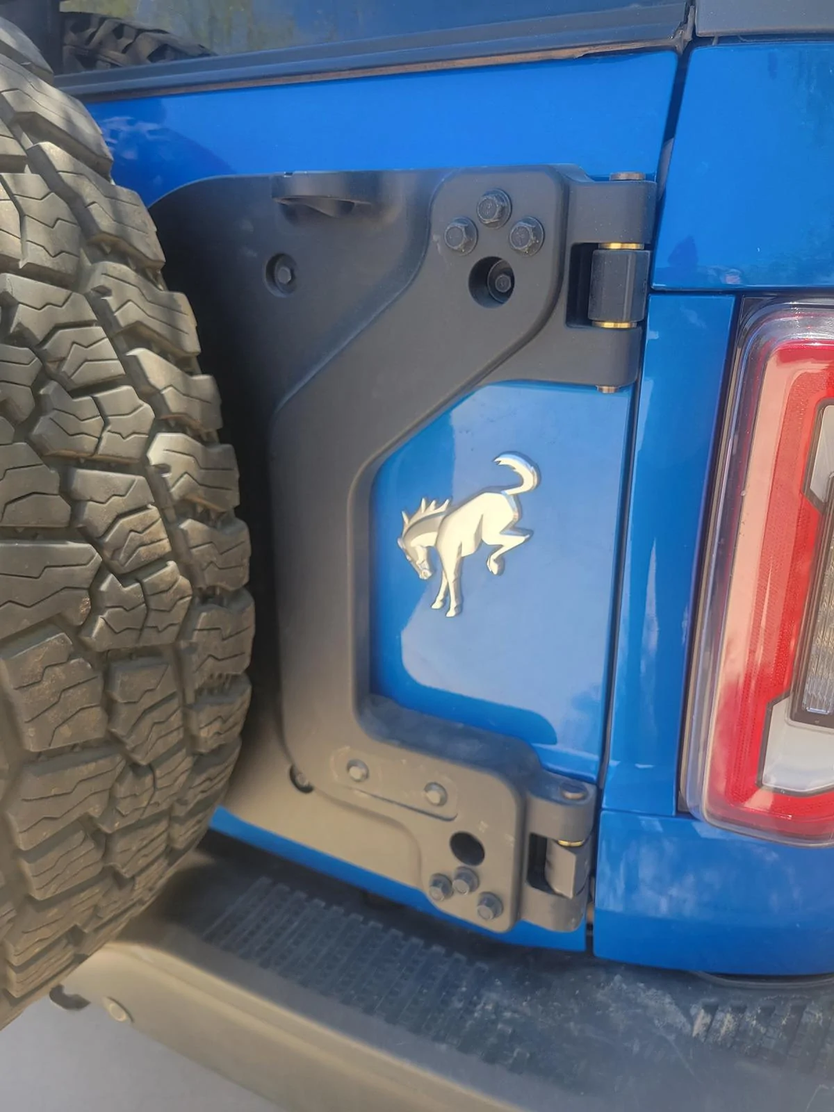

- added a Smitybuilt tailgate reinforcement with new hinges

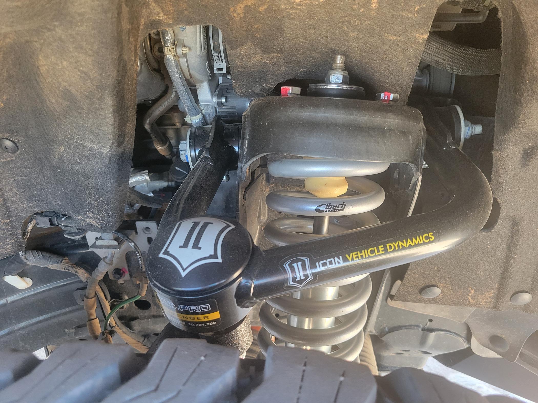

- to take the extra weight, and regain some ground clearance, I dumped the stock Bilstein SAS coilovers for Eibach Pro Truck coilovers. Also added new upper control arms and an adjustable rear trackbar to ensure good alignment and avoid any binding with high articulation off road. And dayem! It rides well on and off road. I gained about 1.5" over stock SAS with the Eibach preload rings cranked pretty far.
Shoutout to HMC Offroad in Mesa Arizona for the terrific work on this beast!

Good to hear about the improvement with Eibach coilovers.
