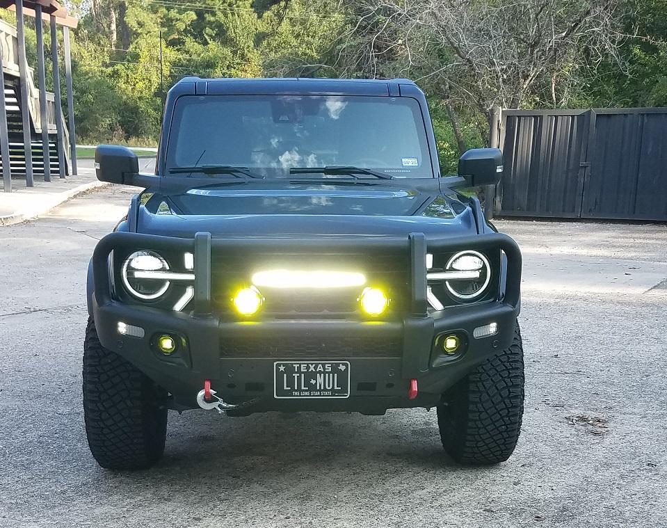

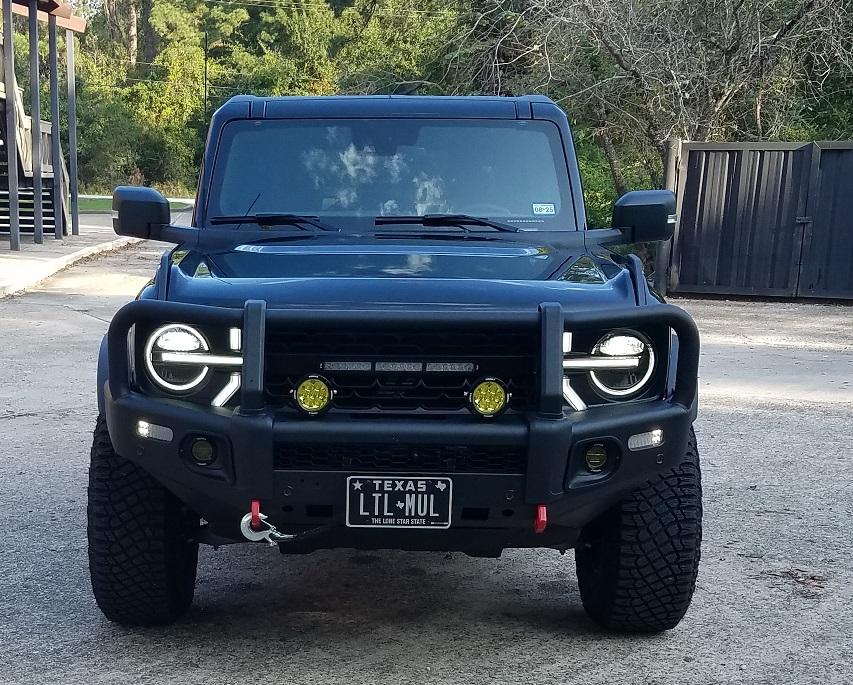

RTR grille with light bar installed. If you have Mishimoto high mount intercooler you will need to trim one of the side plastic radiator baffles to clear the plug on the grille DRL's
Lets not talk about how big a PITA it was to take the bumper back off and back on to install the grille...
After few days of the weight on the front springs it did end up settling about 1/2". I will take it back up to the 4x4shop after Thankgiving and get it moved up another clip to #5 on the fronts. Should level it back out.

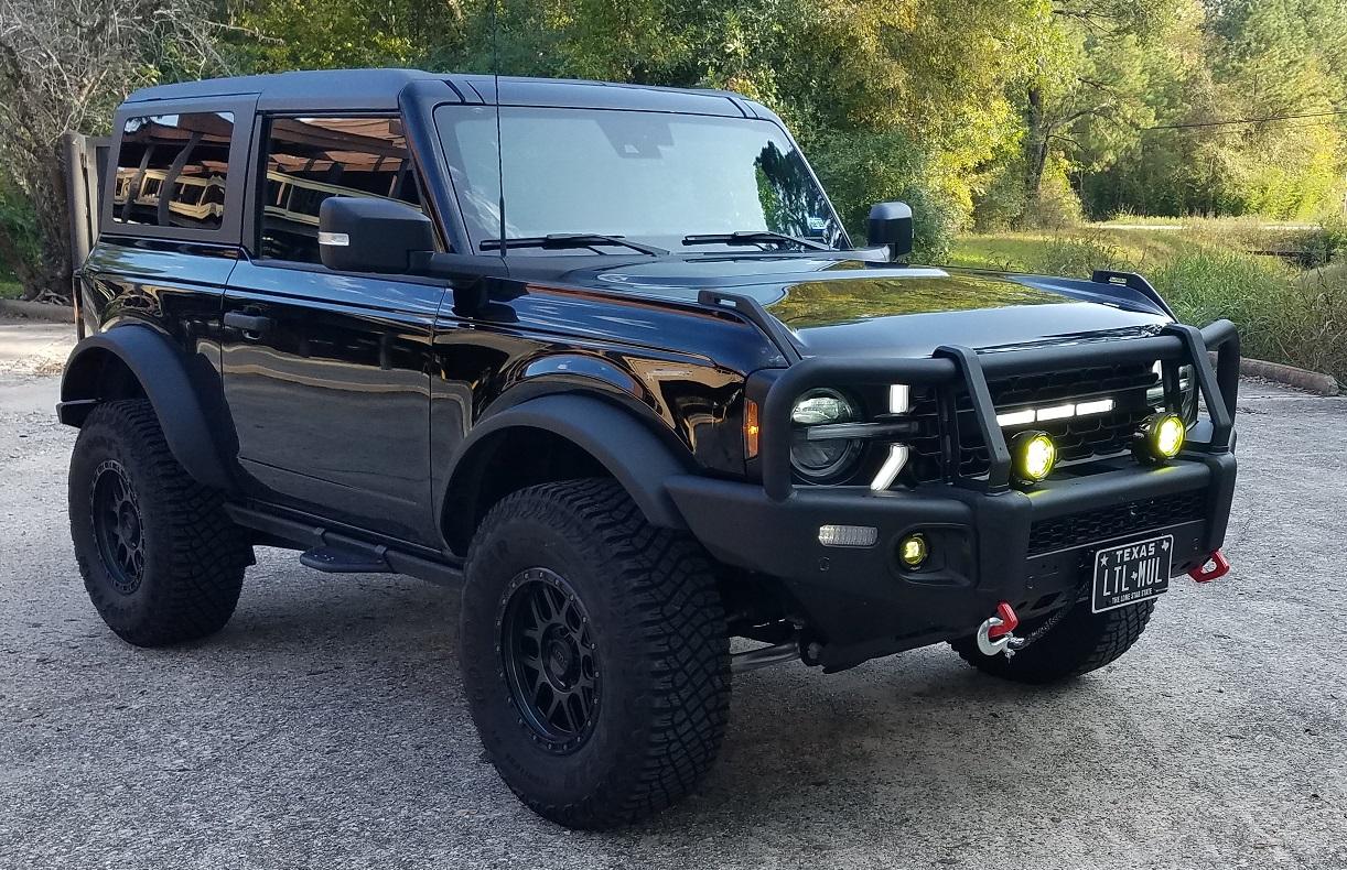

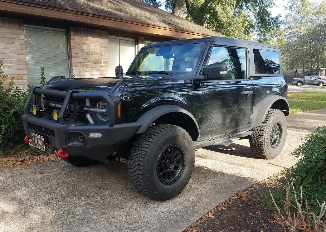

Took it back into the shop Wednesday and had them set the front shocks to max #6 perch setting. This leveled it back out mostly with the fronts now sitting at 40" to lip of the SAS flare and 40 3/4" to lip of the SAS flare on the rears. So about 3/4" rake. Looks nice and level at a glance and apx. 1.5" higher than stock SAS ride height with the 220+lbs weight of the ARB bumper and winch hanging on the front. The rear shocks are still at clip #1, so I have a lot adjustment left to add weight to the rear for camping/overlanding gear and still keep it level.
Rides and corners nice even with the extra weight. Loving the Whipple tune and other power upgrades. Sounds really nice and has nice peppy sporty feel when you mash the go pedal. With the stereo upgrade it is now everything I wished it could be and I love the aesthetics of the bumper and lights.

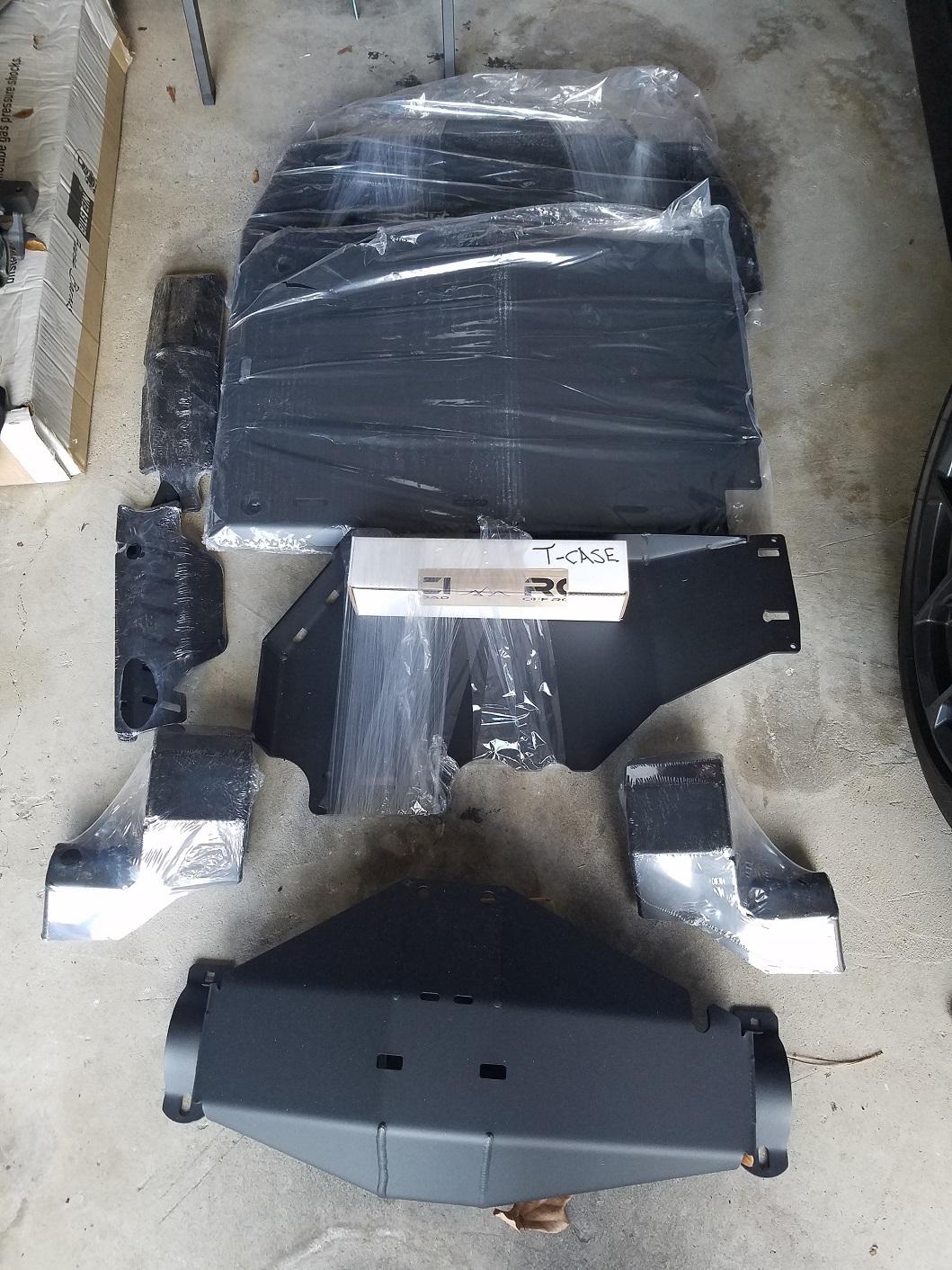

Full RCI steel skid plate set.
Engine
Transmission
Transfer case
Cross members
Catalytic converters
Shock/Lower Control arm - really like this feature of the RCI shock skid plate. they also cover the control arm
Differential
RCI gas tank skid and the RCI 5 degree frame mount sliders are next.
