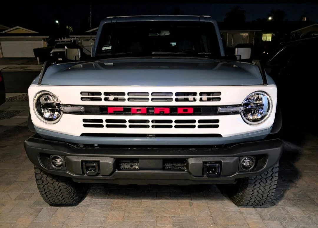

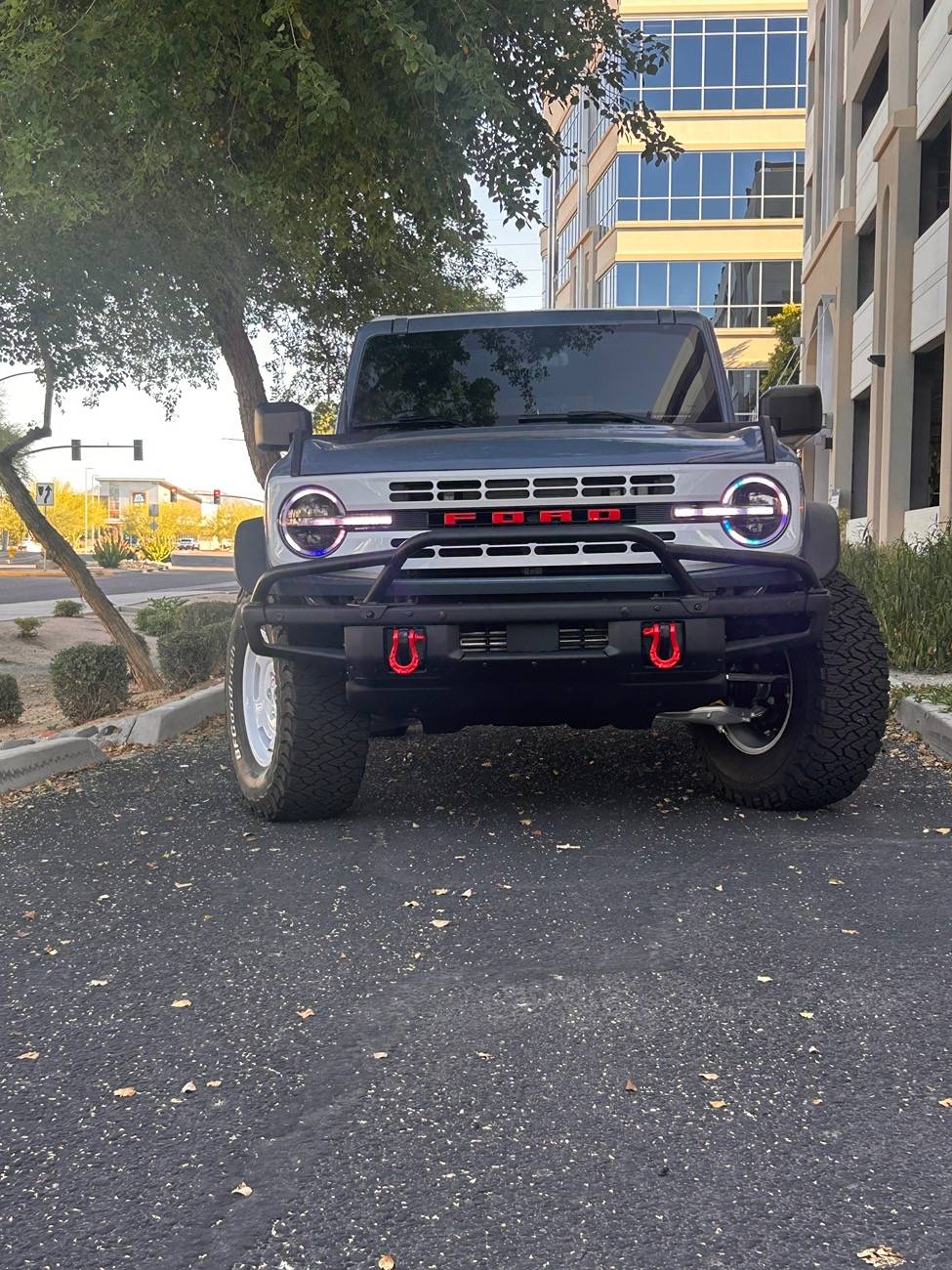

This is what my bumper looks like...
Ford Bronco My front bumper sucks, please help me upgrade it Screenshot_20250628-005430

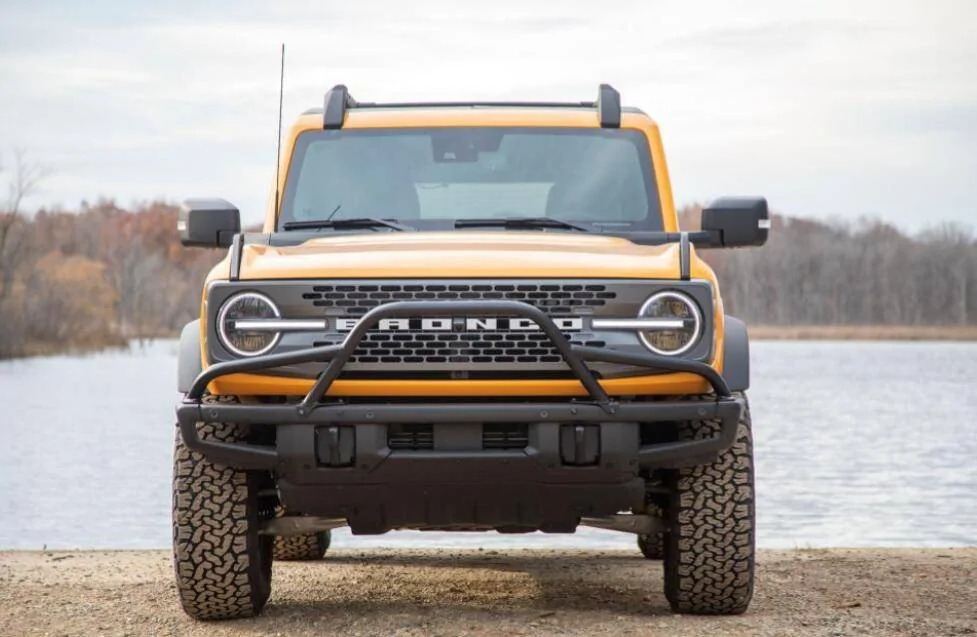

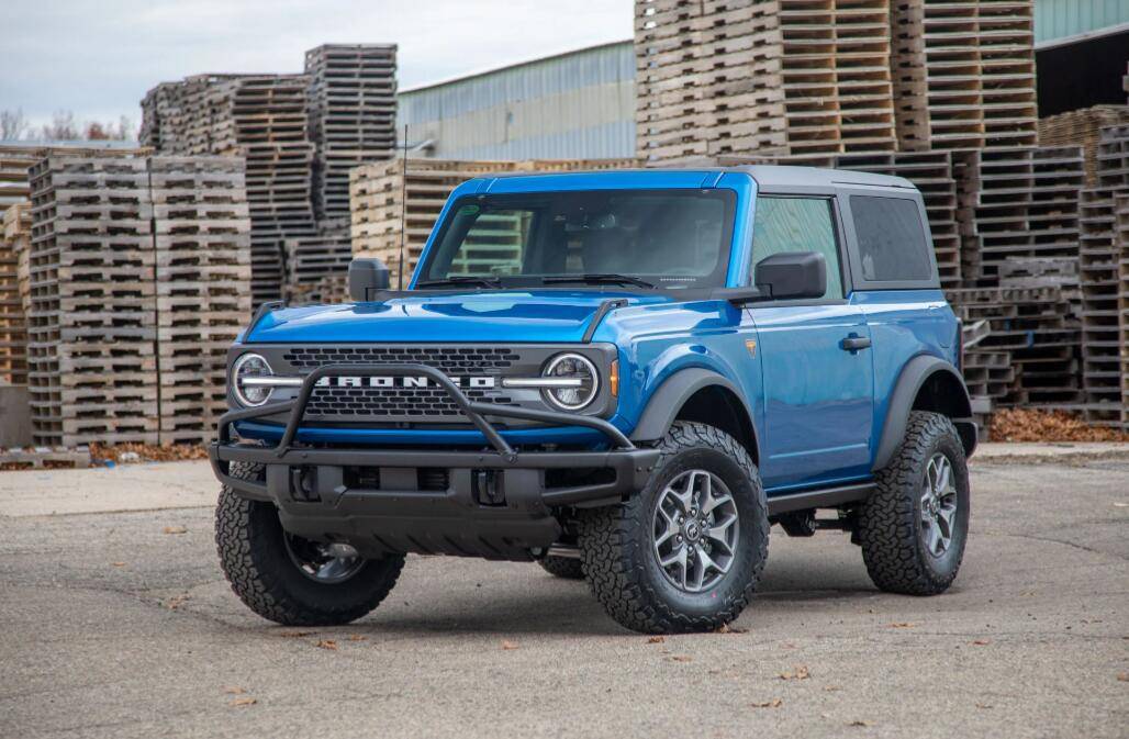

And these are a couple of images I found of bumpers that I like. Oh, and I probably won't be needing a winch.
Ford Bronco My front bumper sucks, please help me upgrade it Screenshot_20250628-003334
Ford Bronco My front bumper sucks, please help me upgrade it Screenshot_20250628-003434

Looks like you have a capable bumper. The ones you like are Ford modified bumpers with JCR Baja bars. Same as I have on mine. Others have done conversions and can walk you through the transition, I ordered mine, and got my dealer to install the JCR before delivery since it sat on my porch for 2 months in the box waiting on my Bronco. Bolts right on, but my days of turning wrenches are over. Can't get why they cheaped out on the Heritage like that...

The three Bronco bumpers are standard, capable, and modular.
Standard is plastic.
Yours is one of the two upgraded bumpers: capable. It’s powder-coated steel and has foglights standard. It strikes a balance between street and trail.
The mod is the other upgrade option and the most trail-oriented. You lose the standard fog lights but gain modularity (removable end caps), recovery options, accessory mount points and some clearance. This article breaks it down:
https://iagoffroad.com/blog/bronco-bumper-breakdown-standard-capable-modular/

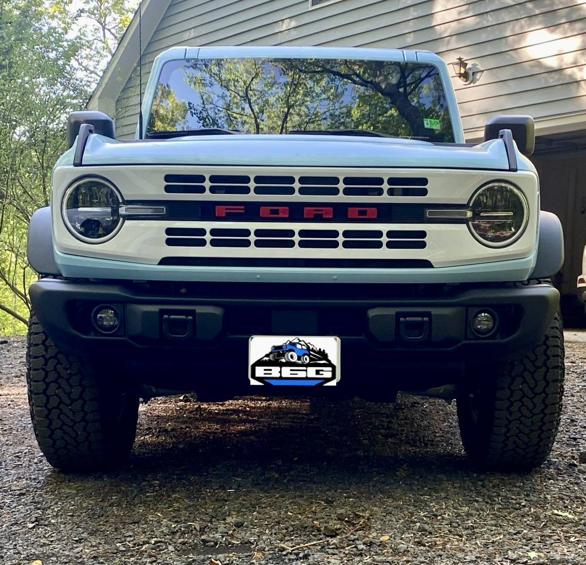

From what I’ve seen that works with all factory equipment and still looks good is the modular bumper. Which I got on my HE and it’s amazing. I paired it with turn off roads pre runner bar. Here’s a photo of mine so you can see what yours would look somewhat like.
