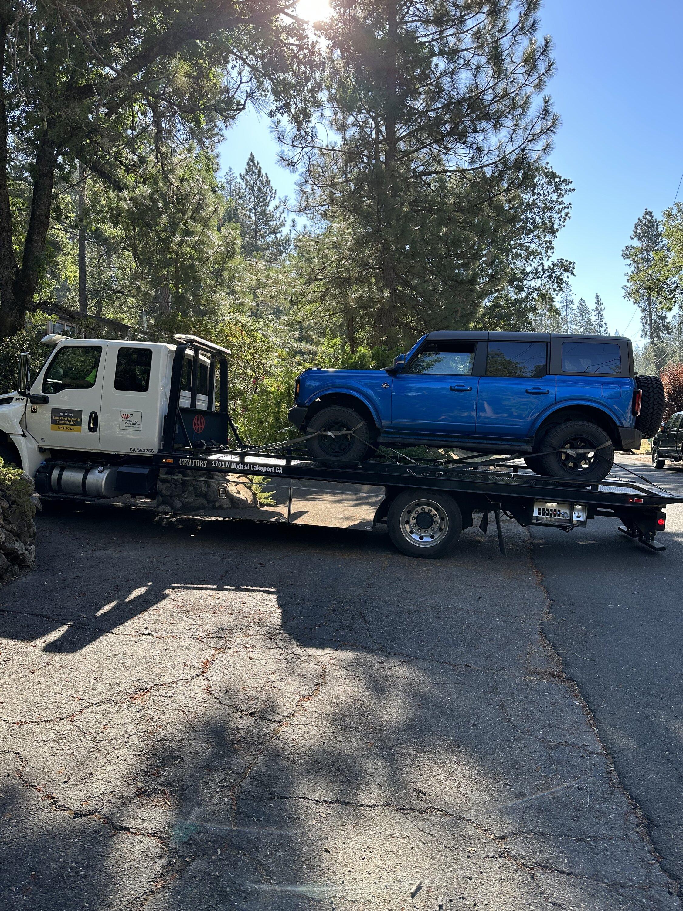

While driving about 25mph with temps at 95 degrees, Bronco lost power and stopped running. The check engine light came on. All electrical systems okay and though motor turn’s over, will not start, acting like fuel is not being delivered. Is there a fuel pump safety turn off switch and if so where is it. Thxs
AAA PIGGY BACK TO LOCAL DEALER

Ronco was repaired under warranty (fuel pump and relay) and runs like a champ…thanks Redwood Ford

Same thing happen to my 21’ Wikdtrak.. Fuel pump and relay gave out on me in the middle of a trail with about 8K miles. Ford reached out to me on this forum and they offered me free extended warranty. I have called and called them back and Never got my extended warranty.
