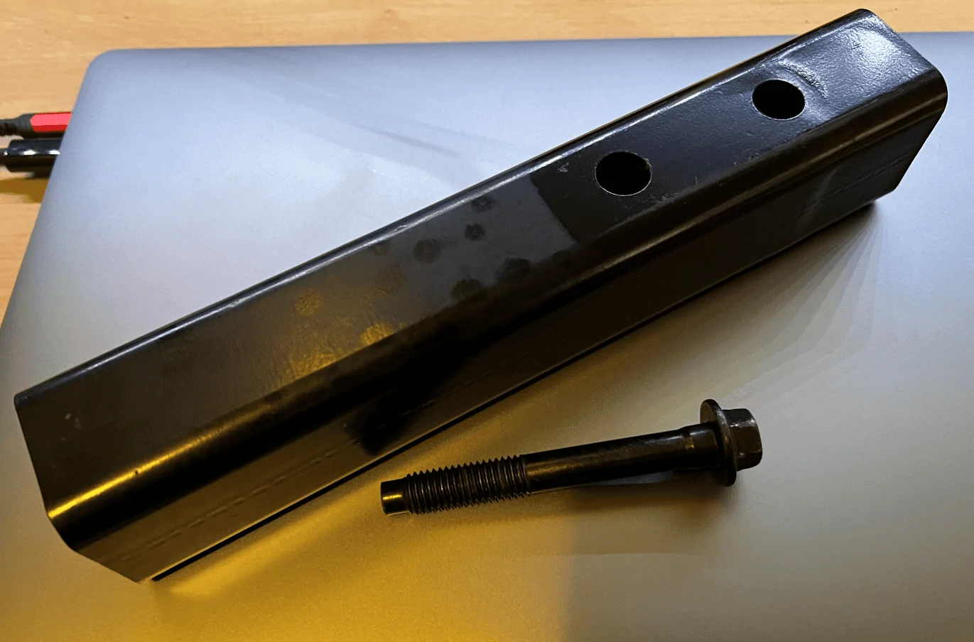

Behold! The rear crash bar from the front wheel well of a 21 badlands 2 door, and one of it's bolts.
Ford Bronco Mudflaps install hack (without removing crash bar) 1655225079577
Just for reference

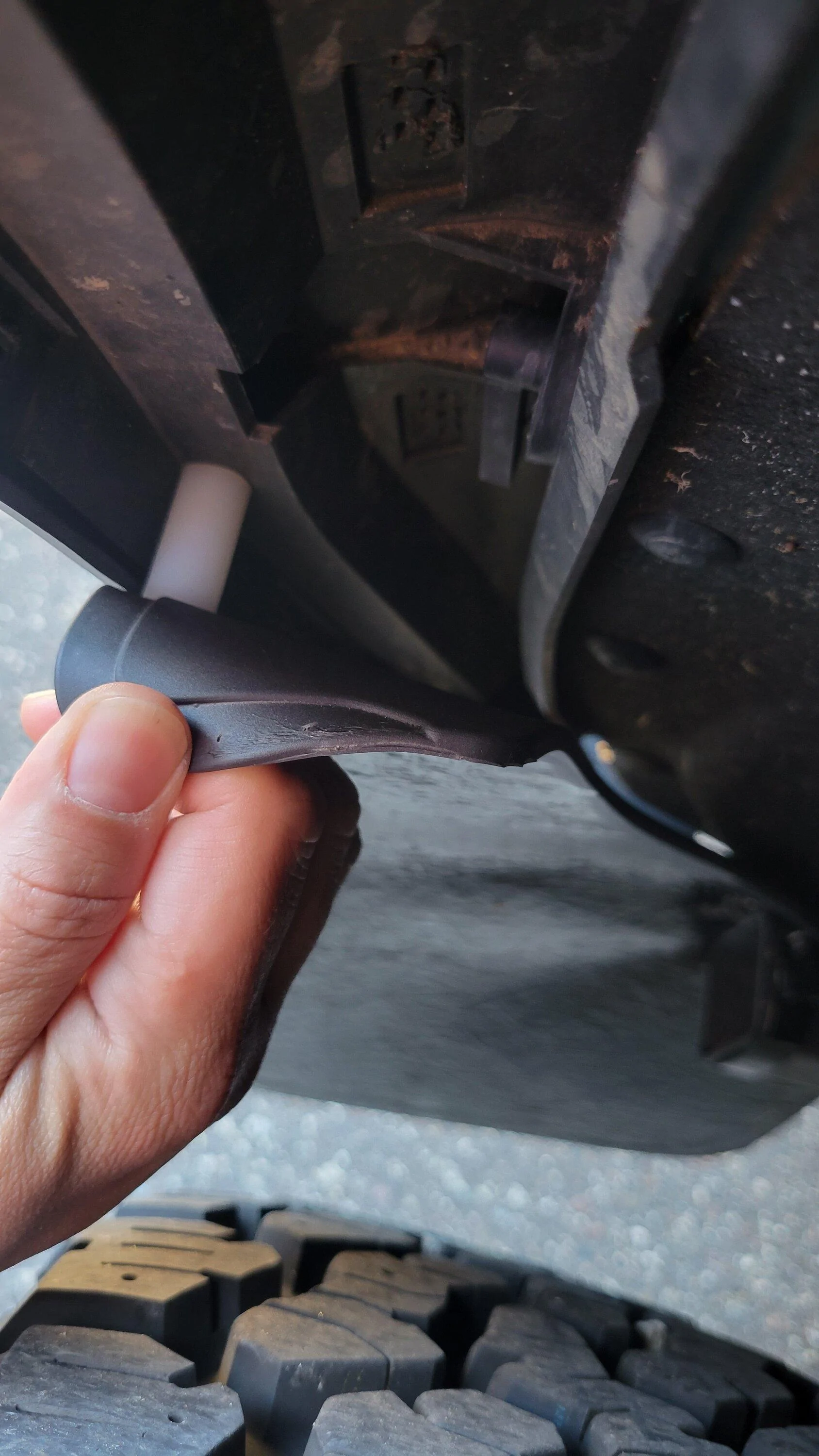

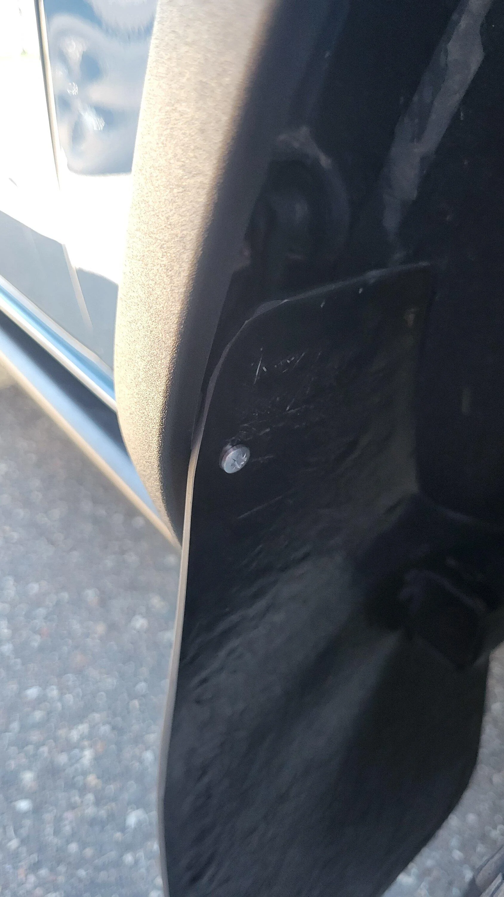

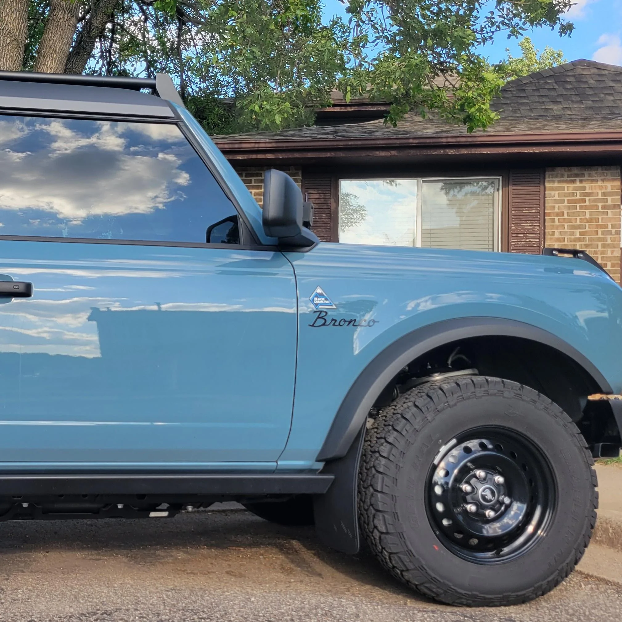

I cleaned the tar off the side of my Bronco and I did this today with the same flaps, black hose clamps, and a screw with a spacer up top. Works great!
If i were to do it over again I would use the 9" flaps from Plasticolor, i think the 11" flaps are too long for non sas but i just slid them up a little higher and they fit fine

Please post picture of the screw/spacer and the cut outs on the flap. I'm going to make these before I pickup my Bronco. I'm going to install them before I drive off the lot hopefully next month.

I bought those same clamps, second to largest one worked perfect, just need to trim off a couple inches after you tighten it.
Screw I used was probably 1.5" with a 1" spacer behind the flap.
