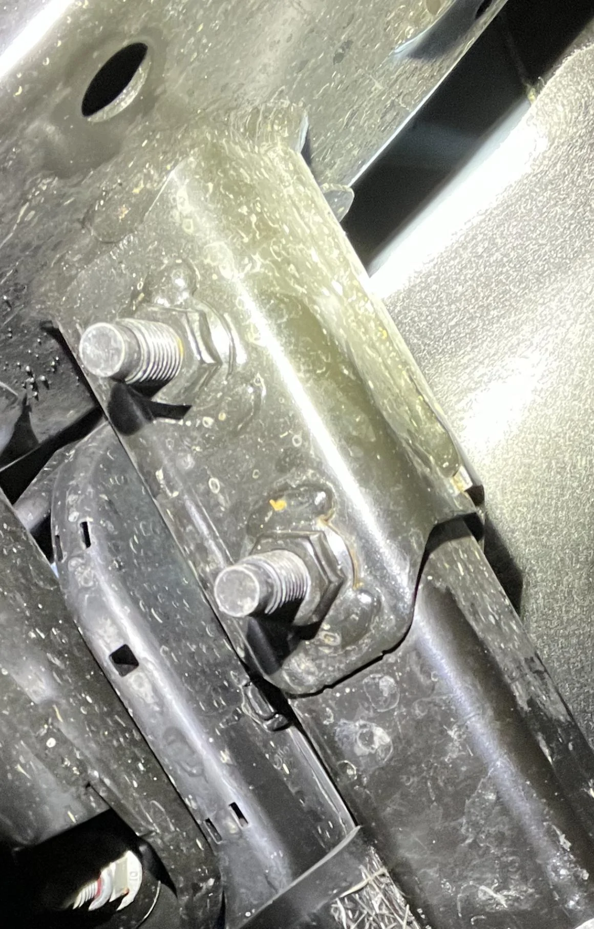

@Markco can you post a picture of where they are welded on?

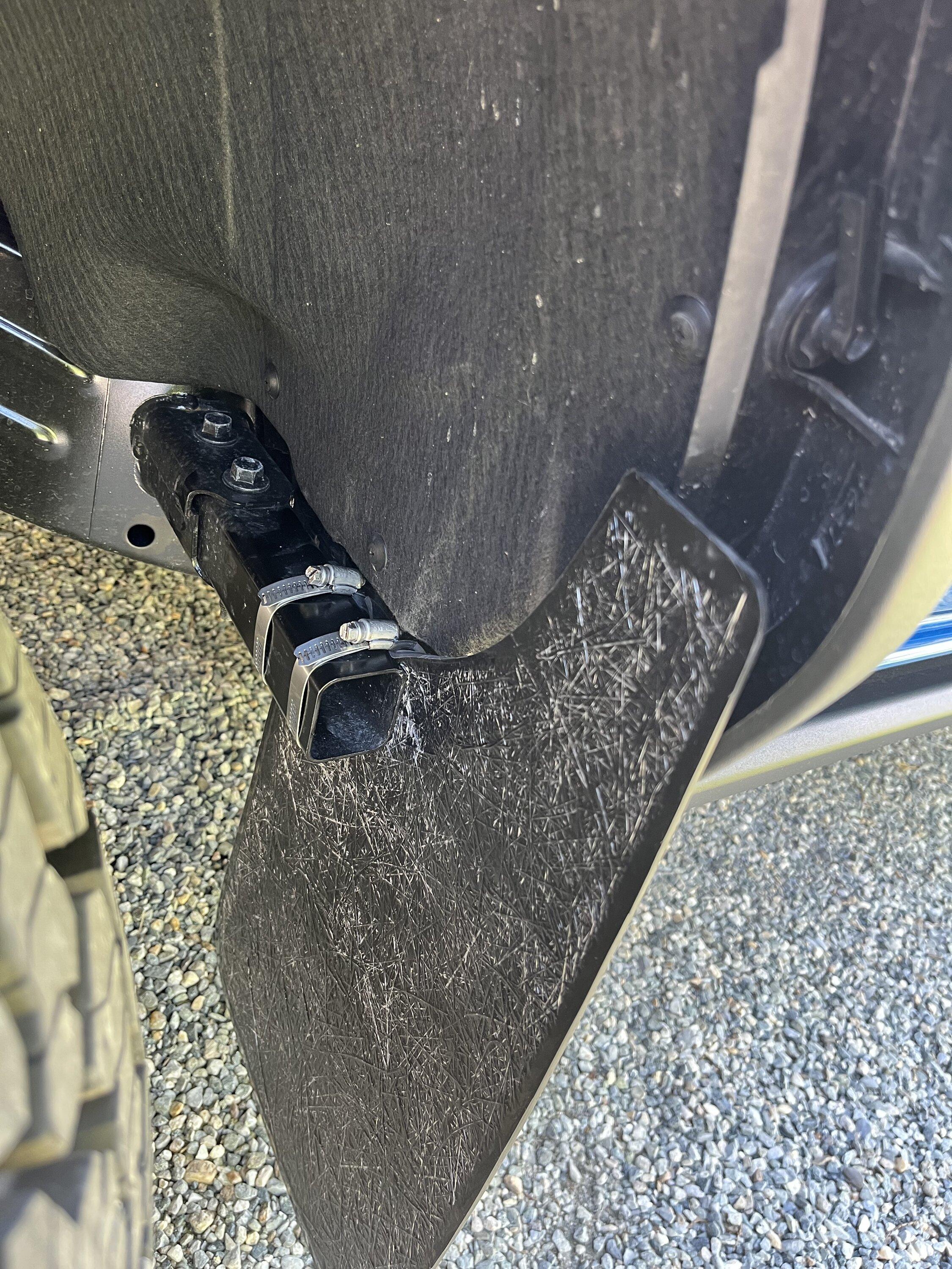

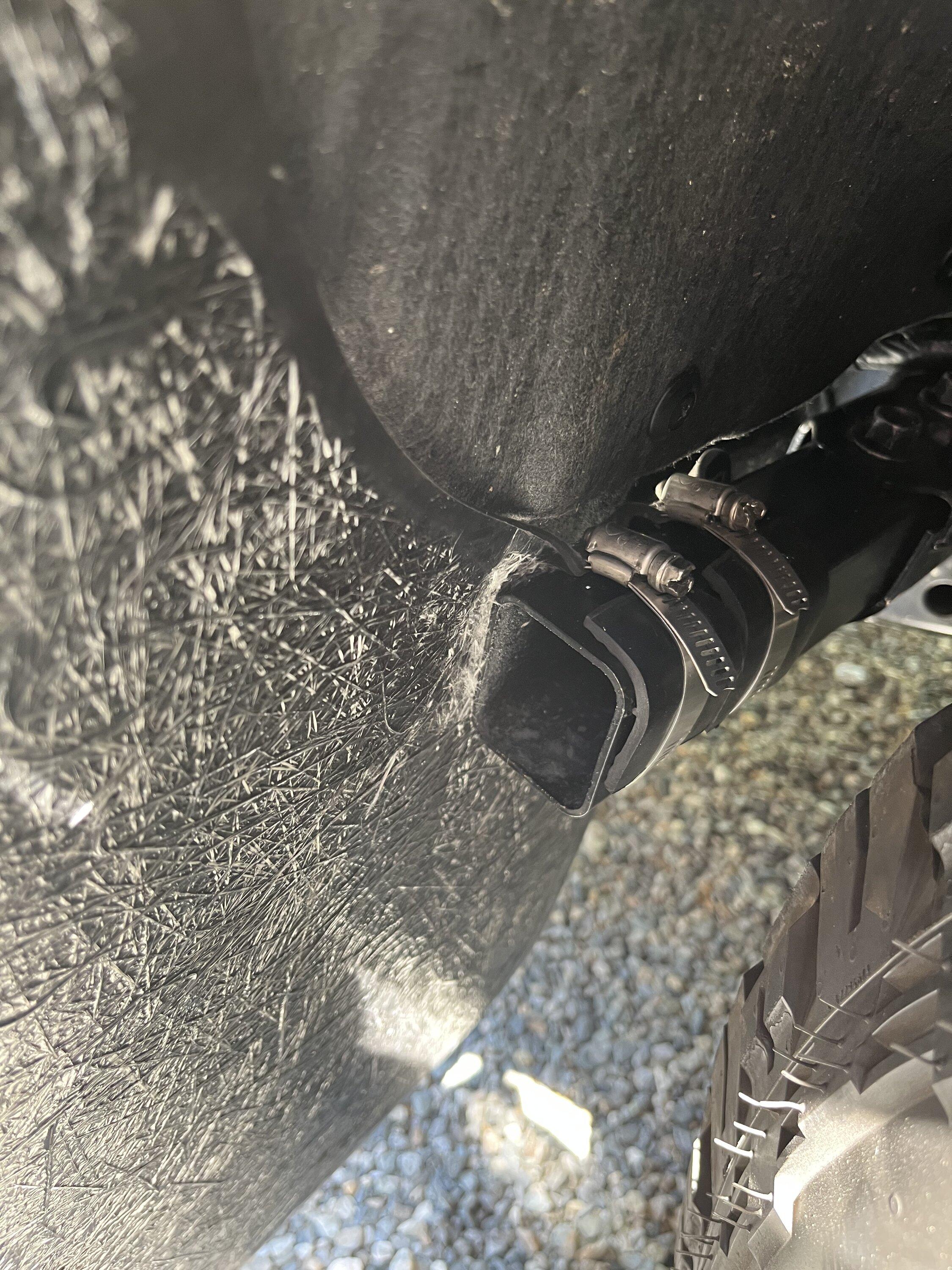

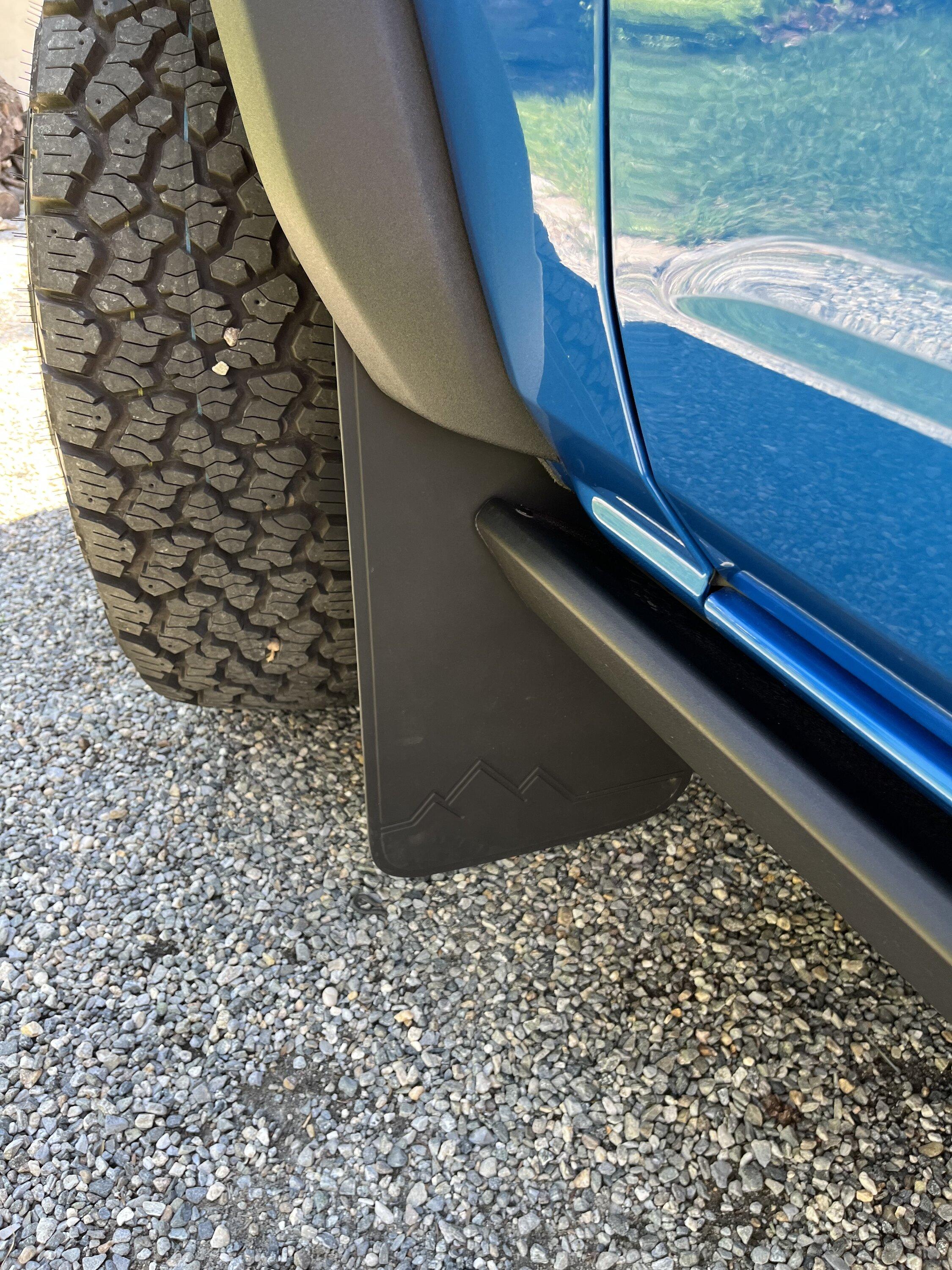

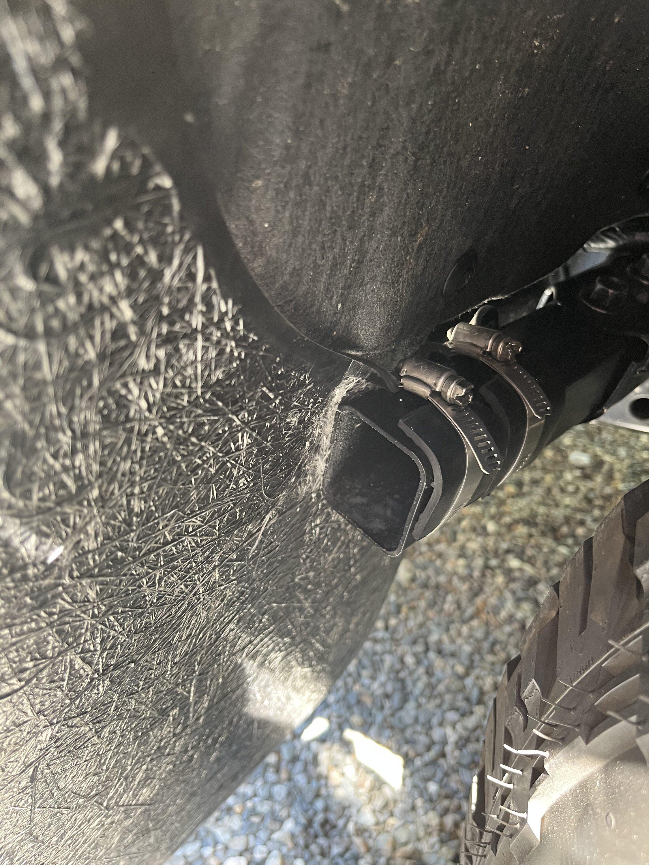

Hello,
I purchased these to install like i saw on Budget Bronco on YouTube but couldn’t install due to the fact that my crashbars are bolted and welded on. Too difficult to drill.
so i came up with an easier mod. Simply get 2 stainless pipe/hose straps for each side. Melt or cut 2 slits in the flap (use the strap as a stencil for the slit size). . Snake the ends of the straps through the slits. Then wrap them around the crash bars and tighten. It took about 10 minutes on each side. Thats it, no drilling or any other work. ThePlasticolor flaps only cost about $33, cheaper if you buy the ones with the Ford oval. The straps are about $1.50 each at HD. Buy four straps

how did u get the straps not to BOW?
can you post a pic on how the straps are attached to the mud flap?
There is a tack weld at the base of the nuts. I tried with an impact wrench before i noticed the welds. I have never heard of others being welded.
Hold the edge of the flap in place against the top of the crash bars, making sure they are level. Mark the flap at the bottom of the bar with a pensil or sharpie. Then make 2 holes for the straps .

I could be wrong, and unless I just don't see the welds, I think you might be a bit mistaken. When you remove the two bolts, the crash bar should slide out. Sure the crash bar mount is welded to the frame but the crash bars themselves insert and are secured with the bolts.
Or are you saying your crash bars were inserted when they welded the frame and are thus welded to the frame and bolted?
Having the 2 bolts it would be my guess they are designed to be replaced. Can't see any other reason for the bolts.
Either way it's a good mount. If you put the worm screw on the bottom it would look a little cleaner as you wouldn't see the worm head.
Someone mentioned that the nuts are welded. The bolts can still be losened to remove. I like the idea of putting the screw on the bottom.

Yup. The nuts are welded. The bolts come out the top then the crash bar slides out from inside the larger tube on the vehicle.
