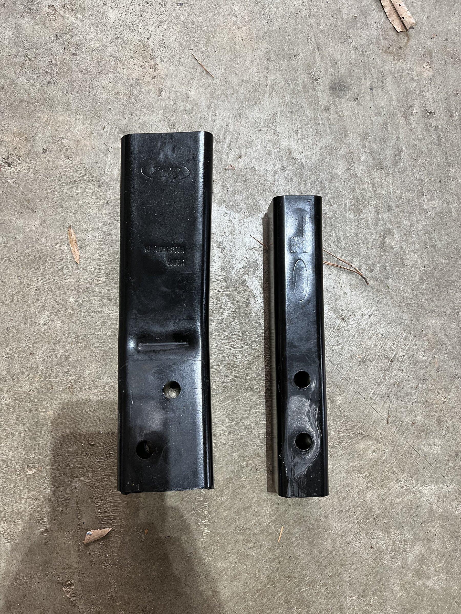

Correct. I figured because the SAS doesn’t have it that I’m fine removing mine until a suitable replacement exists. 93% of the time I’m the only occupant in my Bronco. I don’t know of SAS vs non-SAS crash ratings either.
Oh and the rear crash bars are 1.4lbs each and the fronts are 2.9lbs each so call it 1.5 and 3 for scale error. Attached is a pic of them. Front bar is the larger, angled bar. Front bar is 11 and 5/16ths inches for reference
Thanks for sharing man that was super helpful and will make me feel a lot more comfortable removing them
