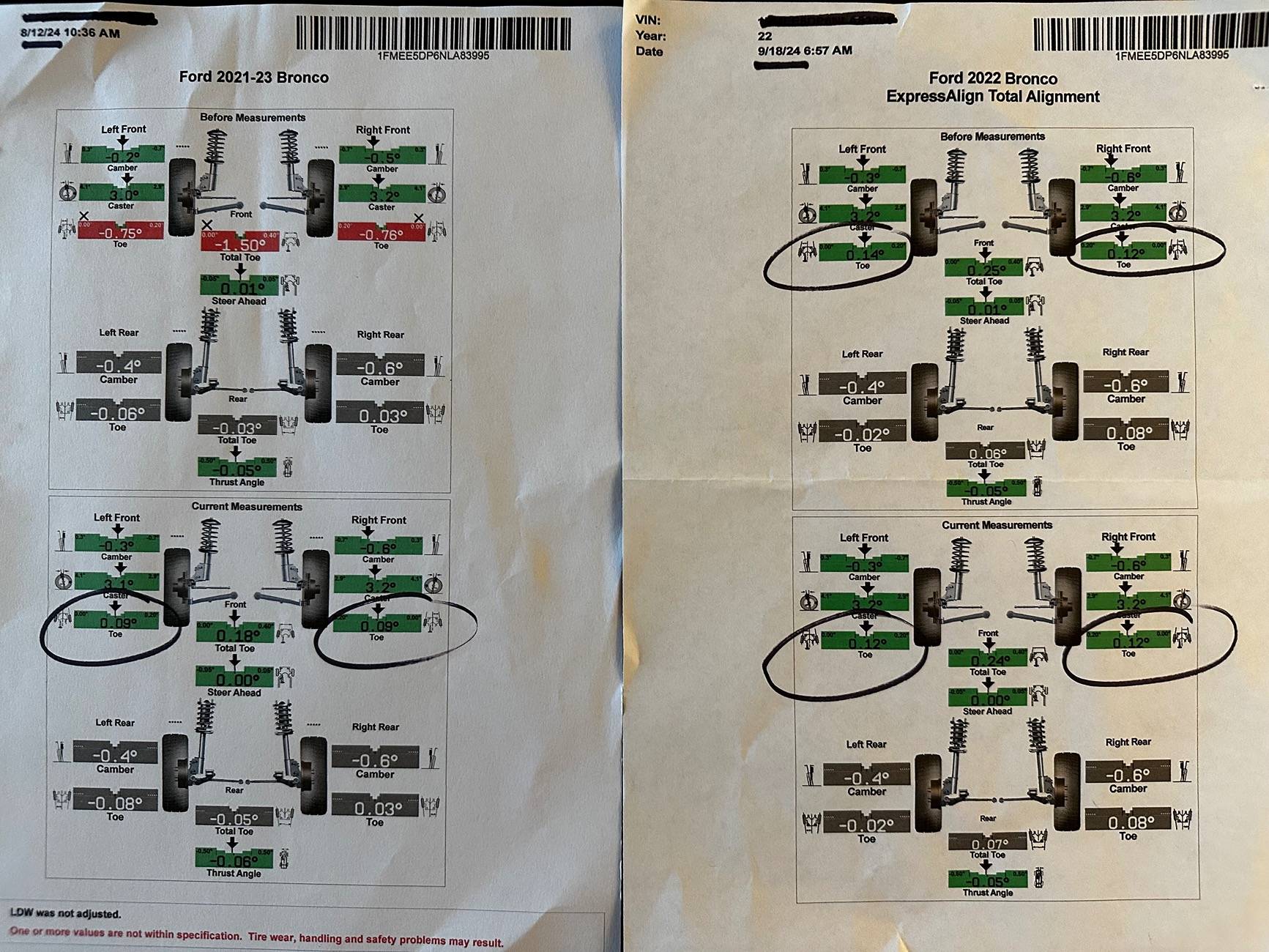

Got another alignment done and it immediately corrected on the way home. Doesn’t seem like much, but you can clearly see I was dragging a tire after the first alignment (left) post tie rod install.
Very glad it wasn’t something mechanical!

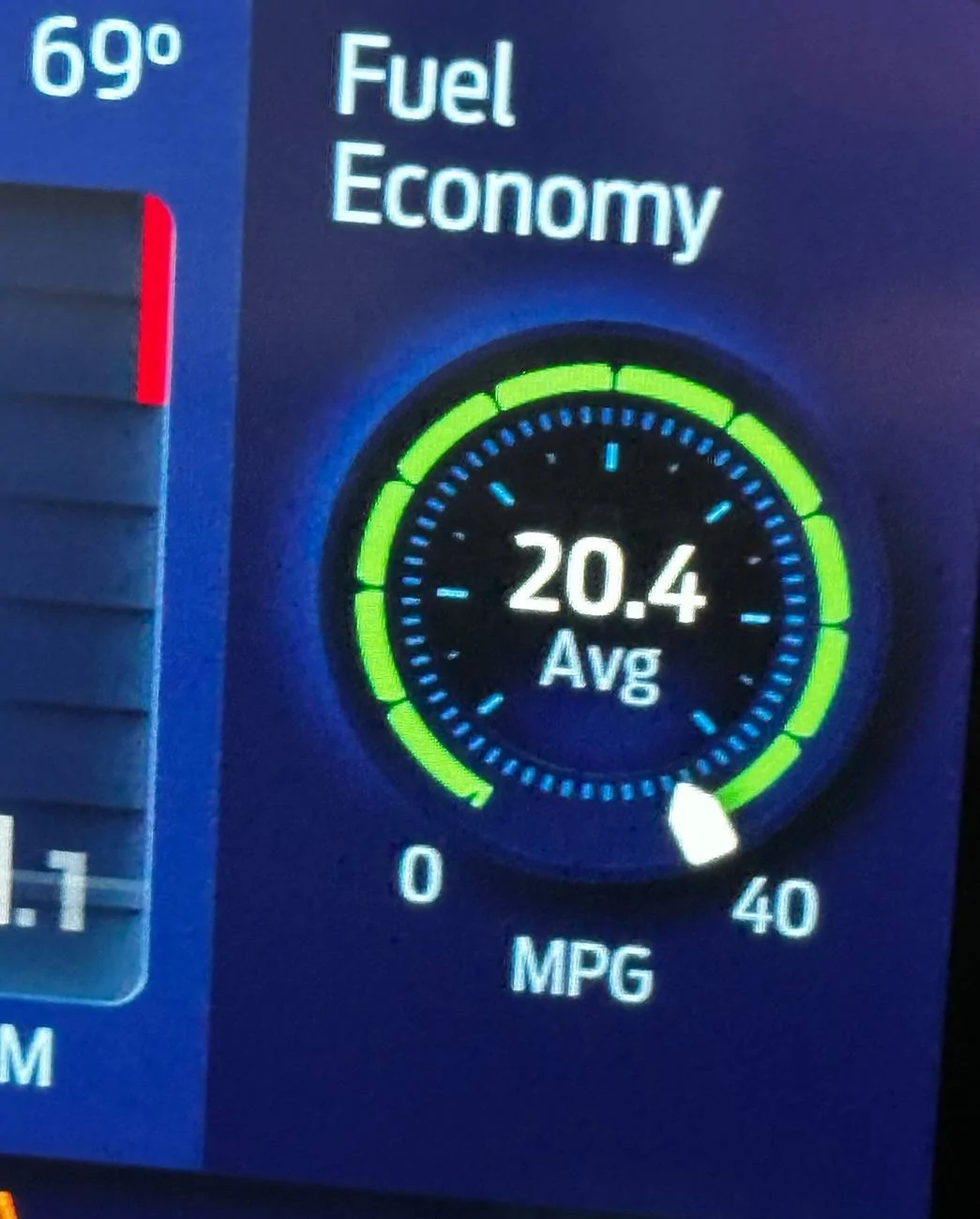

Update: Highway mpg is staying around 17-18 even in sport mode, so that’s good. But city, especially heavy traffic, is like 7-14 depending on situation. I’m guessing my non-was FDU is the culprit. It’s probably taking more power to get me rolling and then when I get going consistently it’s fine. Idk lol
