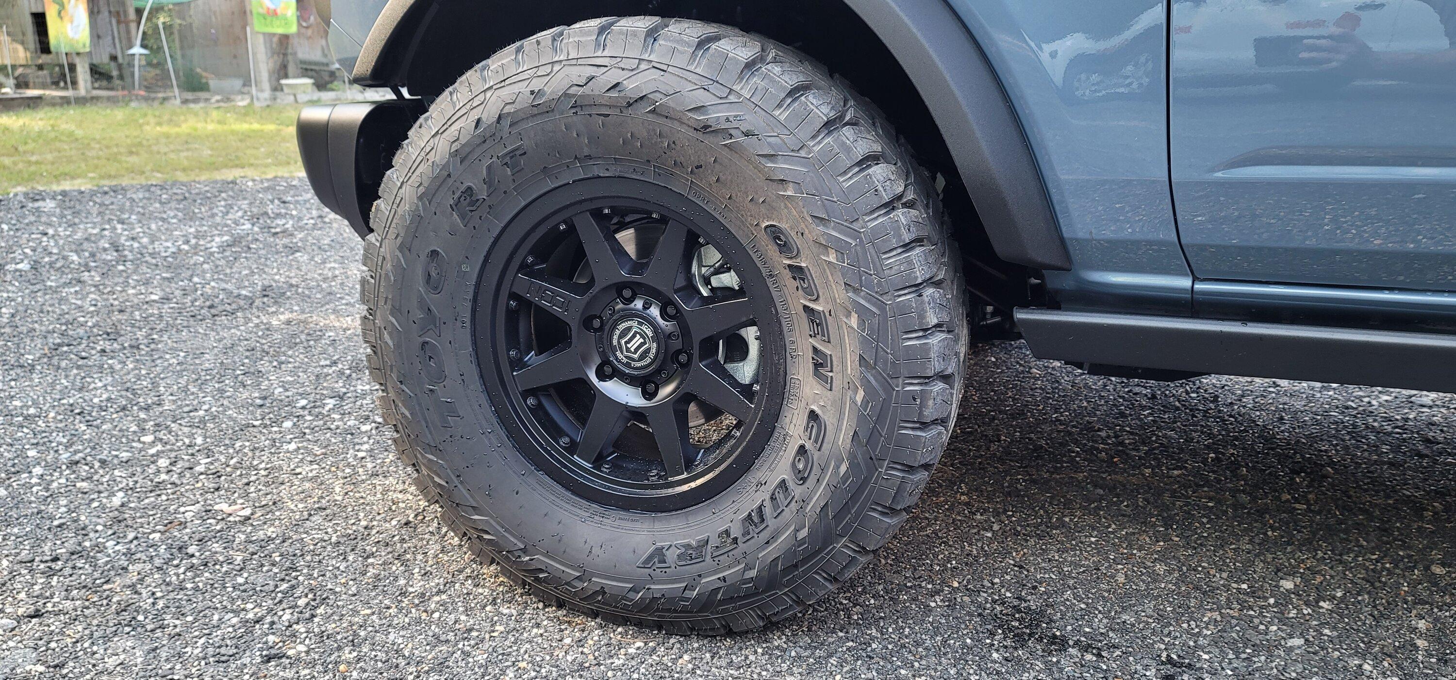

Finally got the Badlands Bronco and installed the wheels today.
Ford Bronco Mounting Icon Rebound Pro wheels 20230511_173339
Ford Bronco Mounting Icon Rebound Pro wheels 20230511_173220

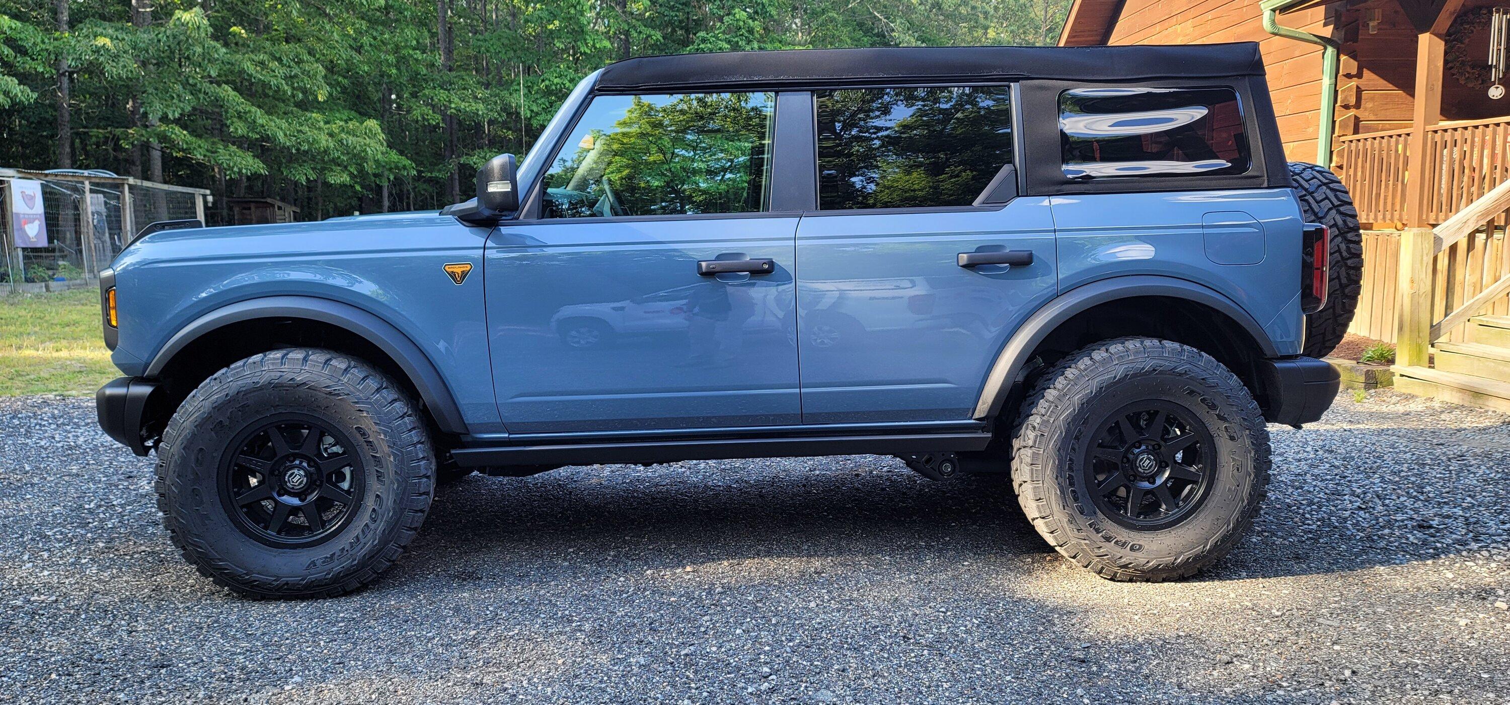

I have the 0mm offset Rebound Pros on my personal Bronco with about 30,000 miles on them. They are mounted lug-centric, without rings. So far so good :)
Ford Bronco Mounting Icon Rebound Pro wheels chanel
Beautiful rig! Looks like an off-road beast. So no vibrations or anything at highway speeds? Any reason you wanted to go lug centric? Or just a convenience thing of not having to worry about hub rings?
Dusty at ICON
Squatch Sponsor (Level 3)
Dusty
Oct 4, 2021
404
1,329
Riverside, CA
2021 Bronco Base 2-Door
I never thought twice about it. The Rebound Pro (like most aftermarket wheels) uses conical lug nut seats so they function as lug-centric anyhow. Someone here will fight me on this I'm sure (this is the Internet, after all), but I saw no benefit to running hub rings with these wheels. If there are any extra vibrations due to it, I can't tell.
